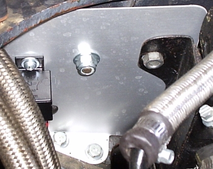

horn well template
This is what I came up with after looking at Steve Laifman's tech tip. The 2 horn base screws and the radiator mounting bolts were used with the plate positioned between the rad mount lug and the frame. I added additional holes to mount and wire a small air horn, on the outside face, and its relay on the inside face for easy wiring access.
I used a clearcoat annodized notebook cover and cut it with tin snips. On the finished piece make a slot with a file along the fold for a washer for the bolt located closest to the fold. In the installed part picture note that I cut the shape of the bottom mounting leg to conform to existing conditions but wasn't necessary. Make all holes slightly oversize for ease of alignment.
You can print and cut out the template fold the bottom mounting leg and position your own hole locations and other trim mods you prefer. NOTE: Bolt holes shown are only approximate locations.

Horn opening block off plate
Justin, thanks very much for the template. I stuck with the clear hooter horns, so I went the route of making longer horn mounting plates to pass through the blockoff plate, etc. I had not yet seen Steve's tigersunited.com article and his templates at the time, so ended up with a lot of cutting and fitting and cutting and fitting and...
I really like your idea of an air horn. I am sure it is a lot better, and safer, than the old clear hooters! What horn did you install?

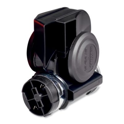

XTIGERX
501
Gene,
It is an ultra compact air horn. 4.75"H x 2.75" thick x 4.25"W
with the air pump built in but you probably already knew that.
77505_FAM
If mounting like mine be aware of the relationship to the hood hinge.
Justin
