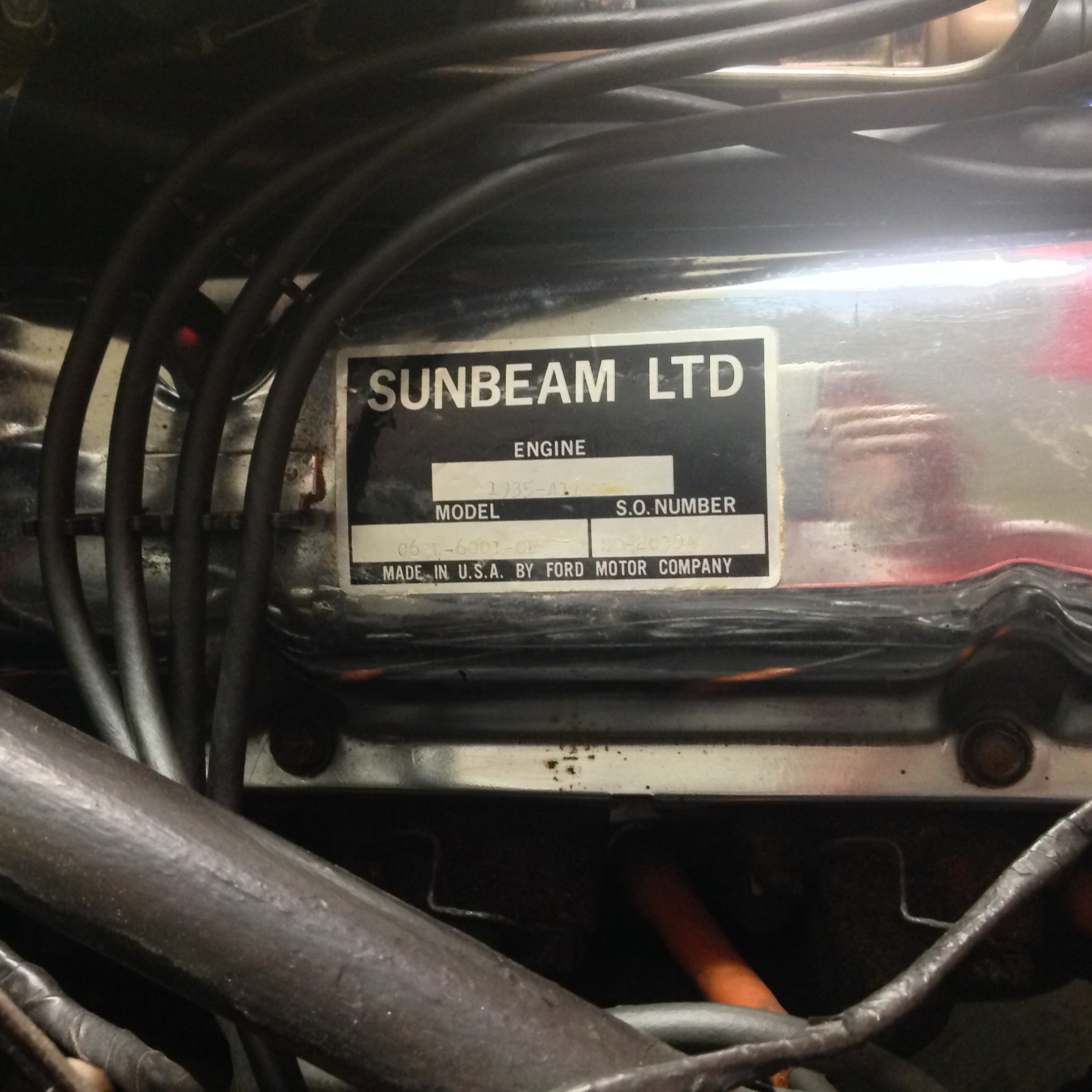

Can anybody tell me where I can find the “S.O. Number” and the “Model” of my car as these 2 designations are missing from the valve cover tag on my car. The tag has deteriorated over the years. I only have the VIN number, the JAL number and CHASSIS number.
Ty, Rich

What is the Vin of your car, need a place to start so other numbers can be found.
mr55s
333
Thanks. The number is B382100169LRXFE
The top number on this valve cover tag is your engine number, same number you find on your VIN tag.
Bottom left and bottom right seem to be the same numbers throughout Mkll production from info that I have. C6PW-6001-CF Is bottom left, and bottom right is SO-2630A

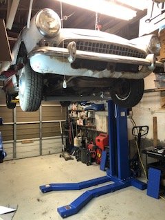

Thank you sooo much. I'll post pics as soon as I take a few new ones. Not much to see right now. Car has been off the road for 10 years, since hurricane sandy. Have the car for over 40 years. Was a runner before sandy.

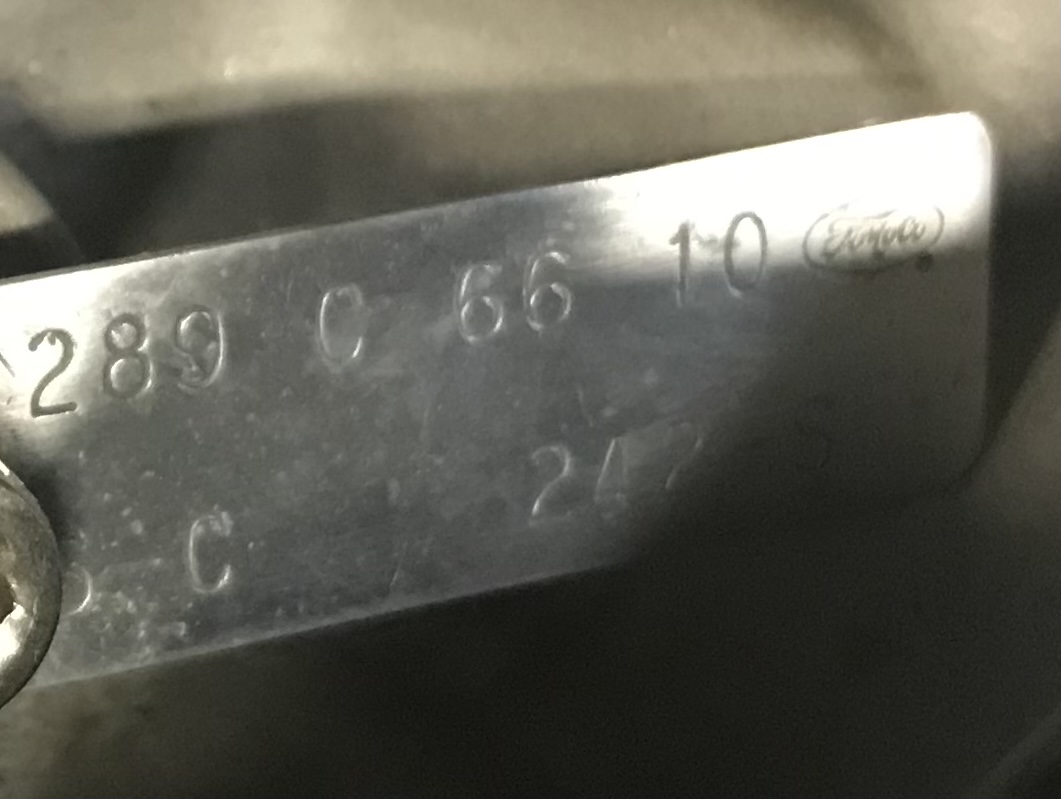

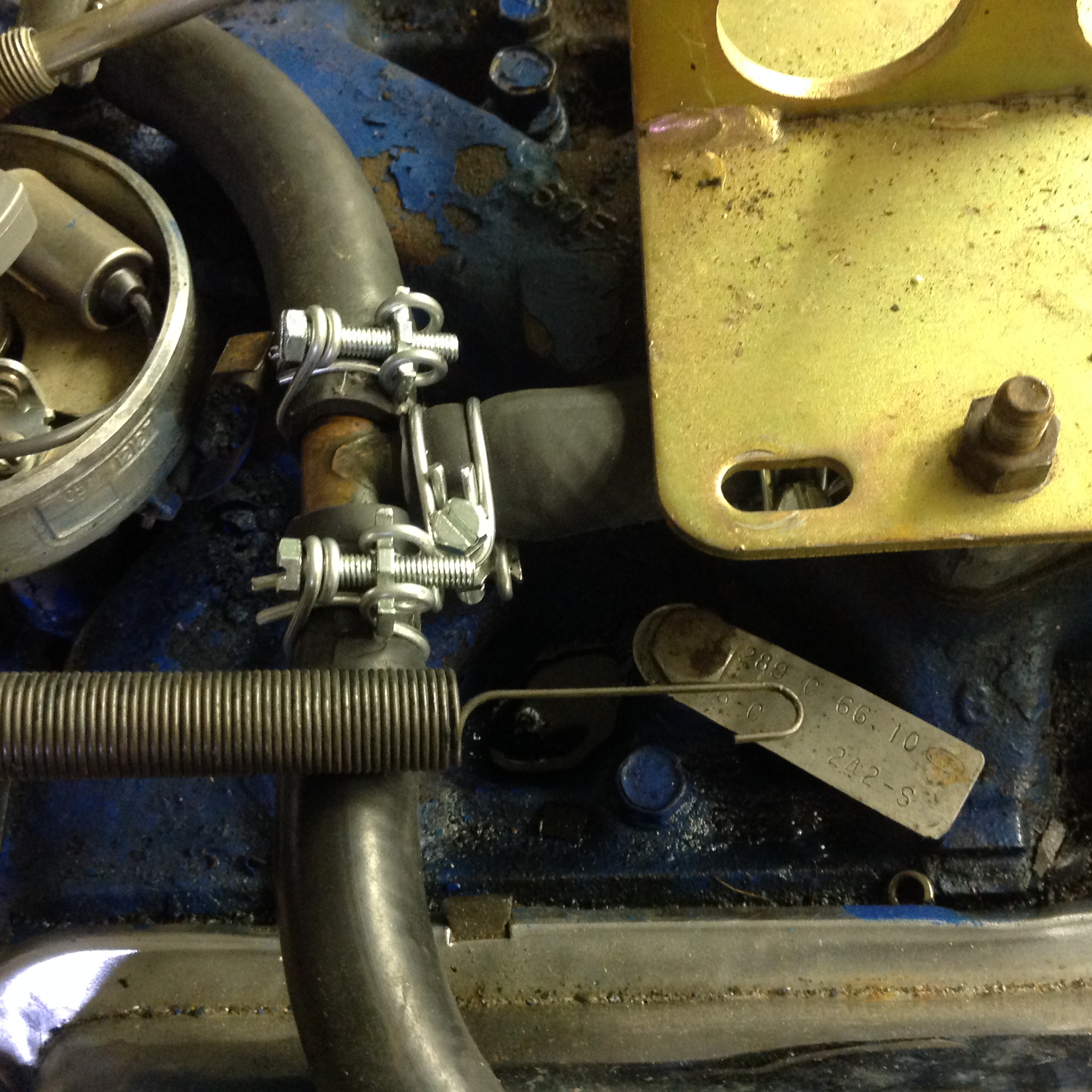

What # matches the engine tag to the valve cover tag? Mine do not seem to match that.

ABSunbeams, your Sunbeam valve cover tag is correct from what I can see in the picture. The Ford engine tag (skinny tag) should not be confused with the valve cover sticker “Sunbeam” engine number . The Ford tag gave engine displacement, model year, change level, date code and engine number. Your engine number on the VIN tag should match the engine number on the valve cover sticker, and yes the skinny aluminum tag it is a stand alone Ford engine production tag and is correct also.
148

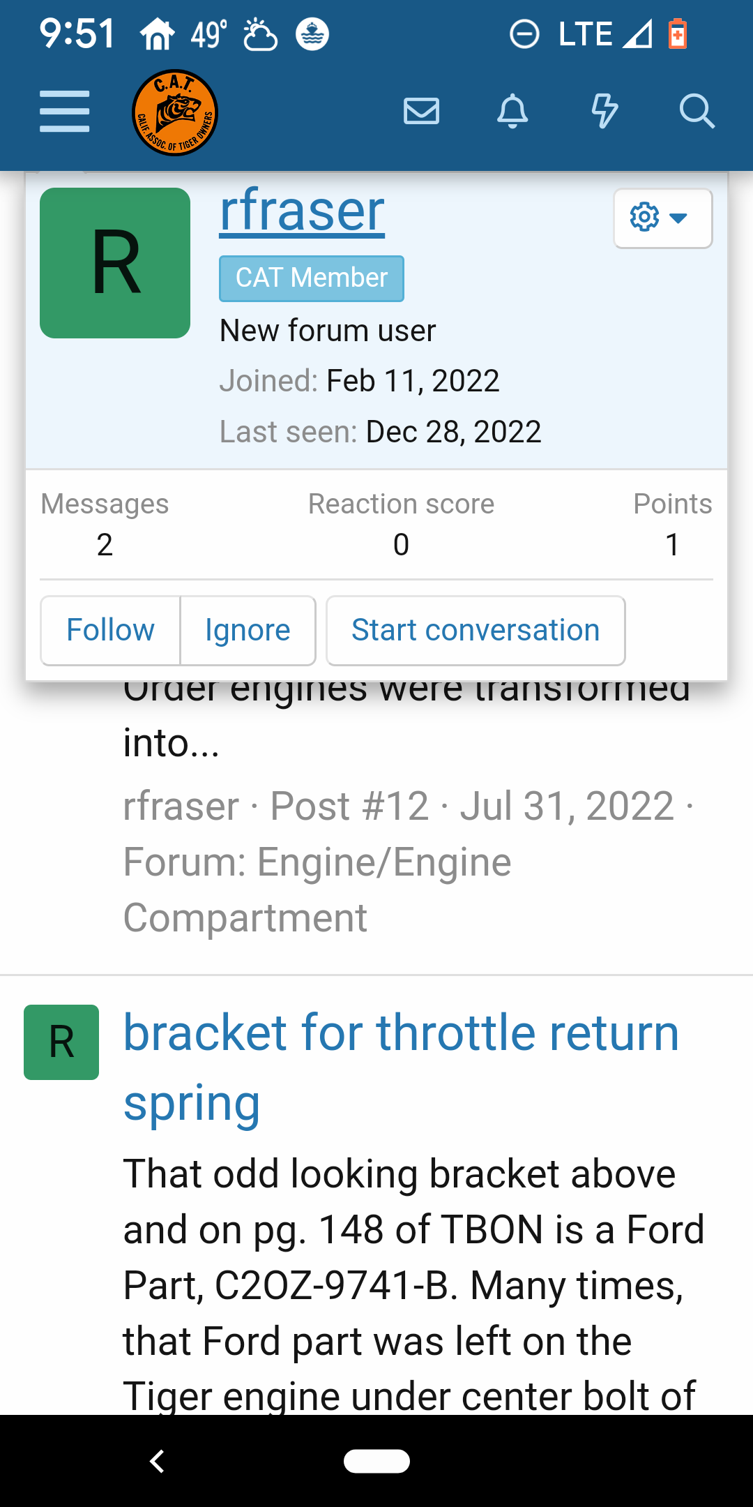

@ABSunbeams it seems like your engine still has most or all of its original build tags. Ron Fraser (on the tigers@autox.team.net mailing list) has been collecting engine build tag info for a long time and if you haven't talked to him already he would probably be grateful for the info and also help you figure out any details that can be gleaned from the tags on your car.
Ron F. is here on CAT please see screenshot below.

Wow.. Looks like it had been an original car...can see the black on the sills and the vynil decals, assume it saw a lot of water during Sandy 😥...
Good luck on getting it sorted.. Ask lots of questions .. Lots of great people on here and helpful parts hunters
