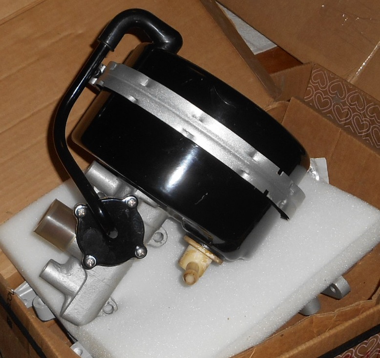

Got a sweet relined #92 (7") valve body at the ready and a couple more at the machinist. Also just finished and tested a 7" MK2B unit; a bit more reliable than the MK2A critters. Send PM, etc.
