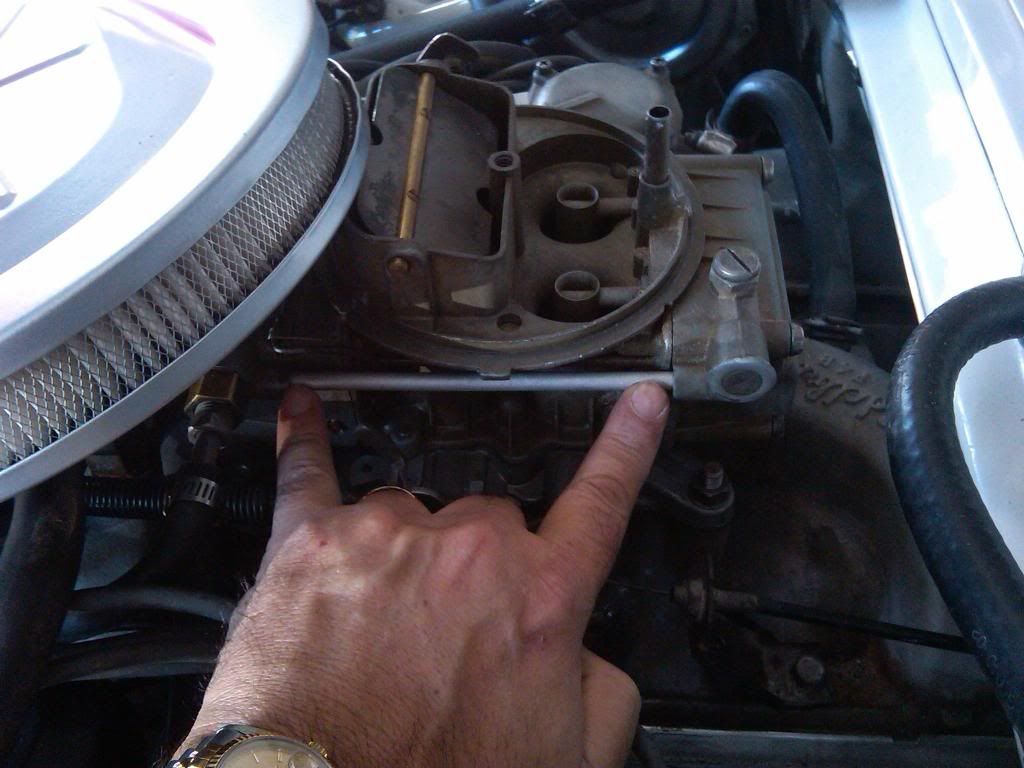

I am so close to getting the car back together after the paint shop. Finished reinstalling the soft top today (and boot cover) and bleed the brakes after reinstalling the brake lines and booster.
We just had to hear the sound of the engine as it as been nearly 2 months and the only thing left to do before we can drive it, is install the new windshield and frame (and items that attach to them - fruflex, rubber, catches, rear view mirror). So we started it right up and gas came pouring from the carb. I have attached a picture and the gas is coming from where both my thumb and pinky are pointing.
[/IMG]
I was able to slide the pipe back and fourth a bit and it seems to have stopped , but I dont trust that it wont wriggle loose again as I am driving. Is there a seal that can be replaced on both sides of the pipe? Is it a diy job or do I need to get it to a carb guy? If seals are avail, where do you get them or how do I describe it?

I think there should be 2 little donut rubber gaskets in the ends......Most hot rod type shops should carry these and it is pretty simple to install. Loosen one of the bowls, pull it back, pull the tube off and install the rubber donuts, then reinstall the bowl.

It is very possible that when you remove the bowl, the gasket there will tear and not be reusable. Presuming the carb has not been apart in a few years. If you can buy the fuel tube o rings separately, you might as well get a bowl gasket at the same time and save yourself an extra trip later. Depending on where you go, you may need to buy a renew kit to get the parts you need. Be sure you have the carb List number (stamped on the air horn) when you go to the store.

Thanks for all your help. I thought I had found the correct "O" rings on line but since there was some confusion (some carbs had more of a cylinder seal rather than an O ring), I decided to take off the secondary bowl, remove the pipe and take it to my specialist carb guy for the right parts. Once removed, I found that it had been rebuilt as there was a nice blue gasket on the bowl (which I was able to save). I found that there were 2 o rings on each side and 1 had worked its way off (or never put on correctly) and found in the hole. They didn't look damaged, so I re-installed and it all seems tight - not able to wriggle the pipe as before. Tested it out and no leaks...not bad for 10 minuts work ;)
