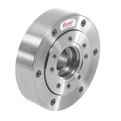

So, where do I get this tool.
Using this balancer (28oz external) - http://www.summitracing.com/parts/SUM-C4269/
Used high temp bearing grease on the shaft and the seal during assembly.

That balancer should work !!! Another thought comes to mind.....are there
a couple of studs on the block that locate the cover ??? Is it possible that the front cover is not centered on the crank, where the mains line bored for
some reason ???
Bill

I bet that AutoZone has something like that for a loaner.
Don't know about the mains. I can't remember if those locating dowels were still in the block, I think I pulled them as they would not work with the 289 cover. I made sure the seal was centered on the crank before tightening any bolts on the cover.
My error is probably pressing the seal into the cover. I did not use a socket but the end of a 1/4 drive extension and worked it in. I may just be damaged or cocked. I thought I had driven it flush with the cover but may not have.
