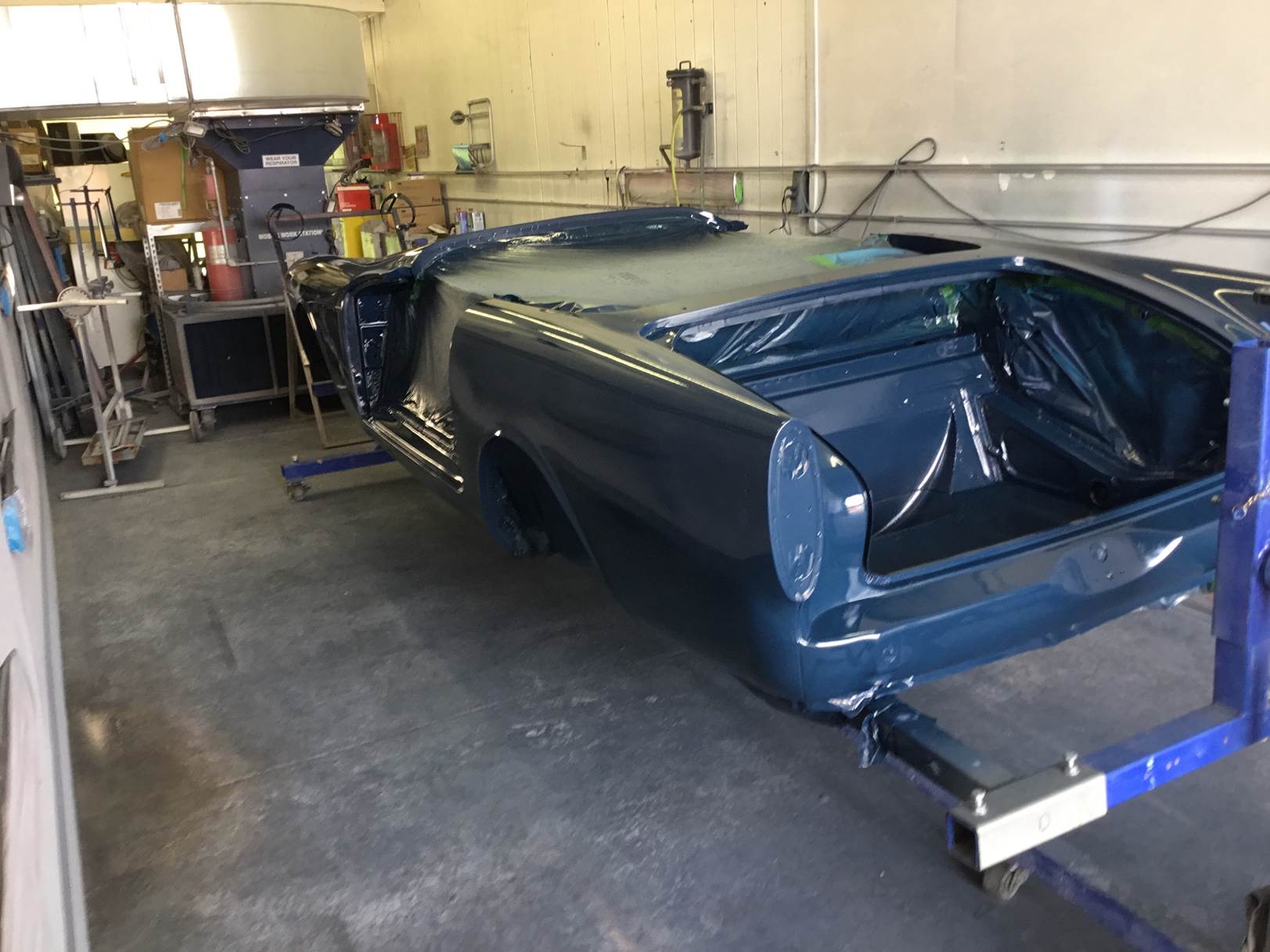

Way more than expected
I read back on this and it’s funny to remember what I thought I was in for. WRONG!
It’s been two years or so, and the blasting revealed a lot needed to be done.
But yesterday it turned blue.

It's Solid (finally)
Thanks Randy!
This one was a challenge. Once started, I actually got two calls from our media blaster asking me if we really wanted to continue!! The car was so flexible at first, some interesting jig geometry was created to keep it all straight for slice & weld. This earned the # 2 spot in difficulty for the shop lads. Fabrication was extensive as the historic rodent acids had won the day. But, here we are with a rescued piece of history. It's a challenge for owners to run this emotional gauntlet. Congrats!!

Good to see it in paint! Mine started out as a "hey I can get this running and fixed up" to wth did I get into. You'll get there and will be happy you went for it. Cheers
