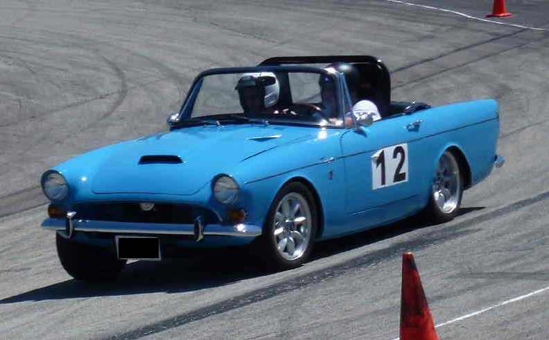

canbeam
154
Best handling Tiger I have ever owned.
• Torque Arm made by Dan Walters
• 450 # Front Springs from Dales Restorations
• 190 PPI Torque Rear Leaf Springs from Dales Restorations
• 15’ Panasport Wheels with Toyo R888 performance tires
• KONI Shocks with 12" Wilwood Disc Brakes front and rear
I'm putting on Dale's complete front end in the coming weeks, as I've heard nothing but good things about it, and looking forward to a Tiger that turns properly. The Wildwood brakes stop the car nicely as well.....
