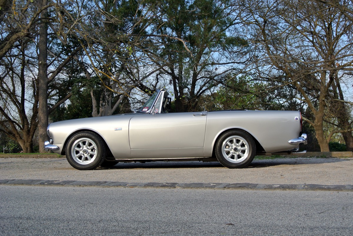

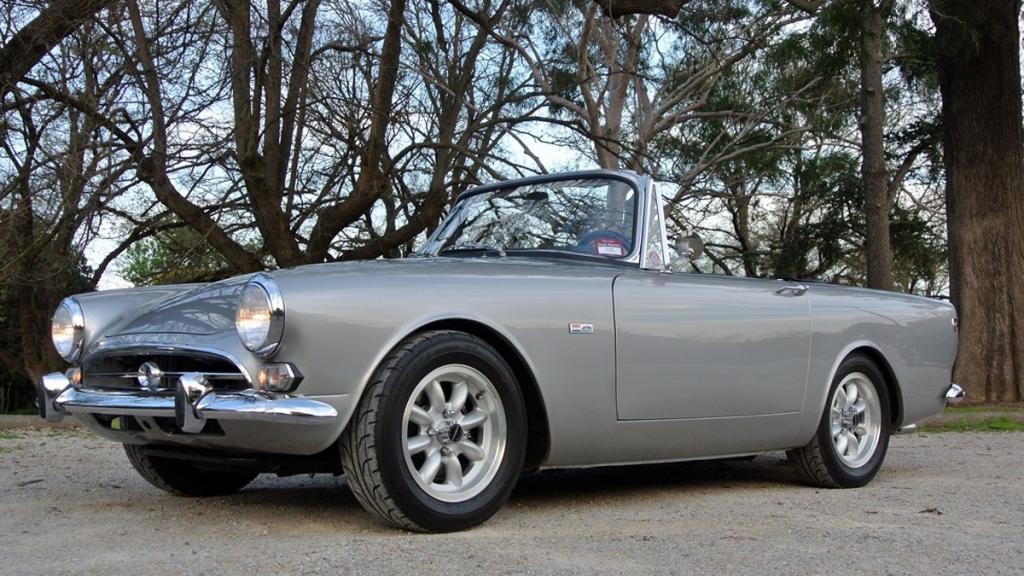

For your reference. My car.. I like the stance. First 2 photos are 195/60/14 front and rear.. Last pic is 195/60/14 front 205/65/14 rear
