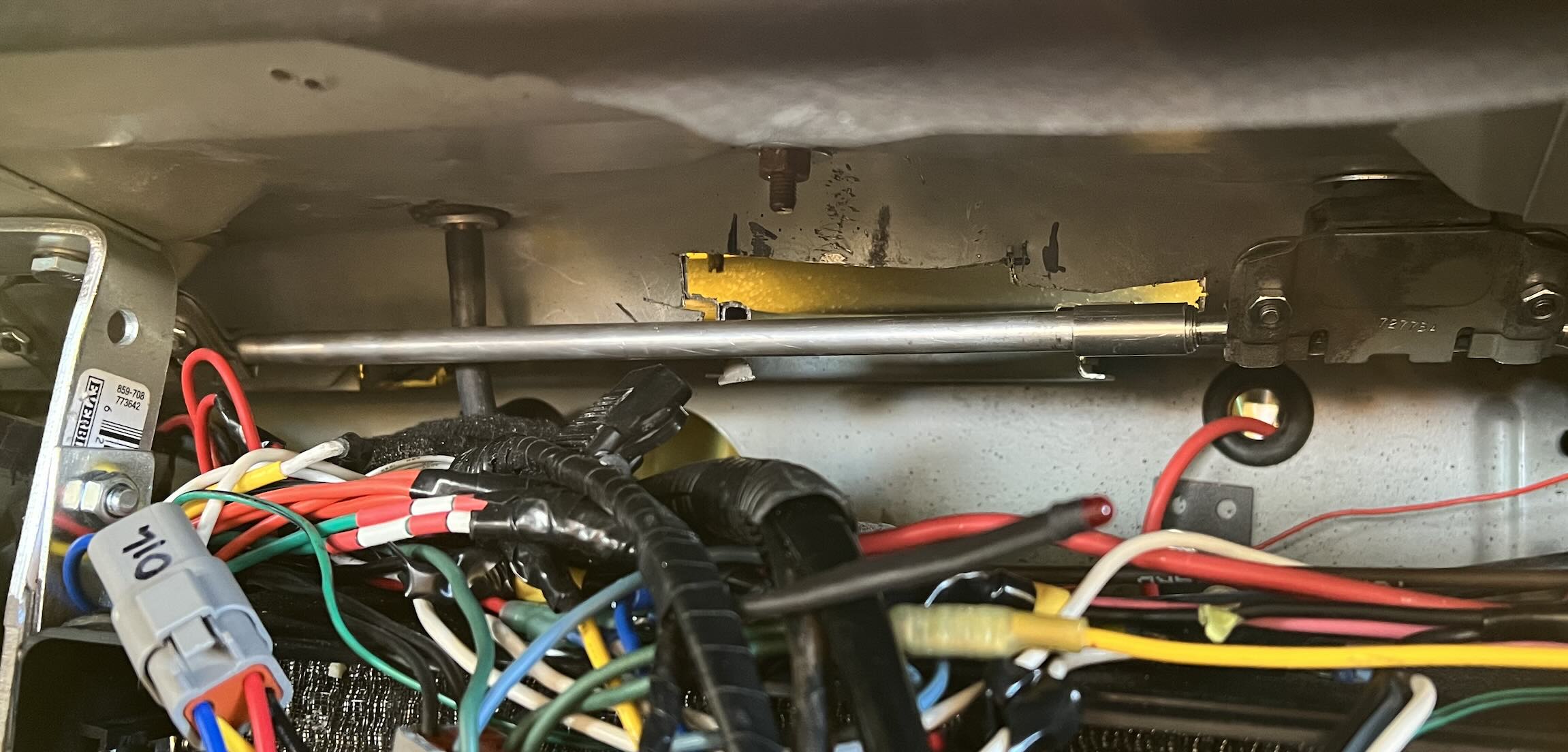

The one issue is that to get from one wiper box to the next the cable/tube has to go around the large circular duct in the middle of the dash. This is for fresh air into the blower motor. Since I wasn’t using that and getting really fed up at this point I took a saw and cut a large chuck out of that round duct. I have to seal it up at the top anyways since it serves no purpose now with the A/C taking up all the room. That allowed me to use a tube that was perfectly straight in that section, with no bending to go around the duct. Blew another fuse.
Not pretty, but got the job done and won't show when the dash is in:

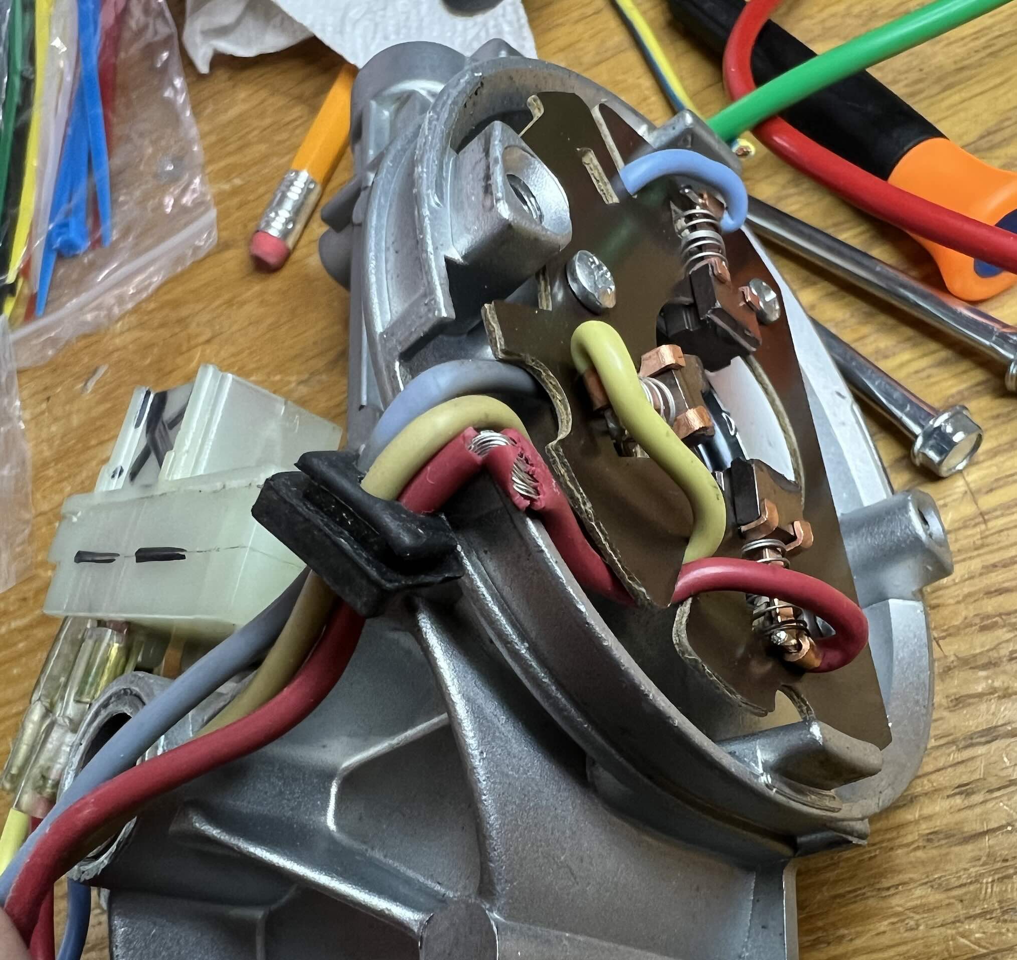

I took the motor out and did some testing with an ohm-meter. Yup, the “hot” wires (the red and yellow ones, for the 2 speeds) were connected to the motor casing. So when the motor was mounted, the hot wires were connecting to the ground directly. Power it on and of course a fuse blows. But why is it like that? I had a really good look at the connections and couldn’t see anything wrong. I figured I might as well take the motor casing off to see what things look like inside, even though I knew that couldn’t be it. Took the casing off and found this:
When I first replaced the brush mounting piece and put it back together, the rubber grommet was out of place and the wire was pinched against the casing. Fixed that and everything OK. Put it back in the car with everything hooked up and the wipers work, including park.
