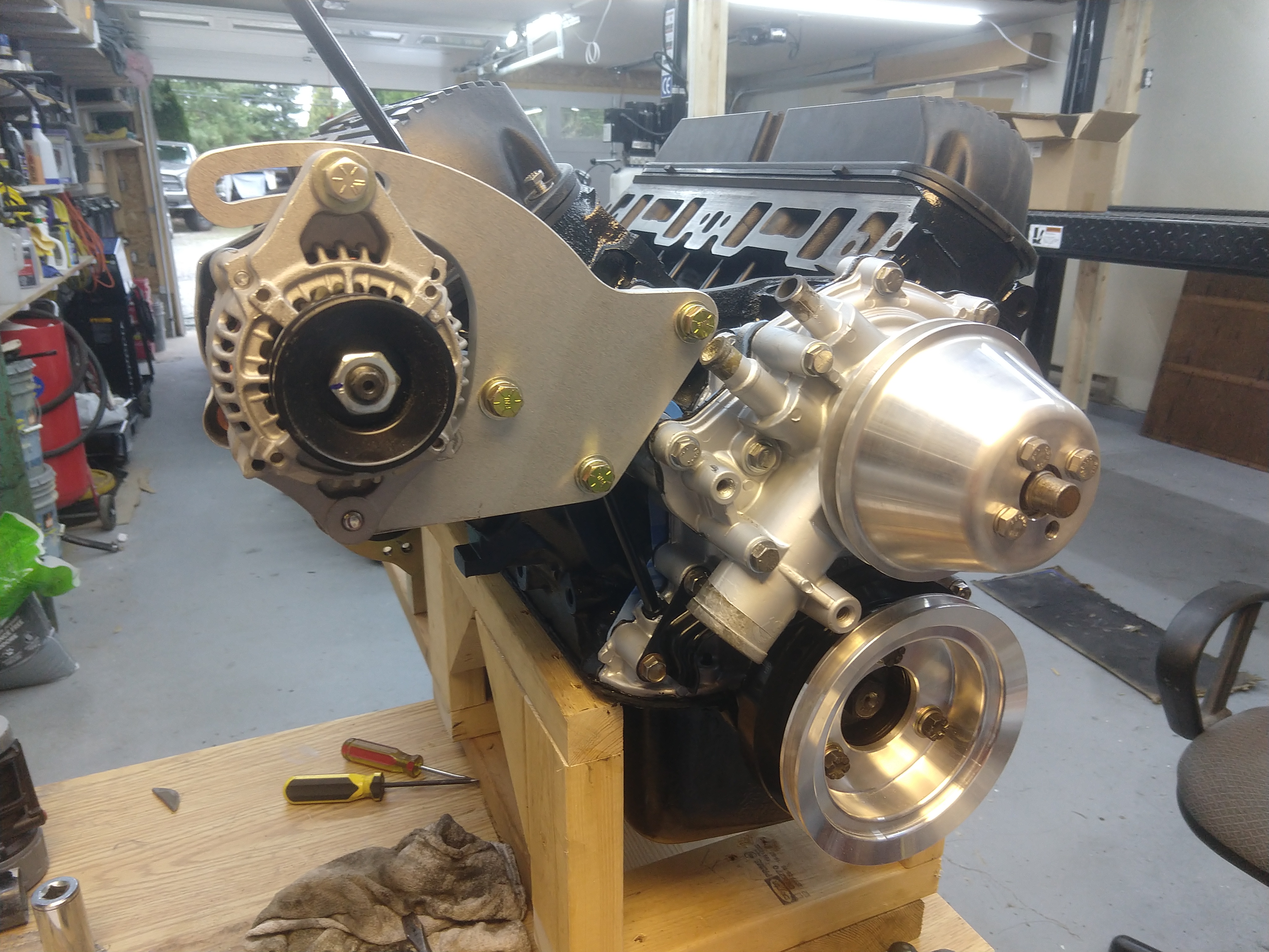

Hi I have used the denso alternator with the details and bracket available from Hoghead
Also with the distributer I finally went with a MSD electronic. But I have e pertronix unit on my Alpine and that has been working for many years.
That would be me with the mini Denso bracket.

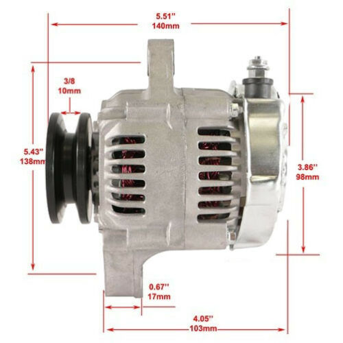

I chose Desno due to the wide range of outputs, 1 or 3 wire versions, integral regulator, Denso reliability, readily available, reasonable cost (unless you are in Australia) and a small frame size. There is a reason they they are the hot rod alternator of choice
There are several ways to do the conversion, including an expensive 90A Powermaster alternator that that looks like a stock generator. I have one, but not a bolt on solution due to the pulley; and while does not line up, it is easy enough to shim into alignment
