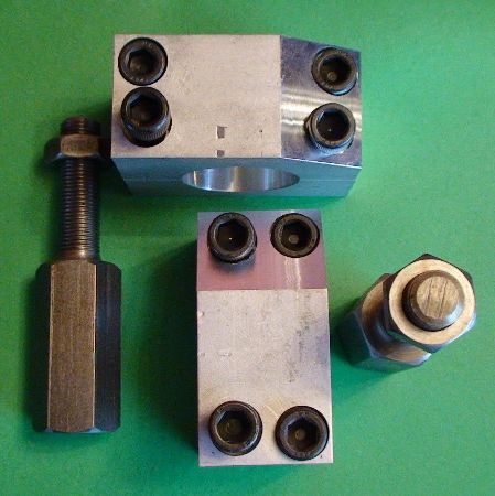

You also need the alpine tierod ends and mgb steering arms. This kind of thing on eBay shows there are some very new and somewhat overeager tiger owners out there

Those bits in the photos were indeed missing a number of parts to do an installation. MGB stearing arms and the Midget/Sprite, quick steer rack.
I have Dale's earlier cross member kit. Dale modified the Tiger cross member with his fulcrum pins, springs and Delron bushings. Welding too.
The Ackerman is not fully corrected with this kit. Much improved! and takes more effort which goes away when you get going.

I sold on a un needed complete front end with that exact part, a way easy replacement. I could do it and I have not ran a lathe since 1975 in high school:D
I have one early Dale kit on my MK1 and I give the rig a 25% grade over stock. But what is more important is is probably pushes me out of personalized class and into modified with the big motor big buck boys.

Except for slightly quicker steering, I never got the need for the Midget rack. Since the steering arms get machined & spaced off anyway, just one more machining step in the taper hole and use the Tiger rack as is. 2-cents
