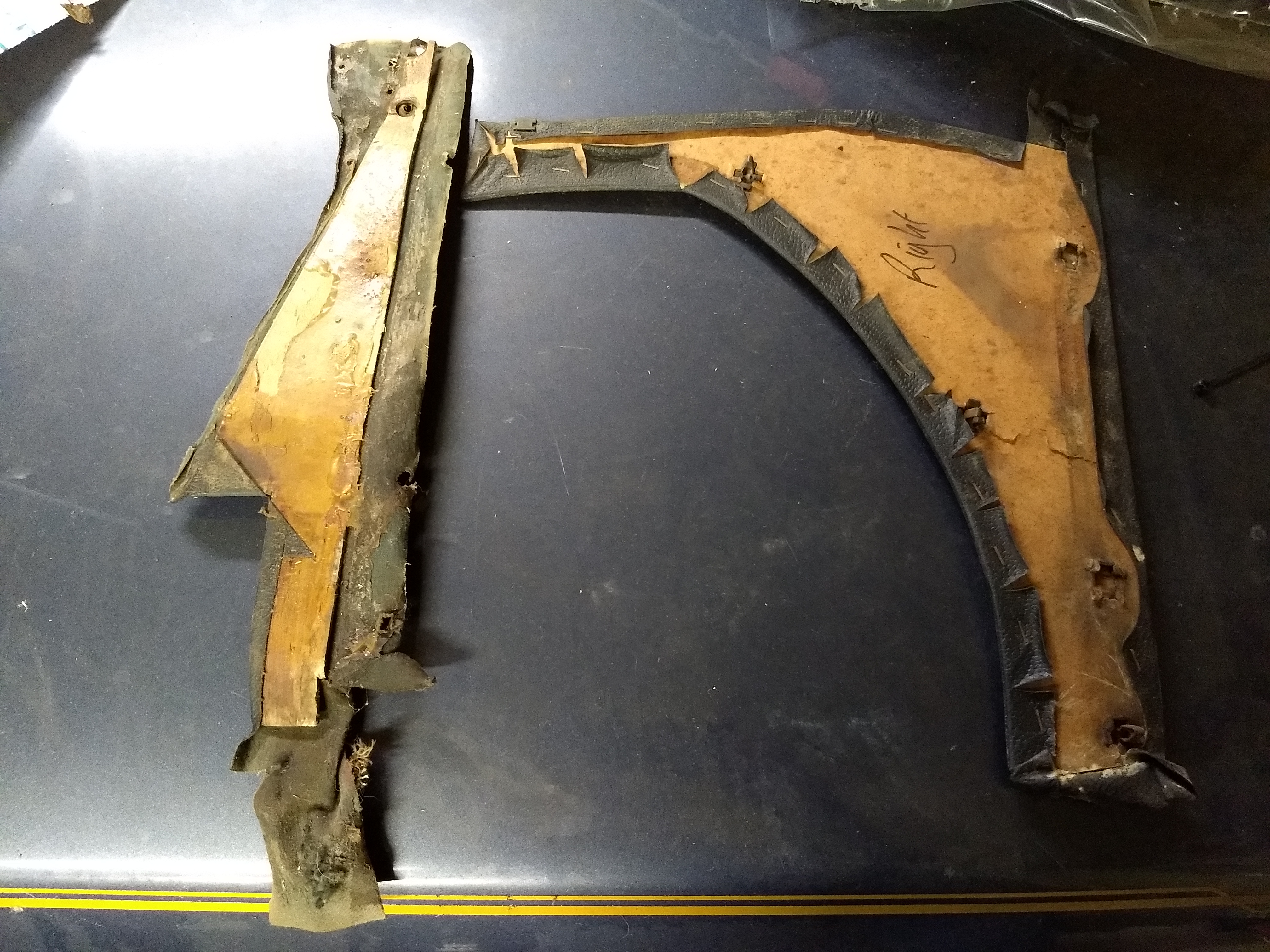

My 1965 MK1 never had the panel interior kit. I am wondering how the B pilar panel is installed. Is it glued in place? Do the 2 side screws that hold the chrome top pivot go through them? Does the vinyl wrap around to the door opening? Any pictures of what you have would be appreciated. Car is almost finished and need help with some small details.

Warren,
here are pictures of my original panels, now off for replacement. It appears that the B pillar panel had the screw at the top from the chrome topper, and otherwise was glued.
Tom
