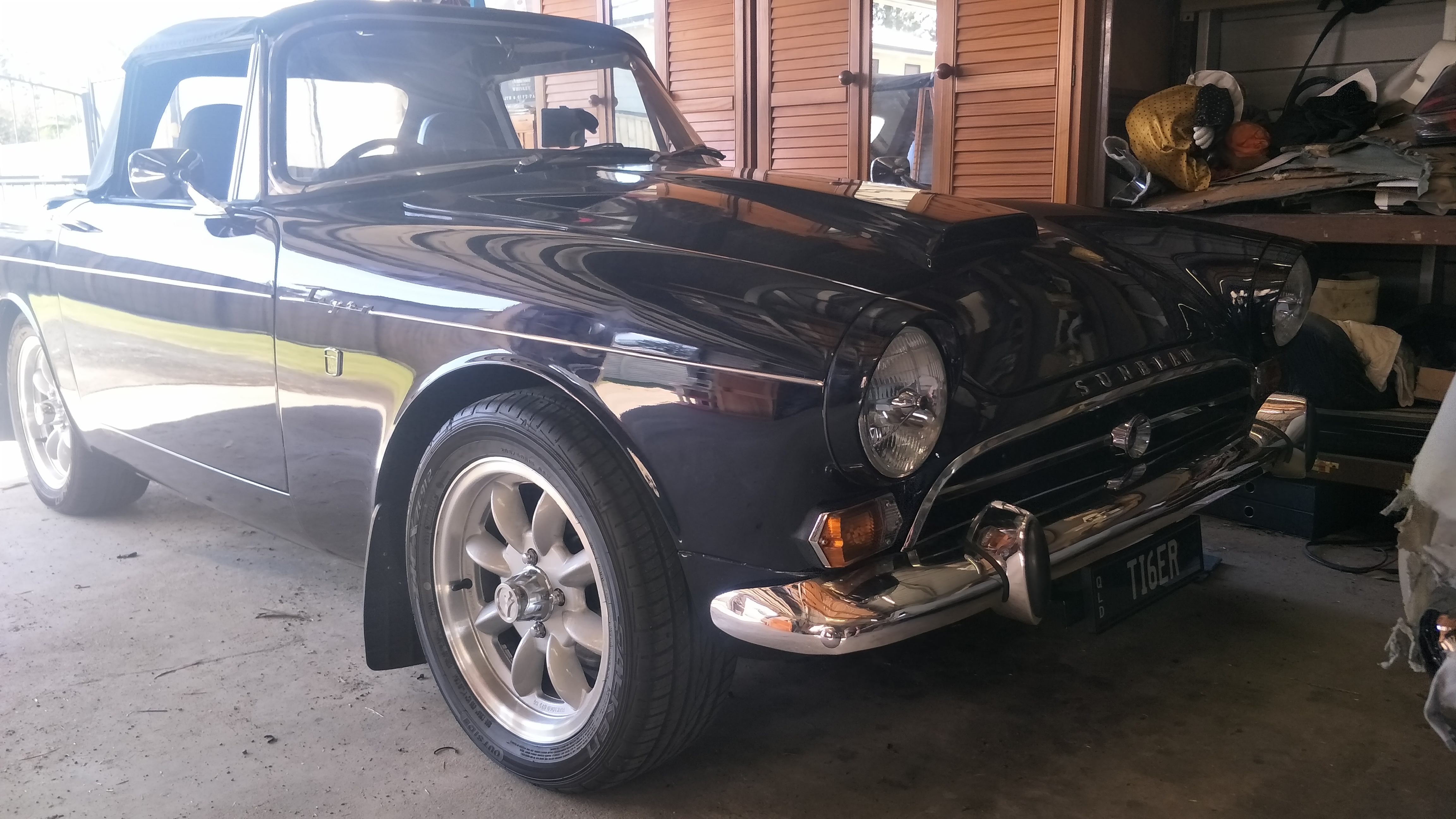

Hello all, it has been a while however I am reaching the end of a long road. The Tiger is finally on its feet and here are some piccies, lots of small work to go however the major items are finally done.

Steven,
Thanks for posting the photos of your car as it nears the finish line. In the pictures, it looks like the color is black. That light blue interior looks sharp against the black paint job. You must be getting very anxious to get this beauty out on the open road! Good luck in finishing it up.
4,156
David, iirc it's a Porsche dark metallic blue, you can sort of see the blue tinge in the farside rear guard in the first picture.
Steven, are the door trims and kick panels just in for test fitting at the moment?

The left door trim is fitted, kick panels to go. did not dare to do the right door while the tiger was on jacks, the bench vice was to close to the door.

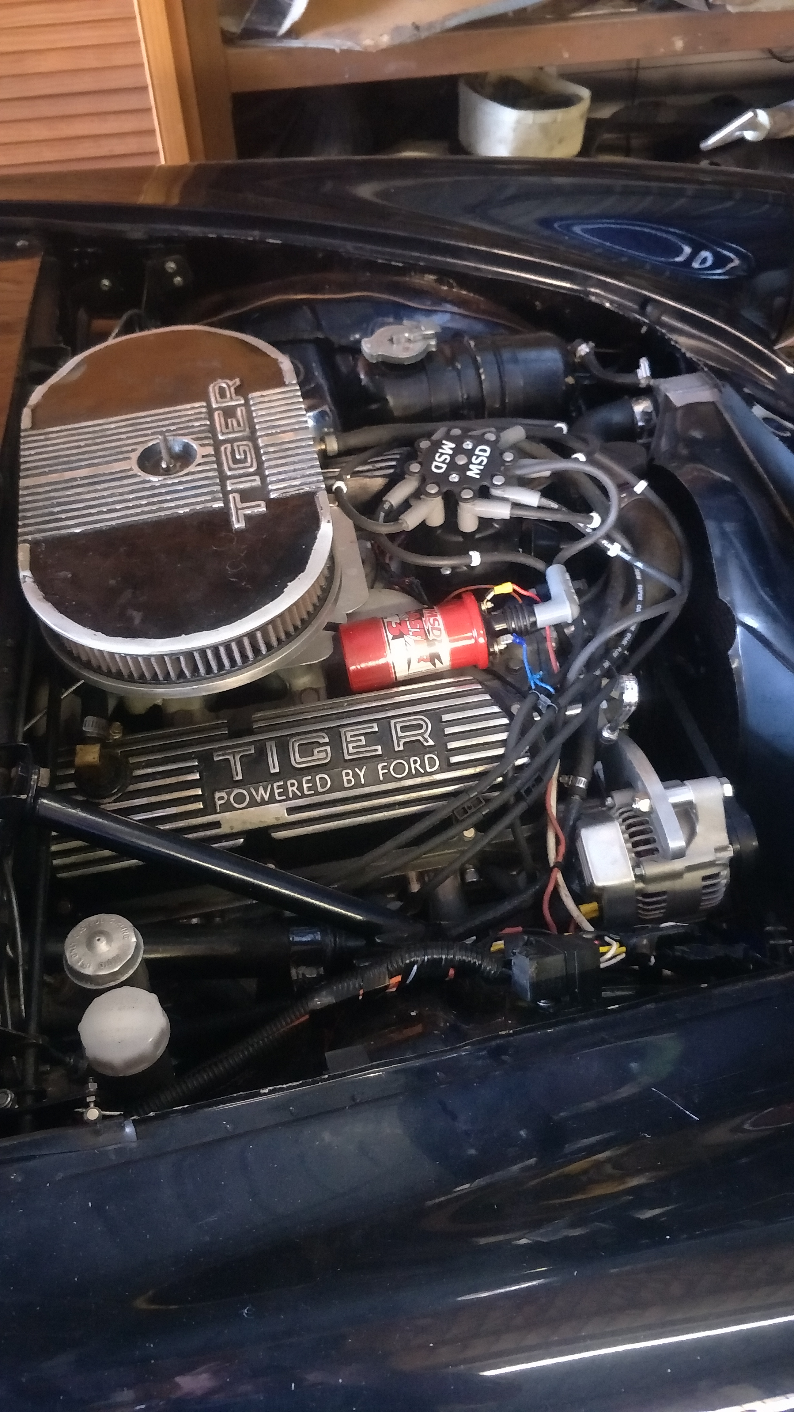

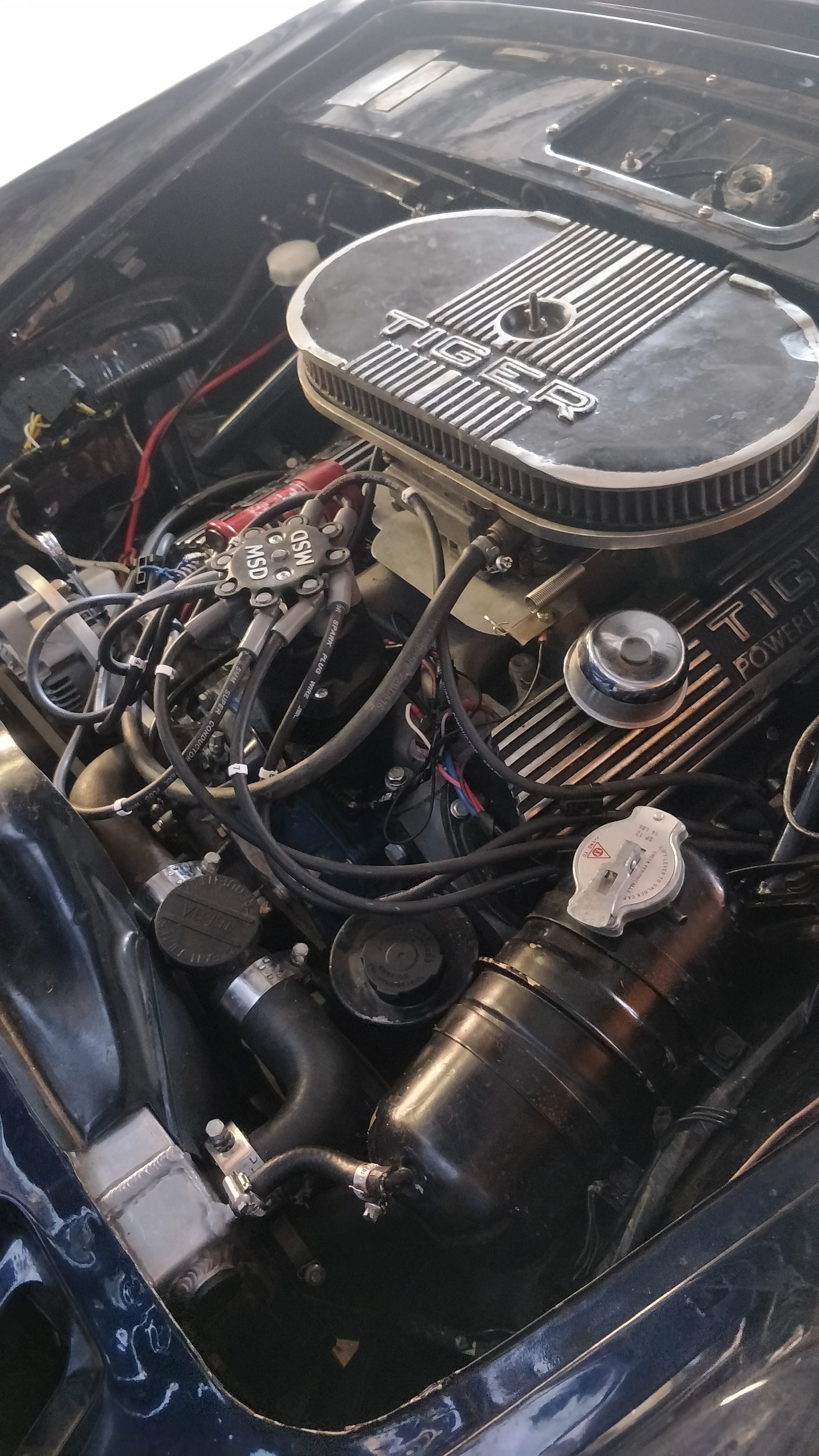

OK thank you interesting after a multi year rebuild I posted here and on our local Sunbeam owners facebook page. Very quickly I had 2 responses asking the price as I was listing it to sell ? I replyed after all this work no way. Here are a couple of engine pics
