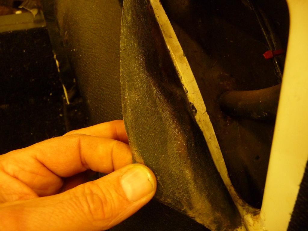

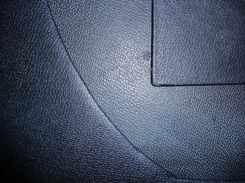

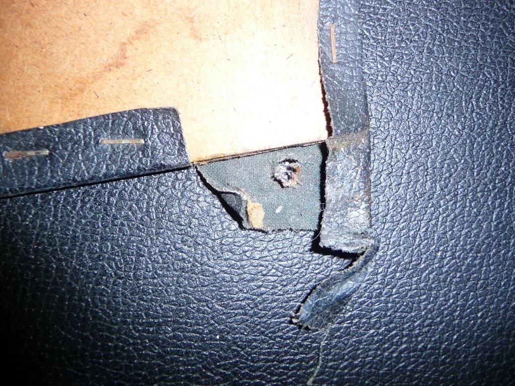

Ok, I've taken a few pics and hopefully they help a little.
The back of the vinyl that goes at the side, next to your legs under the dash.
This is the original vinyl on new board as the old board was like a dog's back leg. Still got it somewhere if you want to be pedantic.
Back of trim piece that curves over the rear inner wheel arch.
Three pieces of vinyl for comparison.
Left is the piece that curves over the rear inner wheel arch, middle is door card and right is card that goes next to your legs.
Back of vinyl that sits on rear inner wheel arch
HTH.
