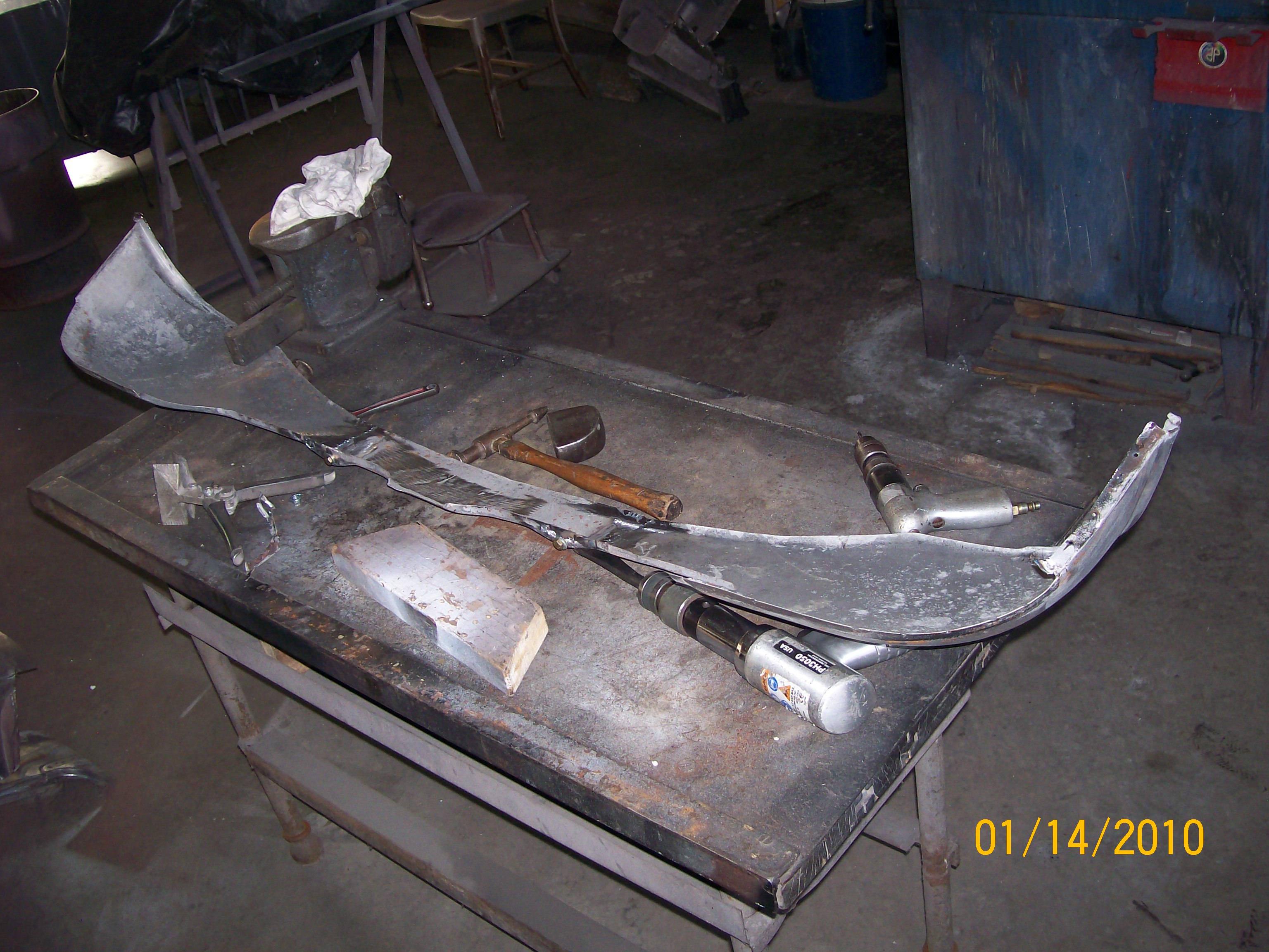

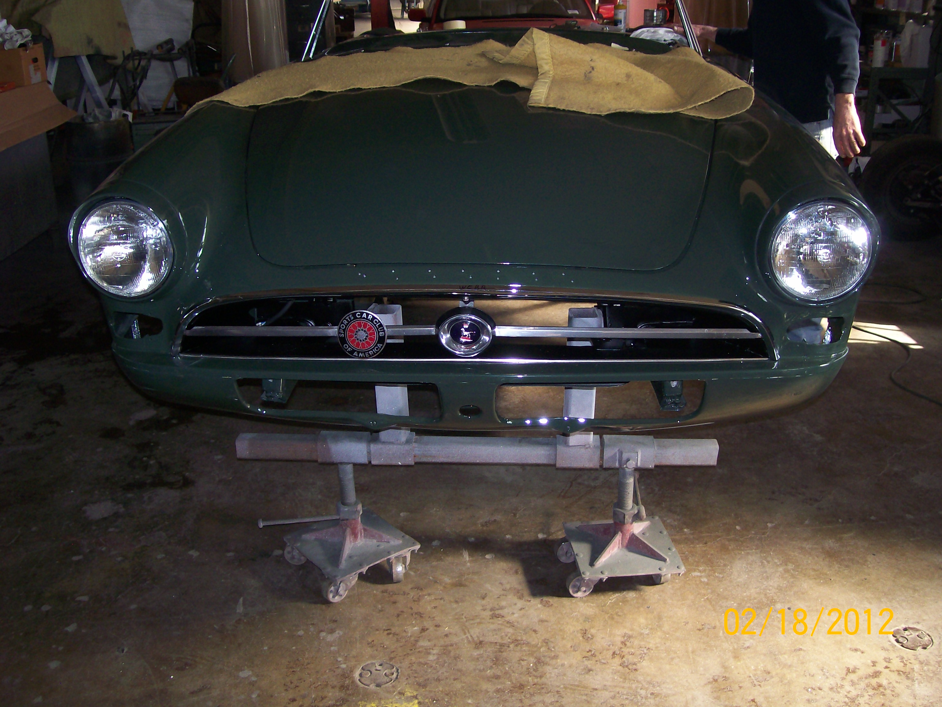

I've wondered who made the panels for VB and was there only problems with the Sunbeam panels or was it also panels for other marques? I took the VB front valance to Doug when he was restoring the body of my green car. He said the valance heavy gauge of metal prevented any tweeking of it. He cut the lower center section and grafted it to original pieces removed from a parts car and a Martel valance top. Second photo shows the finished product.Although we prefer to bang our own tin, I often will outsource panels from others to gain speed on shop projects. Previous VB products could be a challenge. Just sayin'
