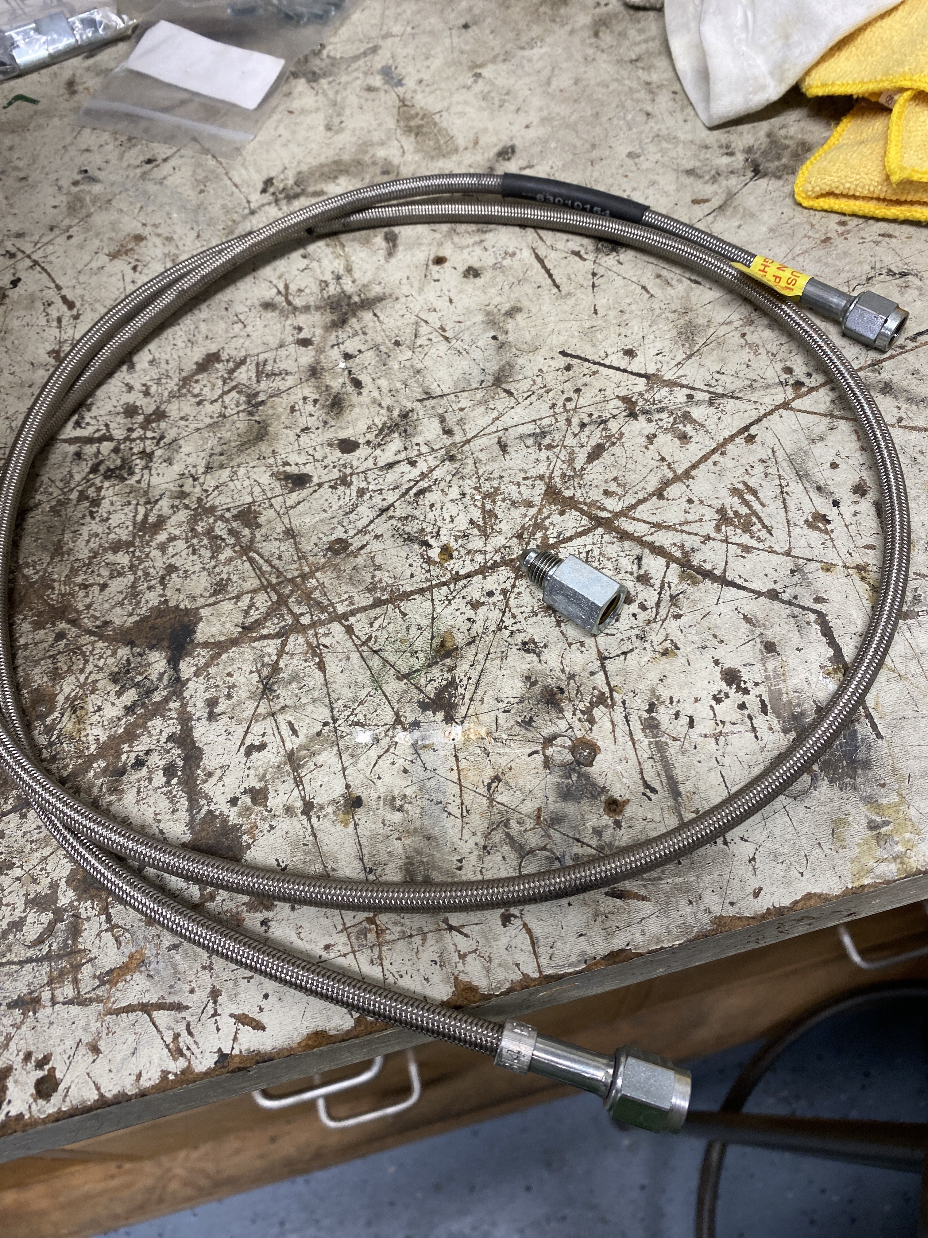

I prefer the braided type. Use that on my drag cars and hold up well (heat and abrasions) . As stated above AN plumbing.com. Use a -3AN line. They come pre made with female -3AN fittings on end of hose, just need to know how long. I believe the block side 1/8NPT to -3AN male. Gauge side I have aftermarket (same 1/8NPT to -3 AN). Stock gauge may need adapter. Below is what they look like with adapter in center.
