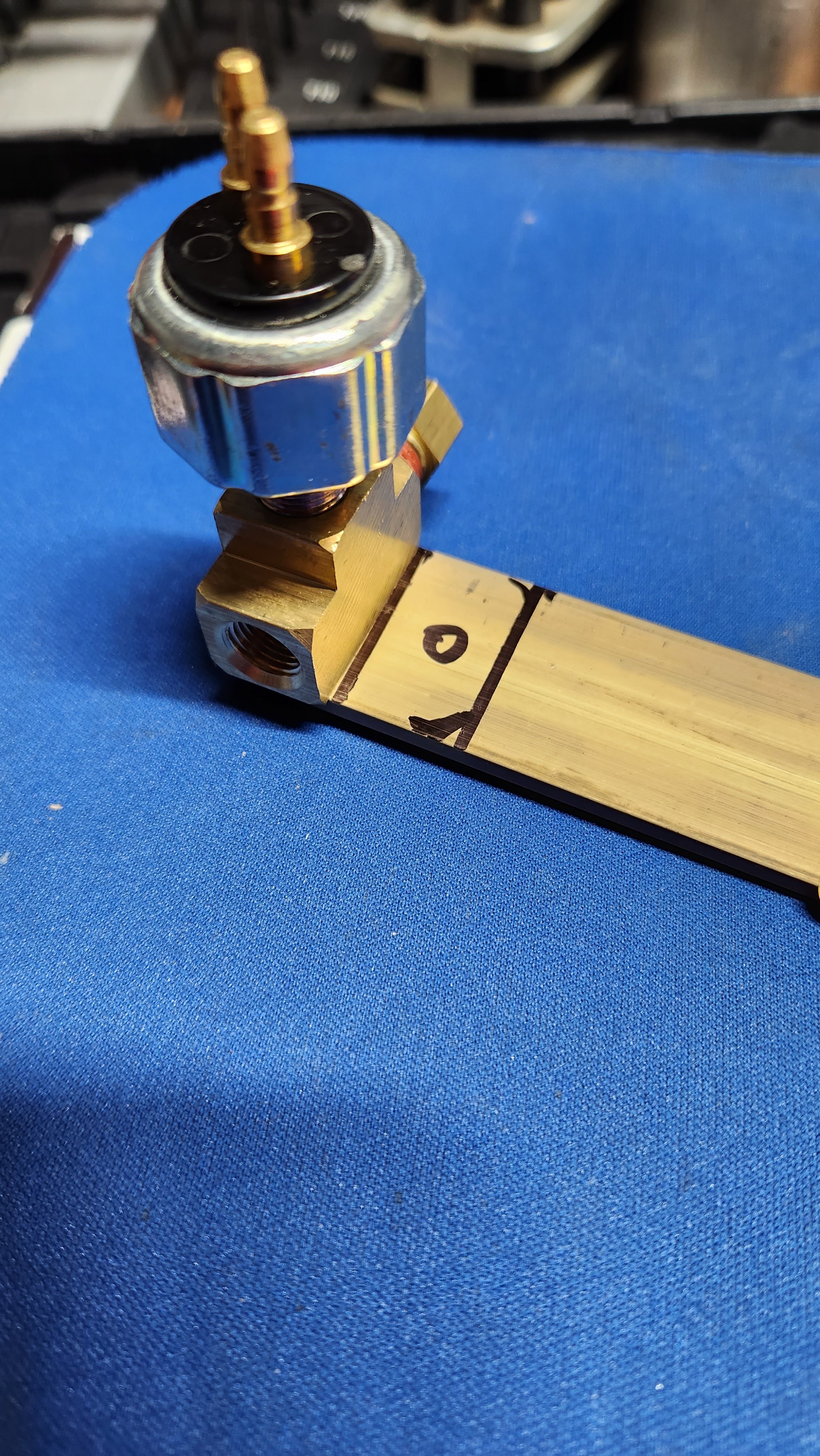

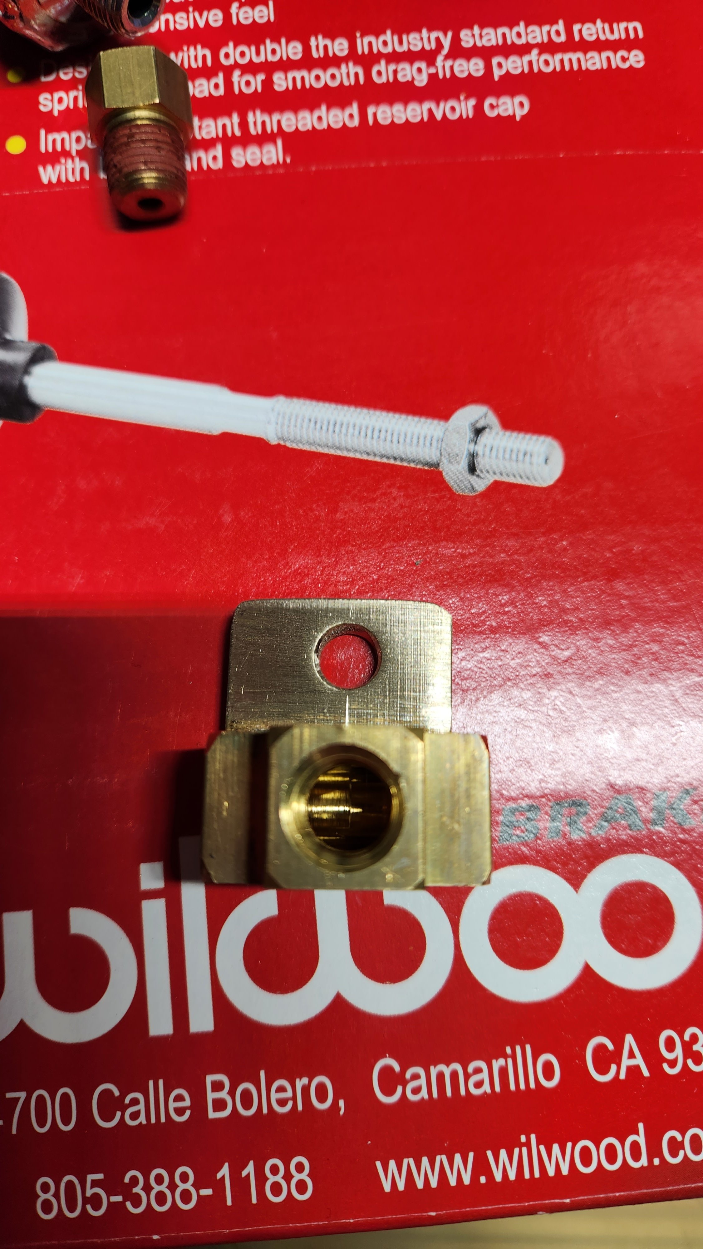

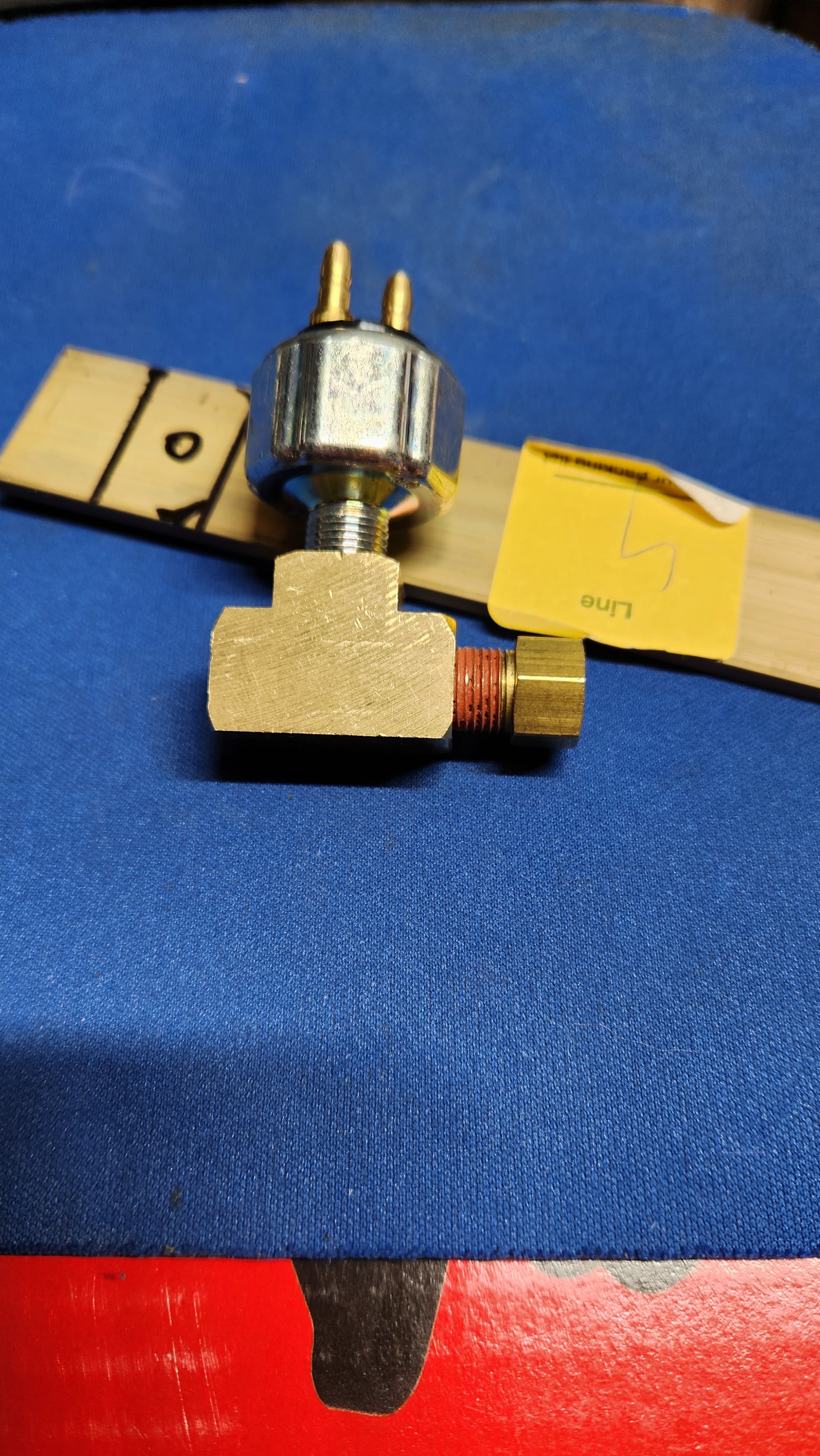

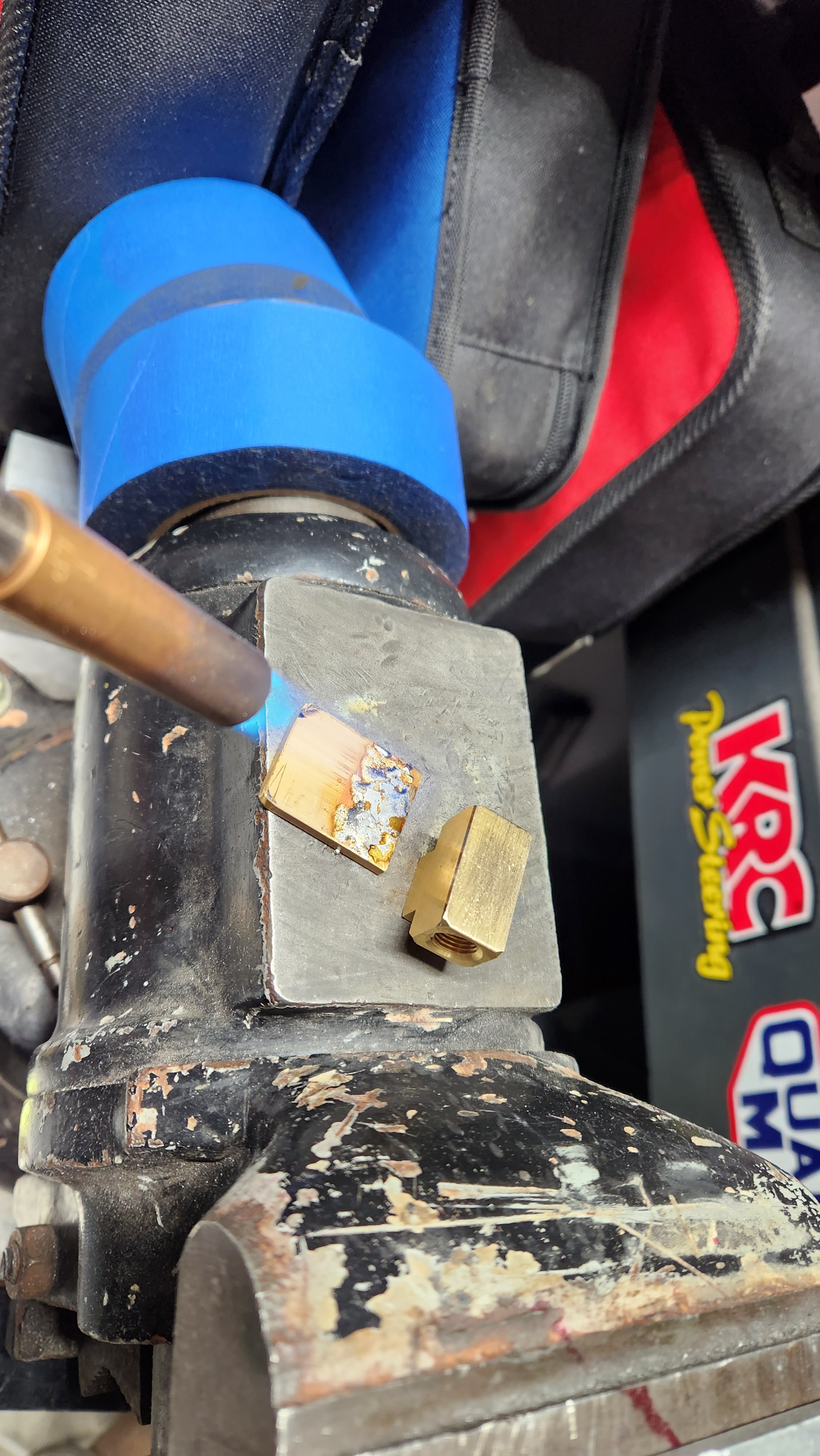

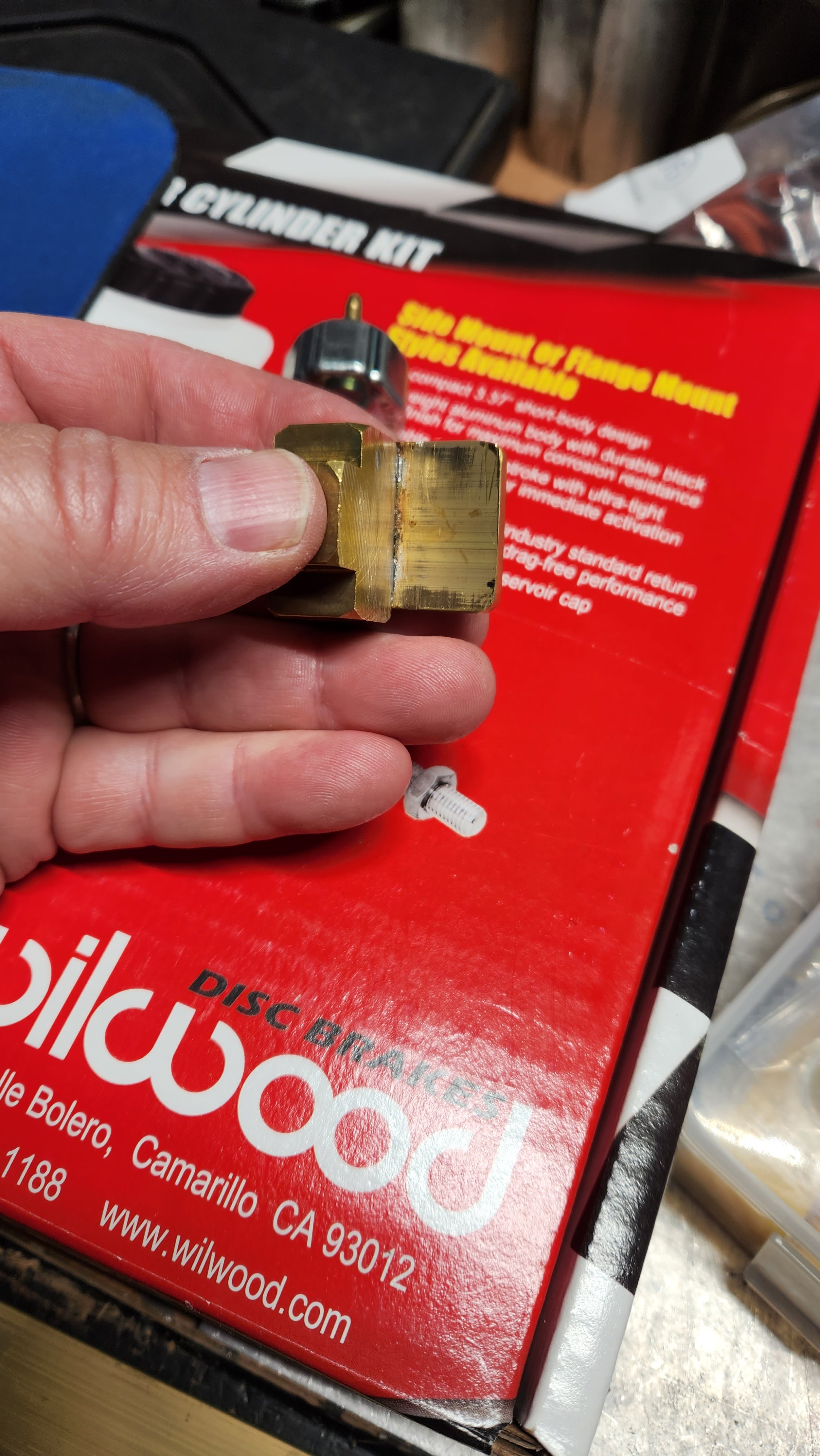

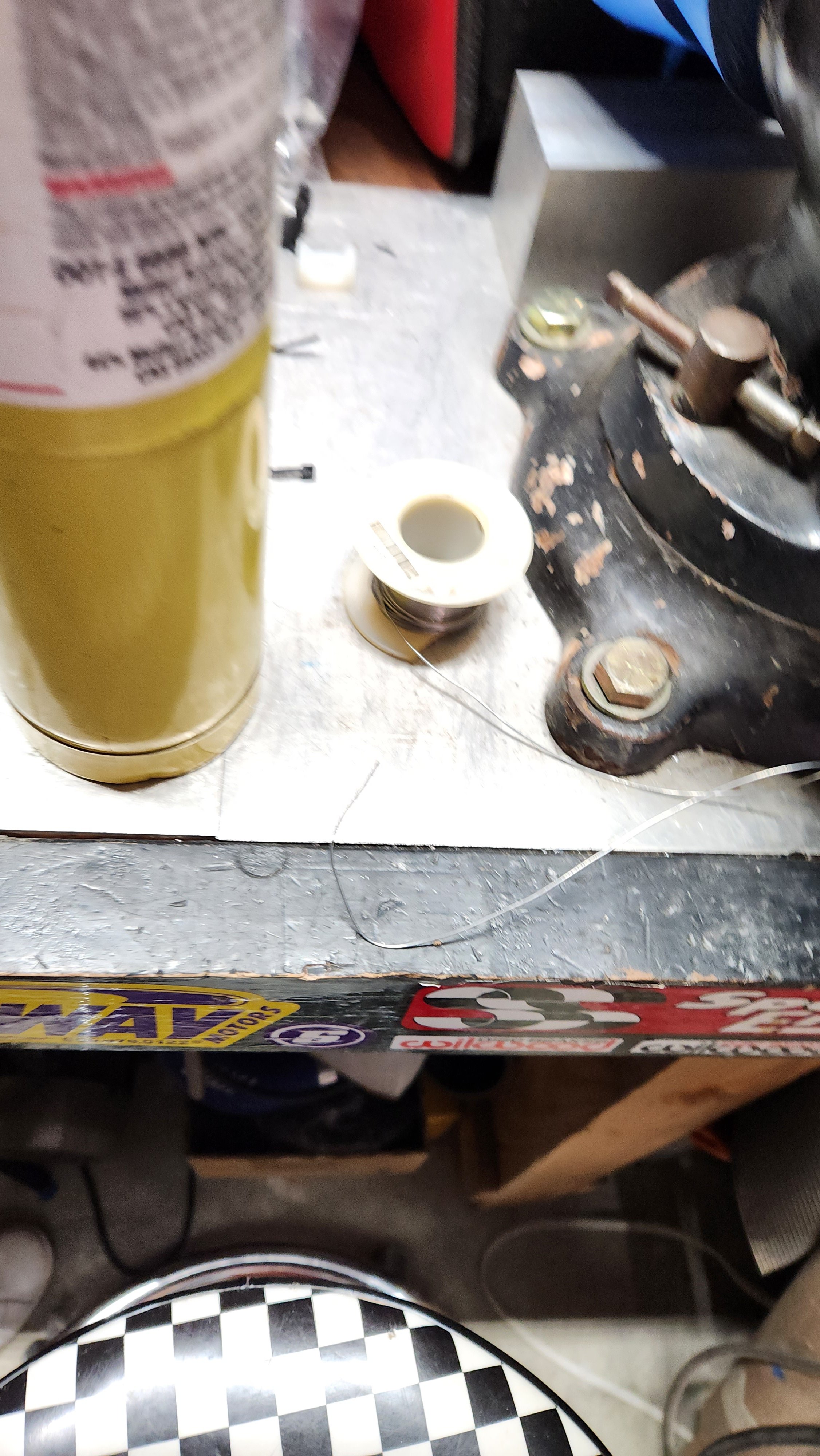

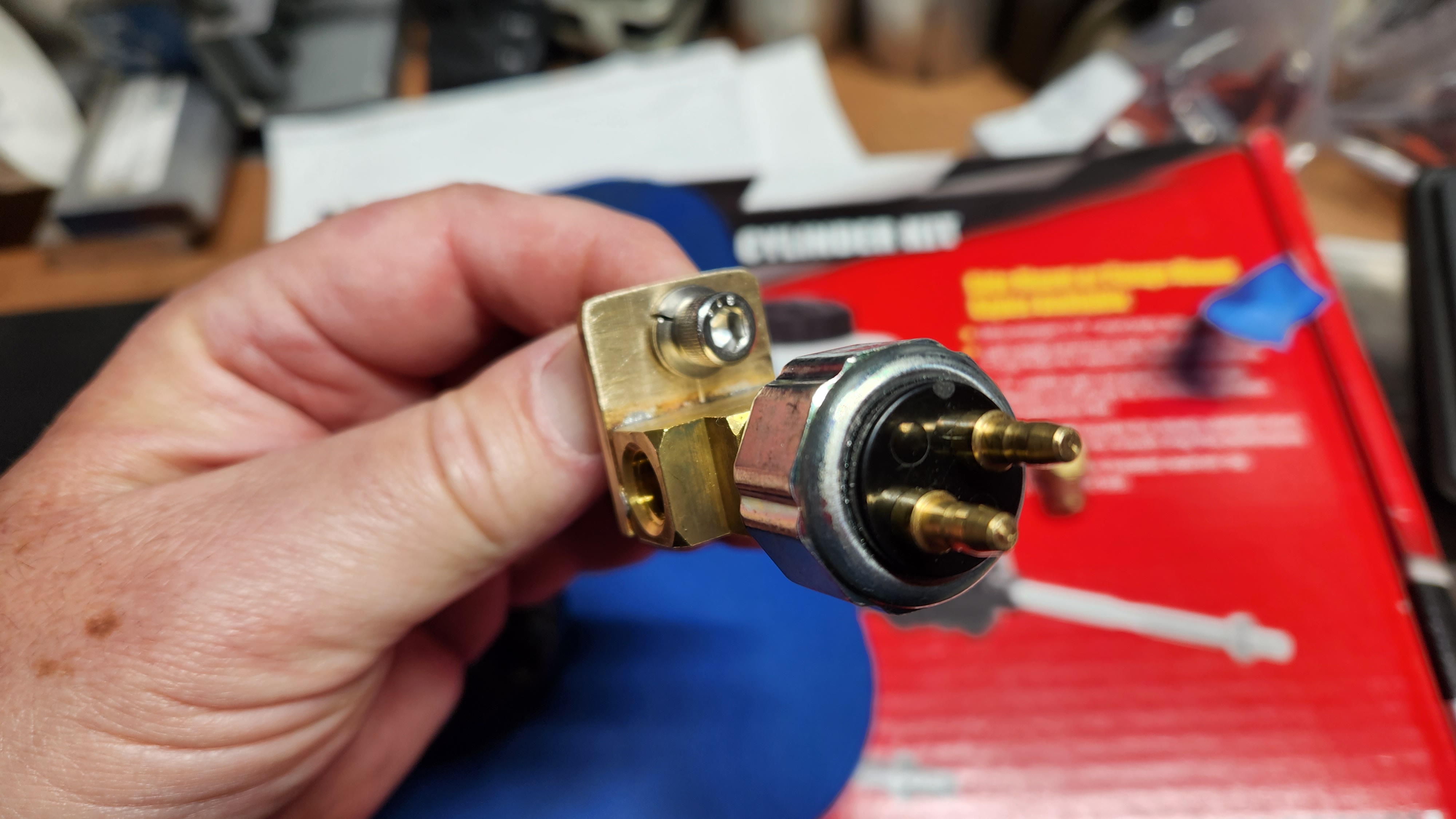

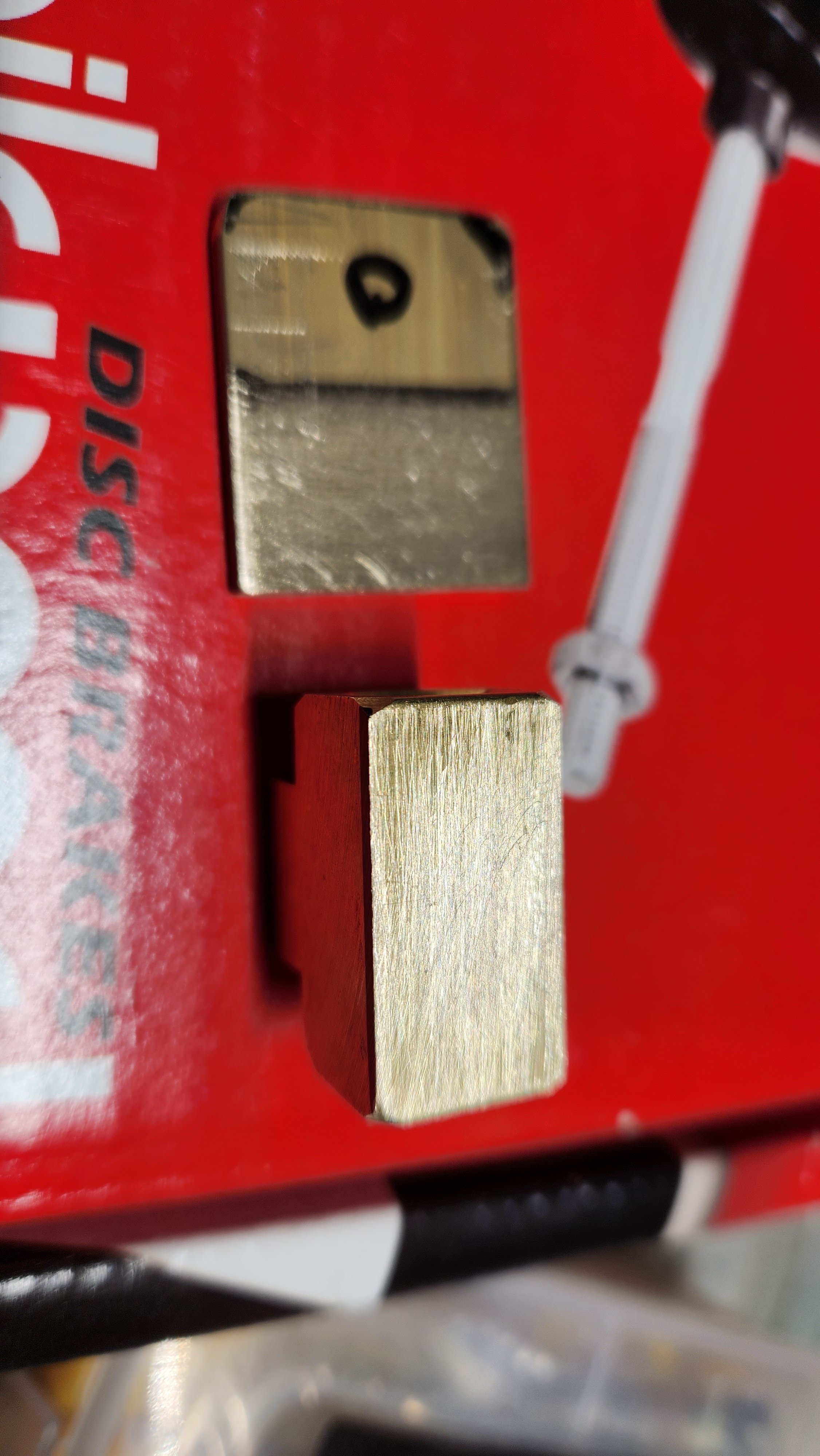

Started working on the lines from the masters. Needed to get a 3 way tap for the pressure switch, and found that I needed a 3 way tap with pipe thread. Found plenty of those, but nothing with a mount. All the ones with mounts were inverted flare or some combination of ports that wouldn't quite work with what I needed. So I had to make something up. Got the 3 way tap from McMaster, as well as a piece of brass to attach. Map torch, some electronic solder (with real lead), and seemed to do the trick. Nice and strong too it seems.
