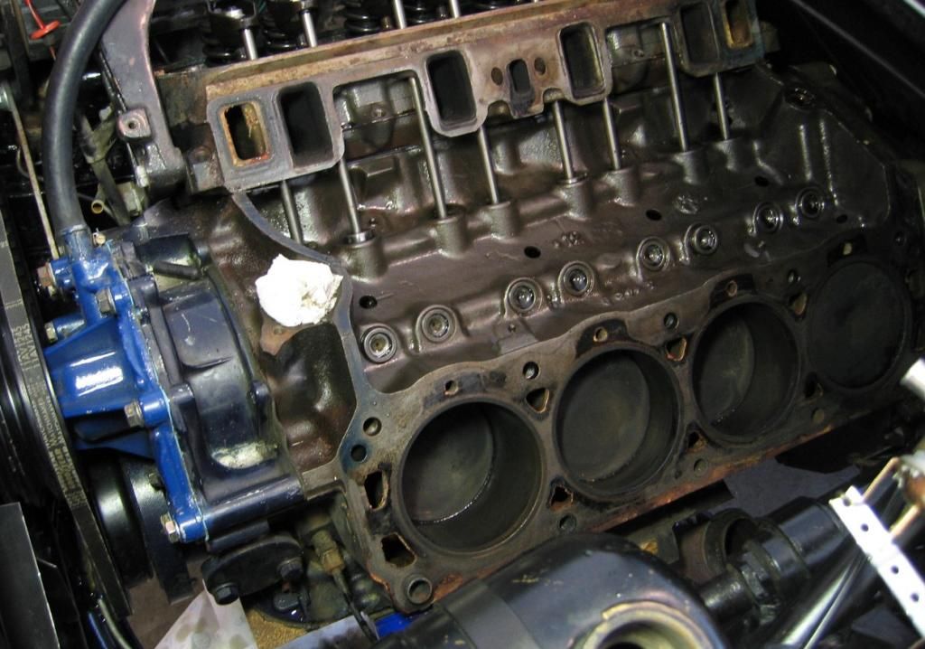

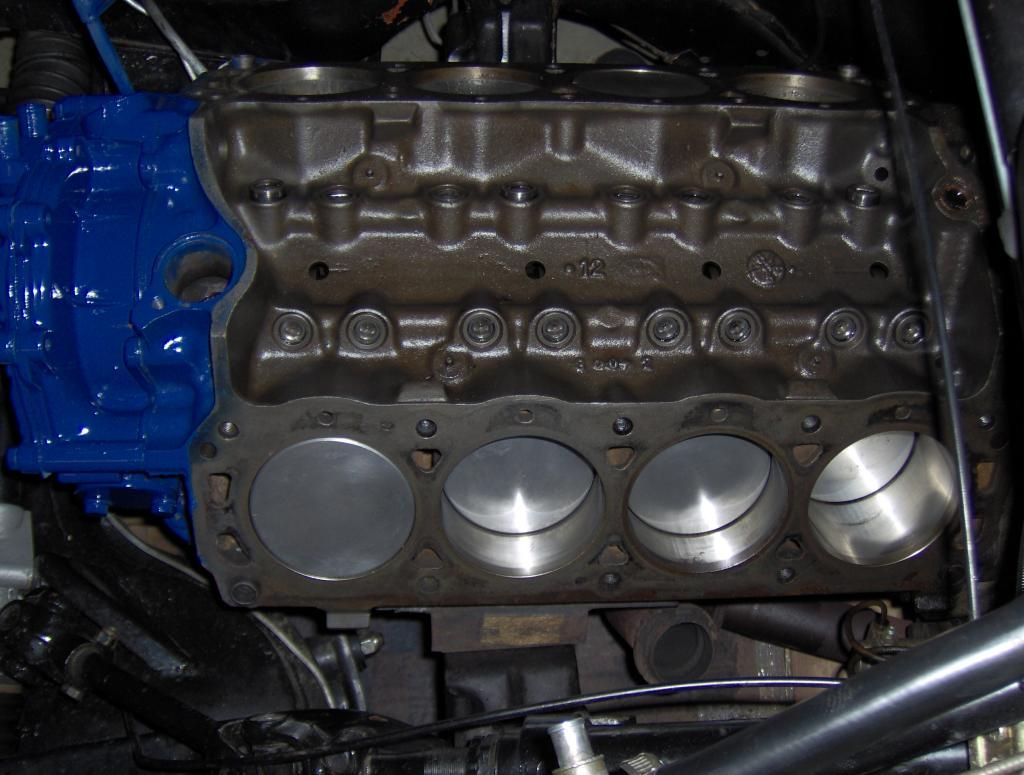

Proof!
I pulled the heads for a valve job in the car. It can be done.
Hardest thing was to get the rearmost valve cover bolt.
On reinstall I got a longer bolt and added a tubular spacer so I was able to get on the bolt head with a short socket. You almost cannot see the modification.
