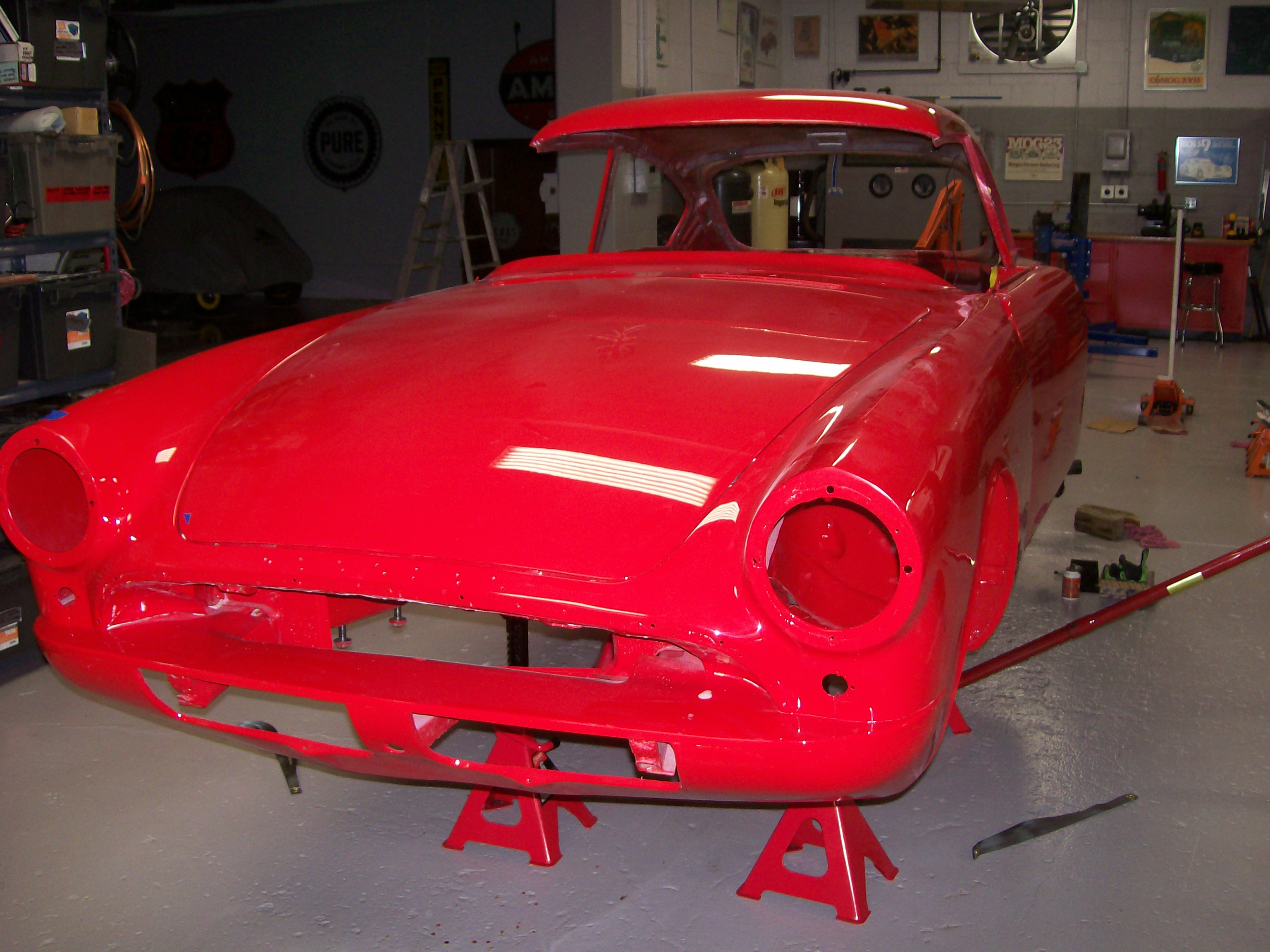

I went to my local PPG jobber yesterday to get a sample of Carnival red for a spray out. The current code from the PPG Color Library was 71144. I am quite pleased with the color.
The formula I got was for single stage (DCC or Concept). For 1 Qt mixed the formula is.
parts / cumulative
DMC 900 strong white 88.2 parts / 88.2
DMC 987 orange lf 569.9 / 658.1
DMC 917 red 438 /1096.1
DMC 931 violet 32.8 / 1128.9
Of course, this is little help for the California crowd for who the mere mention of paint, causes cancer.....
