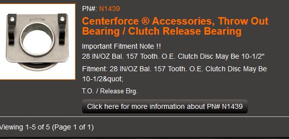

I just change my clutch ( did not use a centerforce) but I have use a center force throw out bearing . Cannot me more please , no noise at all . The best throw out bearing available .
Gilles
