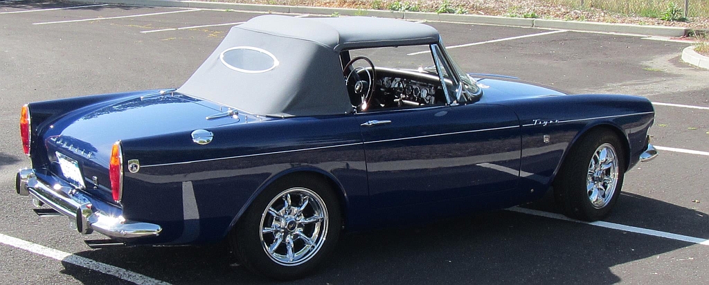

Like R. Hulse's Commodore Blue pictured earlier but that is not the size of the Fox Body Mustangs. It's much bigger and is two piece which with some creative redesign fit in the top well or be made completely removable.
