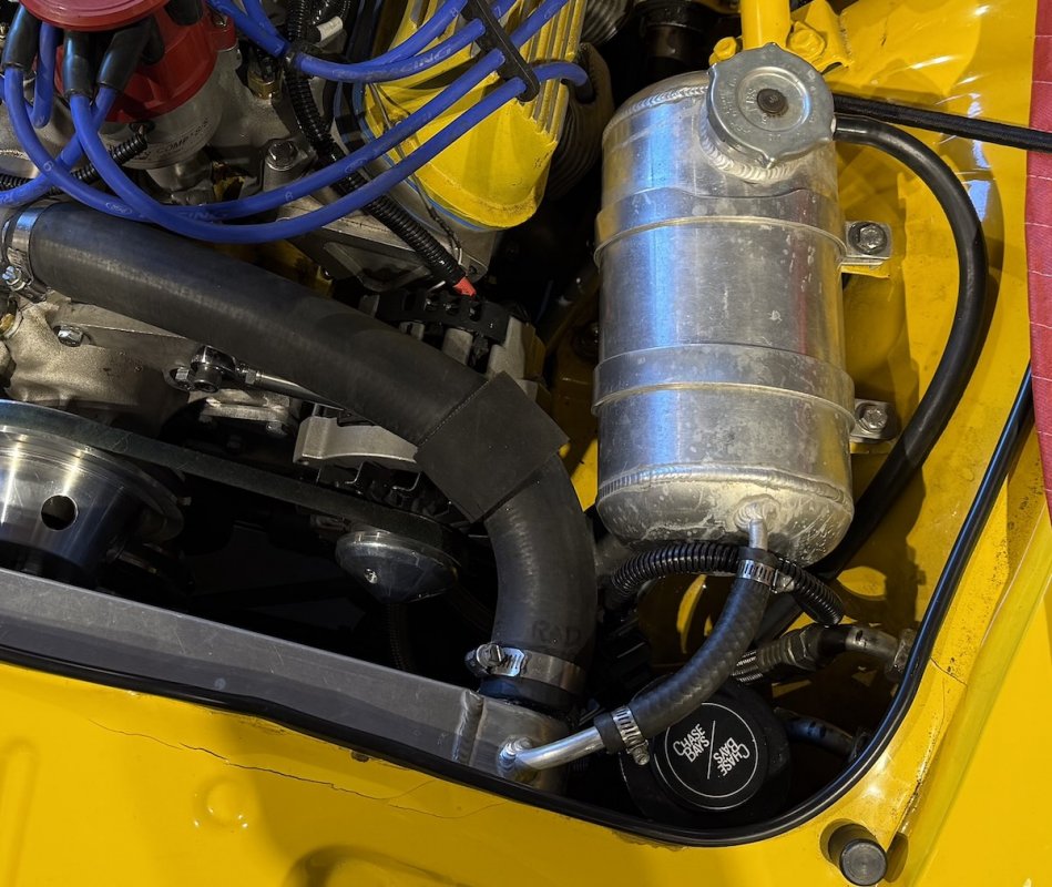

QUESTION FOR OTHERS : I thought the purpose of the tank was to collect the air (Like my diesel has an outgas tank) to ensure things are full. The way the Dale/Fluidyne radiator are plumbed I think that is how it works, but can't remember how the Griffin or Stock one does it. Pic attached of the Fluidyne with the bleed at the top left back to my tank.
