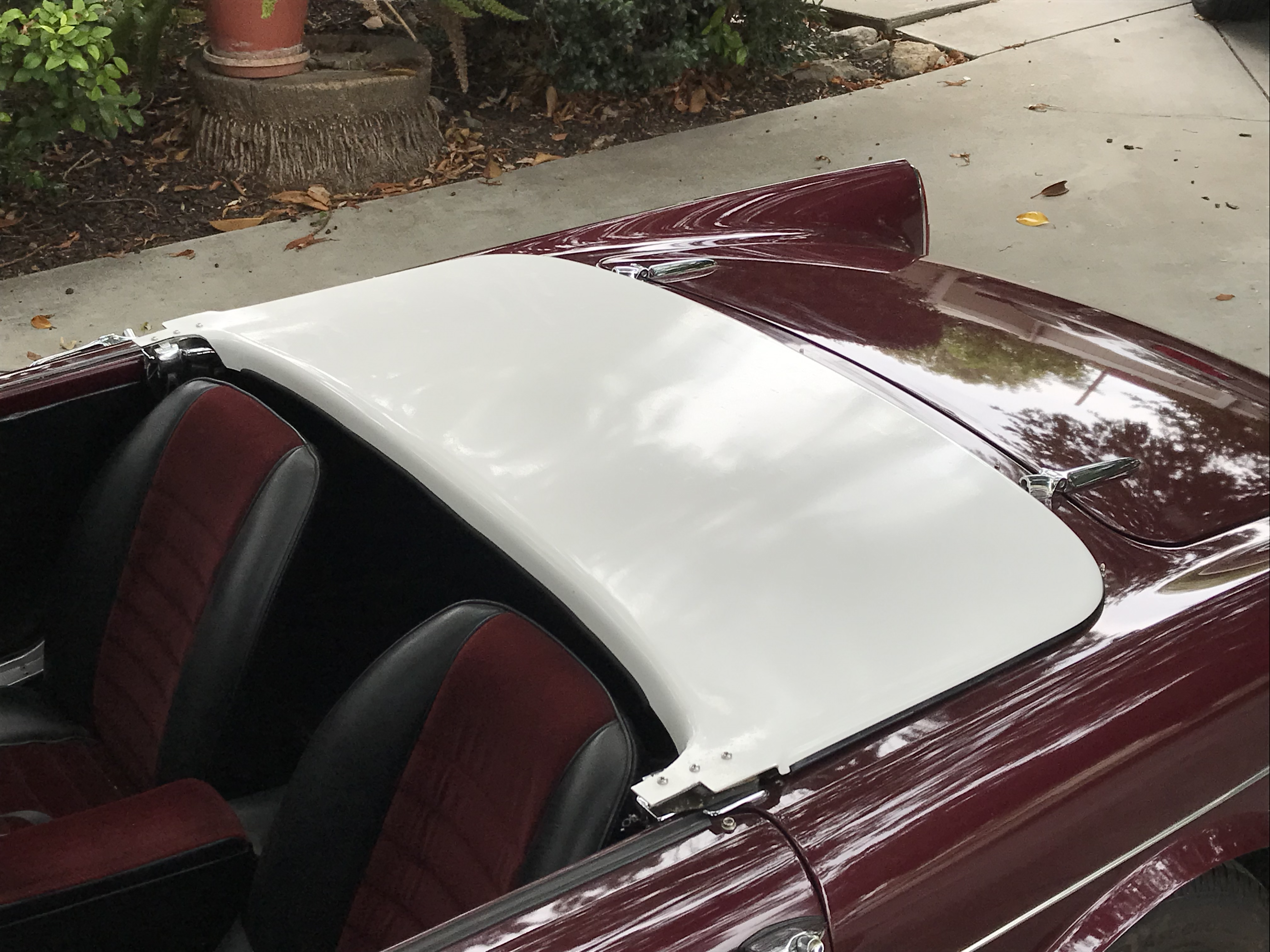

As for the waist roll show me what is laying about. I could order a new one or have the fellow who did my top in the 80s make one but his time is best served to have a pattern or model. Dano66 has his 1/2 tonneau pictured. I have one that I am adding to. I have reinforced it so it could accept headrest and a guide at a proper angle for a shoulder belt.
