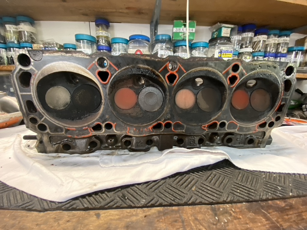

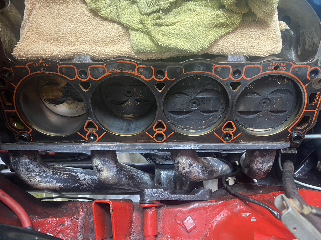

The engine is not a HiPo but a mixture of parts. I pulled the heads and found out they are 1969 C90E heads and the pistons are Speed Pro L2482F30. The timing chain is a dual row with metal gears and looks fine. The camshaft looks like a HiPo unit with the wide balancer and solid lifters with .320 lift. The rods are C80E-A with 5/16 nuts, definitely not HiPo but they look straight. The crank journals are -.010 but look fine. I think I will replace the main and rod bearings and rings. Replace the heads with AFR 165's. Flex hone the cylinders, clean everything up and hope for the best.
that one cylinder has been steam cleaned pretty good- leaky something?
Front cylinder has all the indications of water getting into the bore. I'd certainly have the head magnafluxed and checked to see if it's flat. at the very least a blown head gasket. Between the top of the piston and the exhaust valve I'd suspect a blown gasket at the very least.
looks to be the #4 cylinder... back on the passenger side.
