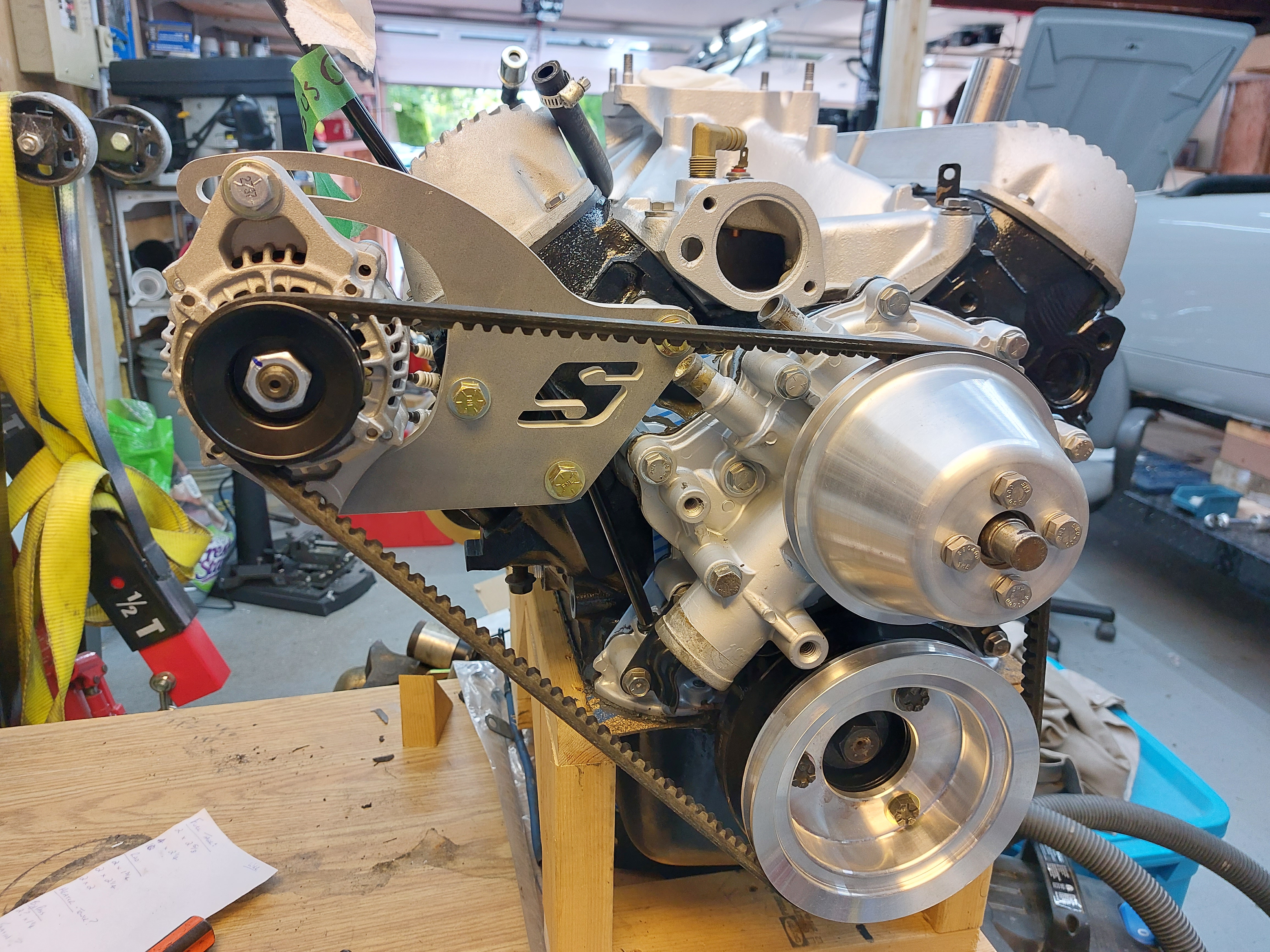

I am thinking of making a small run of "Fairmont" fan pullies and stock 3 bolt crank pullies. Also on the to do list is a 2 sheave Fairmont pulley for a mate who what to use a shorter alternator dive belt to reduce whip at high RPM
6061-T6 billet aluminium, in as machined condition
Most Owners seem to have done this mod by now, and I am thinking of not making any more in the future. If you want in on this run, send me a PM
Do you also make the alternator bracket? Cliff
Yes - With or without the Sunbeam "S" logo

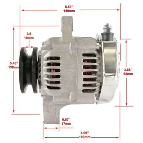

Made for the Desno 93mm OD mini alternator as found on small equipment or sold by the likes of jegs and Summit as a mini hot rod alternator. Various outputs and finishes in both 1 or 3 wire configurations.
Mounting style diagram attached
