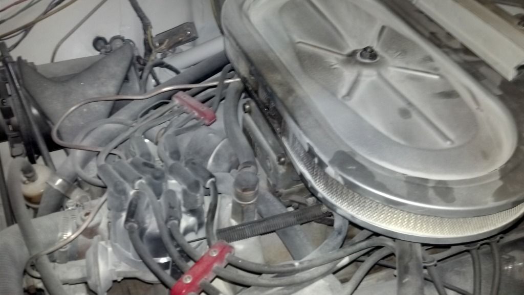

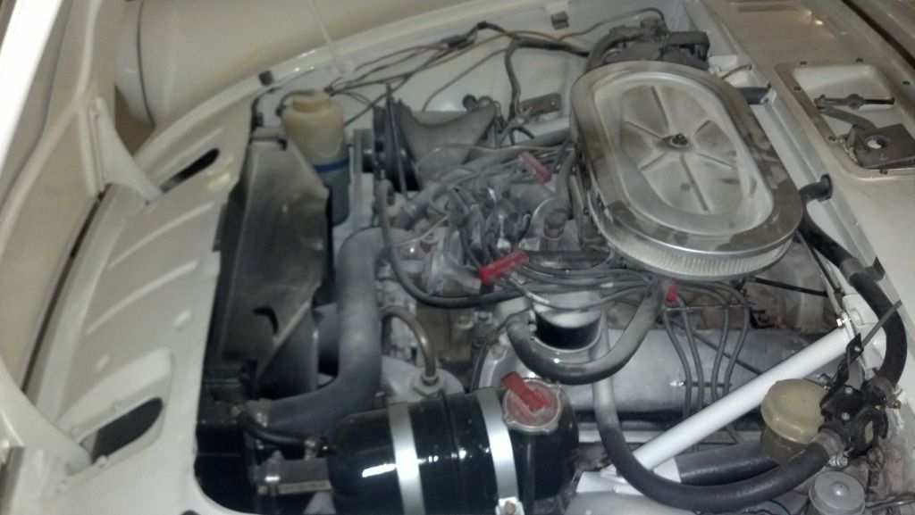

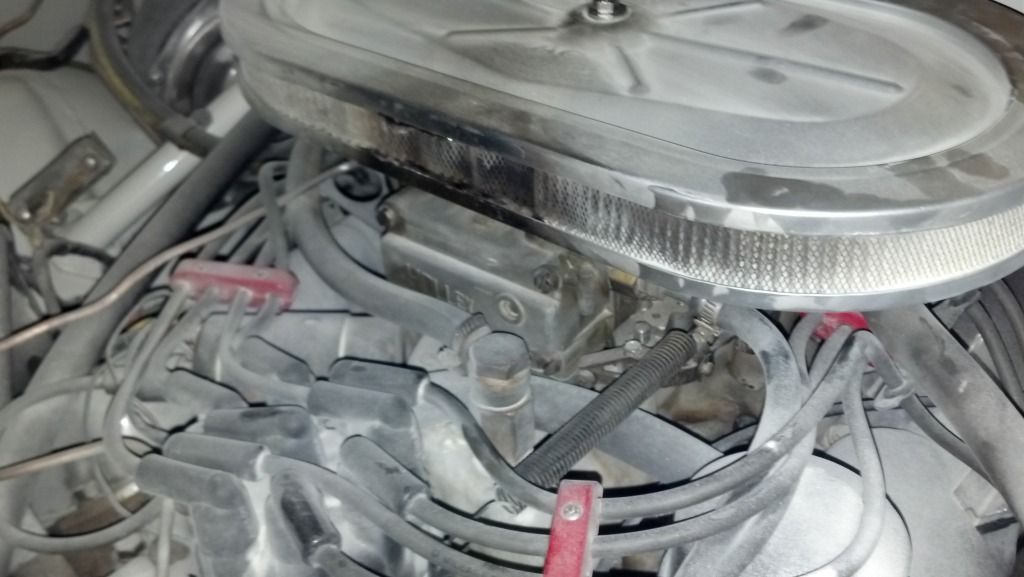

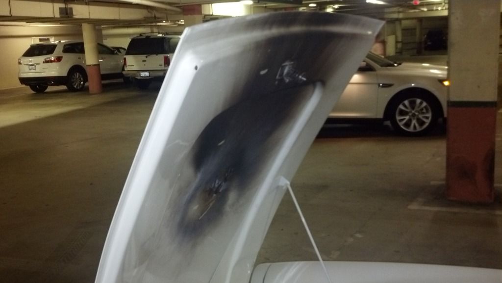

After driving all morning and then be parked for an hour, the car wouldn't start and after 3 attempts to start it, smoke and orange flames could be seen under the hood. Fortunatly a fire extinguisher was handy and the fire was out in two short bursts.
Looks like the fire was coming from the carb thru the air filter. What would cause this? what would spark close enough to cause it to ignite? What would be your first steps in diagnosing the isssue? Does insurance (Hagerty) cover this? Any comments are appreciated...here are some pictures.

Comprehensive claim. Halon fire extinguishers are no longer legal in the US but are extremely effective without all the mess of Sodium Bicarbonate, or dry chemical. PM me off line as I spent 22 years as an agent. Exactly why the re pop fiberglass air cleaners have been poo poo ed. You must have had some backfire or a leak and a source of ignition. It seems like the original air cleaner is lower than the neck of the carb, so gravity and spitting of fuel would account for that, or possibly over fuel pressure and/or failure of the float bowl needle valve. Looks like you are getting a new carb or at least a proper rebuild..

Sorry to see this, just one more reason why I don't like Holley's. I am sure they are good carbs, I just have had bad luck with them, switched to the Edelbrock carbs and love them.

Sorry to see that...had a very similar thing happen around '71 with an F4B and a Holley. Had just finished gassing up, started the Tiger- it started a little strange- next thing I notice is the paint in the middle of my hood starting to bubble! Good thing I had a fire extinguisher!! After I put out the carb fire, I was actually able to drive home. I never did find a leak. Must have been one of those Holley carb/backfire freak things.
