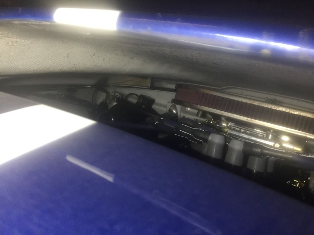

Here's a few images for you of the more-or-less stock mounting of a 5" booster. (not to mention one of those exceptional repop AC air cleaners!:D) I have what I believe is a CAT LAT bonnet.
Cheers, -Kevin
