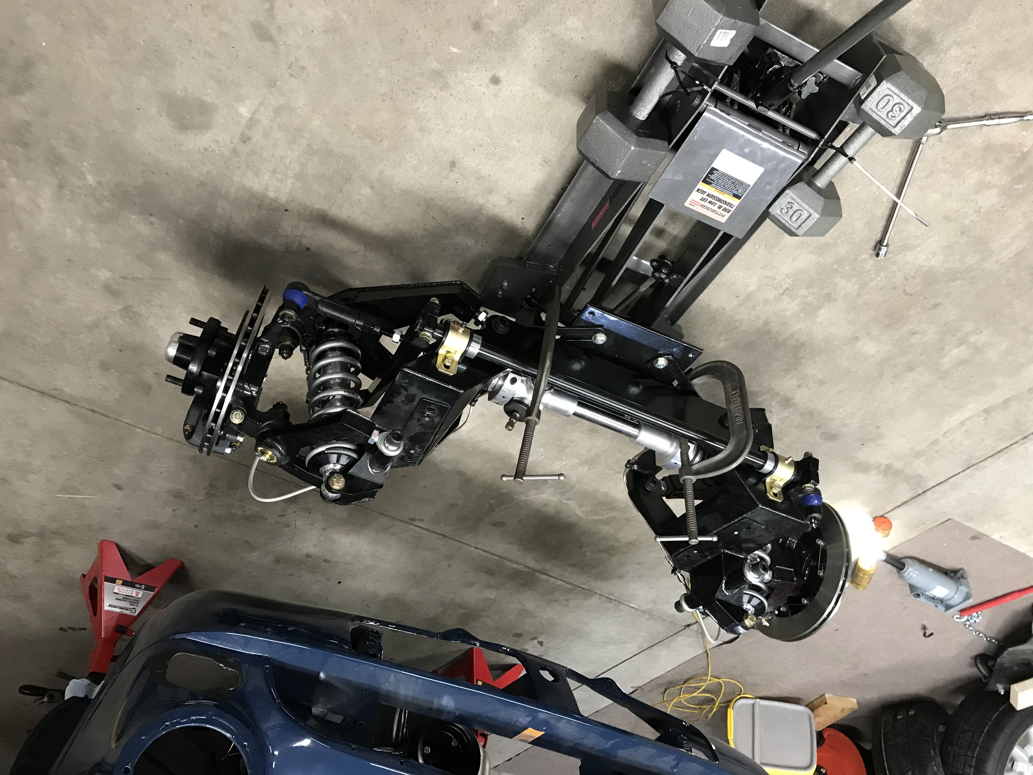

Just want to add that my car did suffer a driver’s front collision in the 60’s. I suspect that gave the front frame a slight twist, and since Dale’s suspension has a long tube from the bottom to the top of the crossmember a little bigger than the bolt diameter, it doesn’t cooperate with a hole in the frame at a different angle than the suspension. The factory suspension has a large hole through the bottom the bolt head fits through, and the bolt hole in the top. Much more friendly.
I also wasted a lot of time underneath the car trying to push the mounting bolt up with a socket that was on the deep side. Adding a nut inside it before putting it on the bolt helped me maintain some pressure. I also eventually used a tranny jack with a pivoting base to match the rake the frame rails have front to back. I had to get all these little things right to finally get it in. I hope any future needs to do this will go better. I also was working solo. Another set of eyes and arms would have helped.
No doubt once this guy is in it's staying put. If I ever have to pull the engine again, I'll go old school up and over the front of the car, 4 bolts for a bonnet and that's it....I wonder what the idea was with redesigning the mounting system from original seems the tubes for the bolts could have been the diameter of the socket plus some and it would have alleviated the painful install. Even though your cars been hit in talking to Dale the other day there's not a Tiger out there whose frame rails are to spec.
