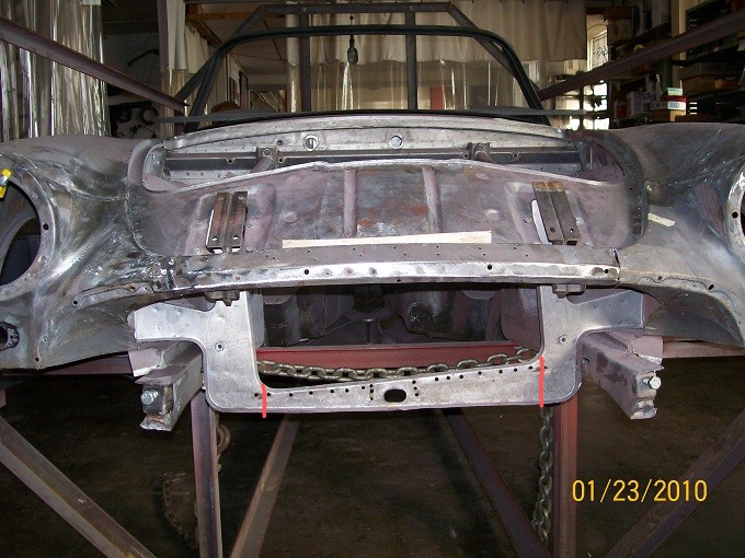

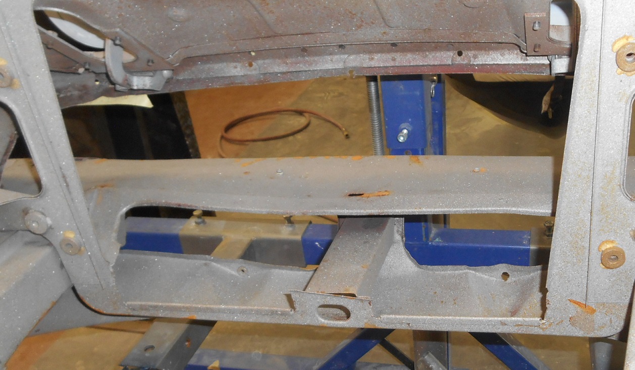

Early Tigers had the lower section of the radiator support panel opening enlarged by Jensen, no doubt to assist with air flow. This was done with a gas torch, similar to the removal of the transmission tunnel.
At some point, and it may have coincided with the introduction of the oil cooler brackets on the front valance, this enlarging procedure was deleted. In an effort to work out at what point this occurred could any owners of cars post B9473292 please let us know how their car is configured? I'm referencing that particular chassis number since it's a car with original sheetmetal, the opening cut out but no cooler brackets.
Thanks guys for your assistance.
