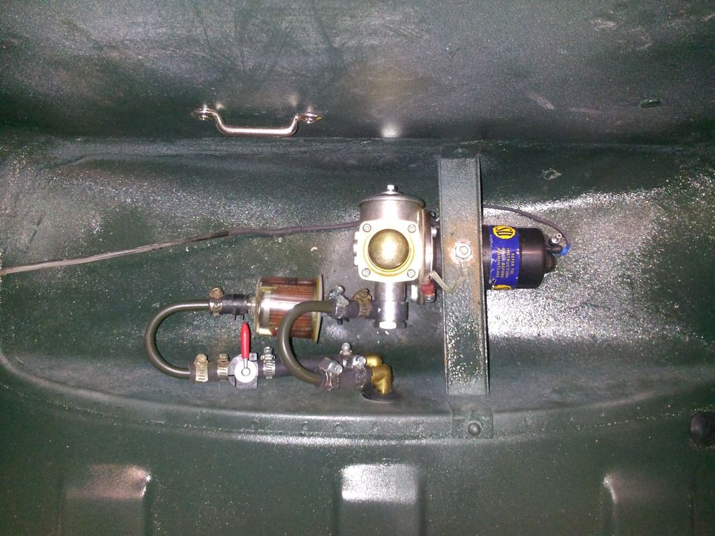

Here is my finished setup with a shutoff valve so I don't have to drain the tanks if/when the fuel pump dies. Also have a spare pump, because you just know it will fail at the worst time or place.

I would have put the filter before the pump.
Filter before pump, stock location?

Can anyone share how/if they've done this at the stock (under shelf) location. I've seen many with the conversion to spare wheel well, which is a sensical consideration (ez access and further away from exhaust), but I'm less sensical.
I know. I wanted to put the filter first. But the tire well was too shallow to stand the filter up. I almost laid it sideways before the pump but then I was out of room for the pump in the well. I could have made the order: filter, then valve and pump. But then I would have to drain the tanks to change the filter element. Another solution would have been to put the valve right at the center tube where the fuel line attaches. But it would not fit without cutting to make room. I also could have used a short inline filter with a metal mesh screen but that doesn't catch the really small stuff.
Compromise is the key. The motor is the more important element to have the fuel clean for.
