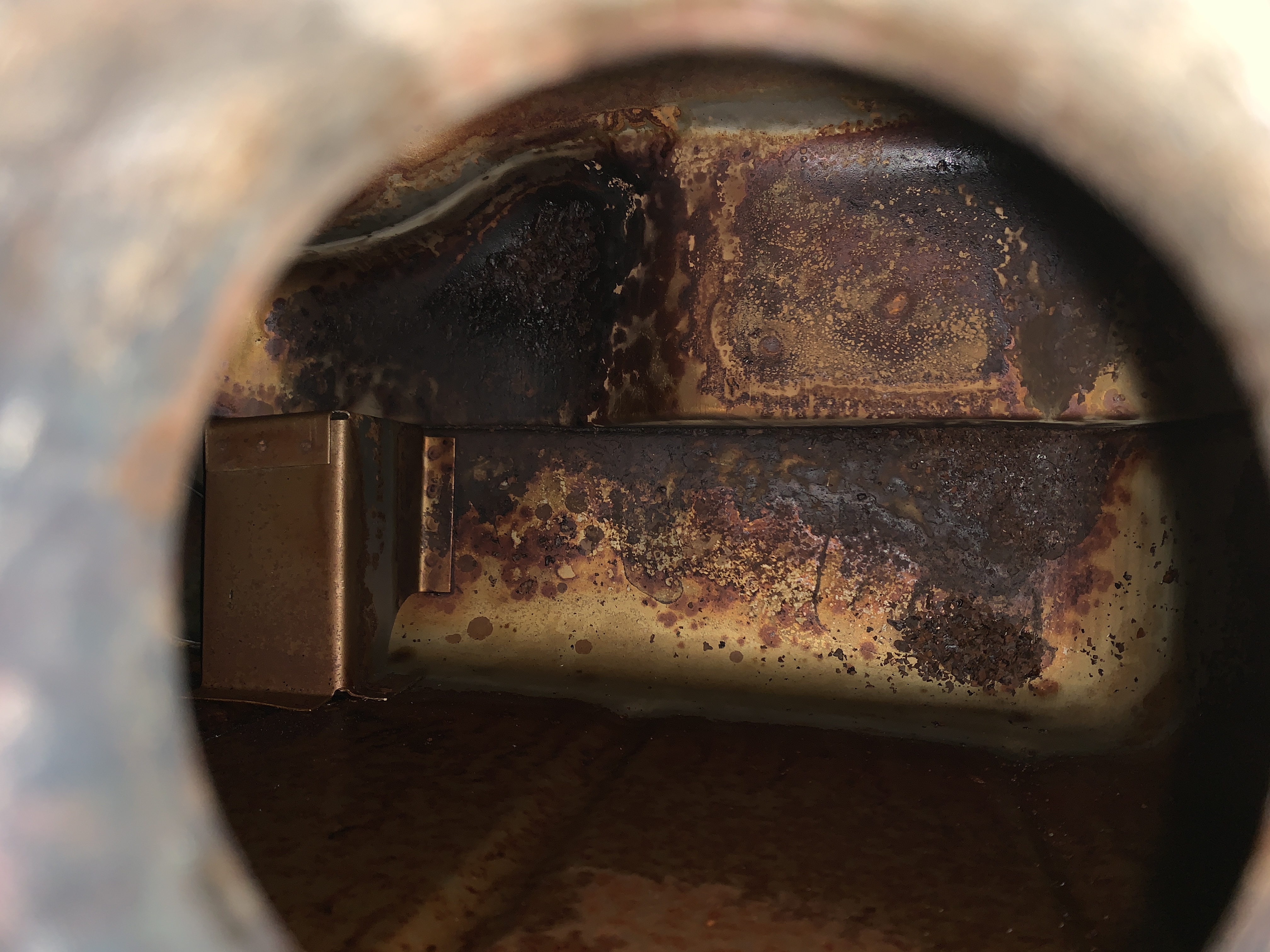

I don't know why they are epoxy coated inside when most gas tanks of the period are just bare metal. Did your service remove the epoxy? In the motorcycle word everyone almost always turns up their nose at a gas tank that has been epoxied. My driver has Re Nu product in it done in 1999.

Factory inside epoxy coating? They must have skipped mine. :)
Did read a few other threads about to coat, or not to coat. Kind of leaning towards a good cleaning and just keeping the tanks full of that good ol' crappy California gas. Heard bad stories about flaking, etc., of various coatings, although there may be newer products out now. Maybe when I get them back I'll slosh a bit of Ospho inside to keep the flash rust off.

A good idea when they are back is to insert some chain or nuts and bolts with fluid and give them a good rattle and again. So any corrosion on the bare tanks will be removed before fitting

As for the tanks if I had a dollar for every time I read a motorcycle gas tank cleaning ? on my motorcycle forum, I could pay Sunbeam Specialties. I have done nearly all methods looks like a Evaporust product may do your as it concentrated near bottom of the tank. A SAOCA member used some high strength toilet bowl cleaner and that's a new one to me.
