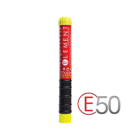

Also ,think I've posted this before.. but the Element sticks are a great option ..very light, easy to store in the car and don't cause the damage traditional extinguishers do.
