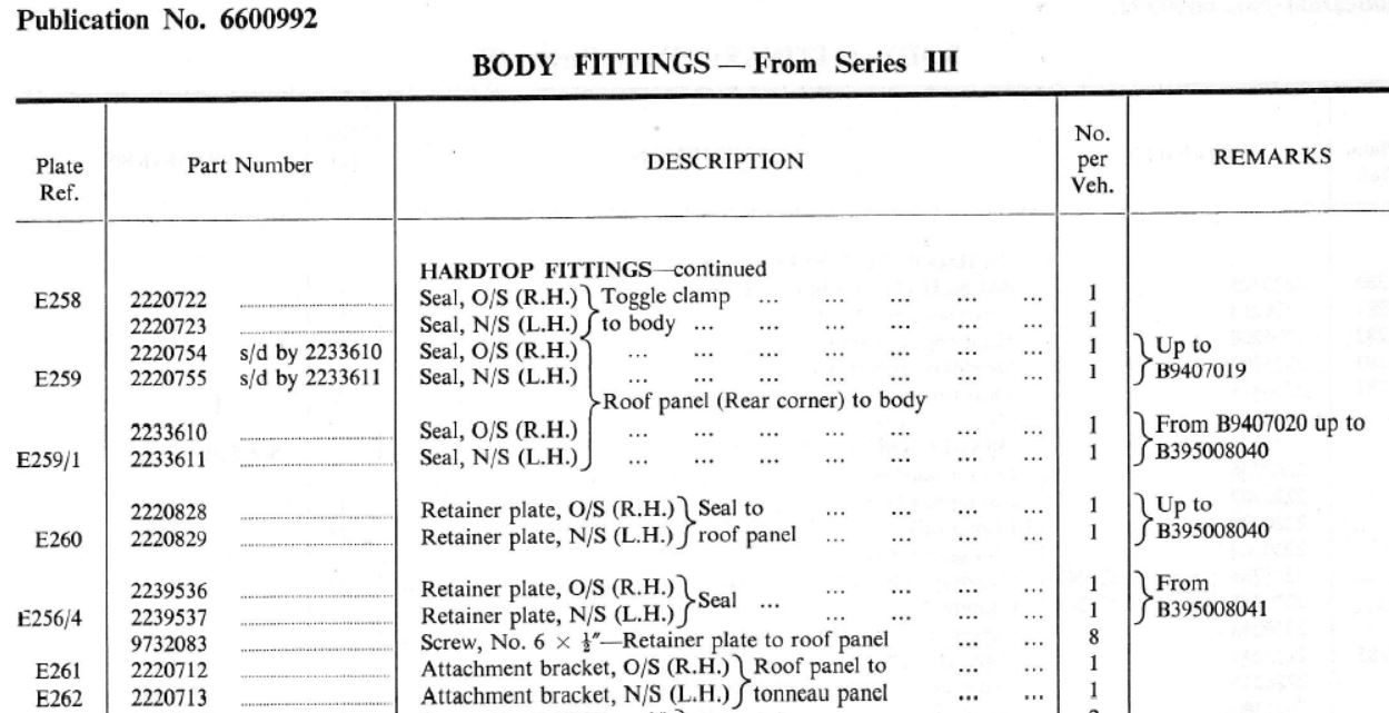

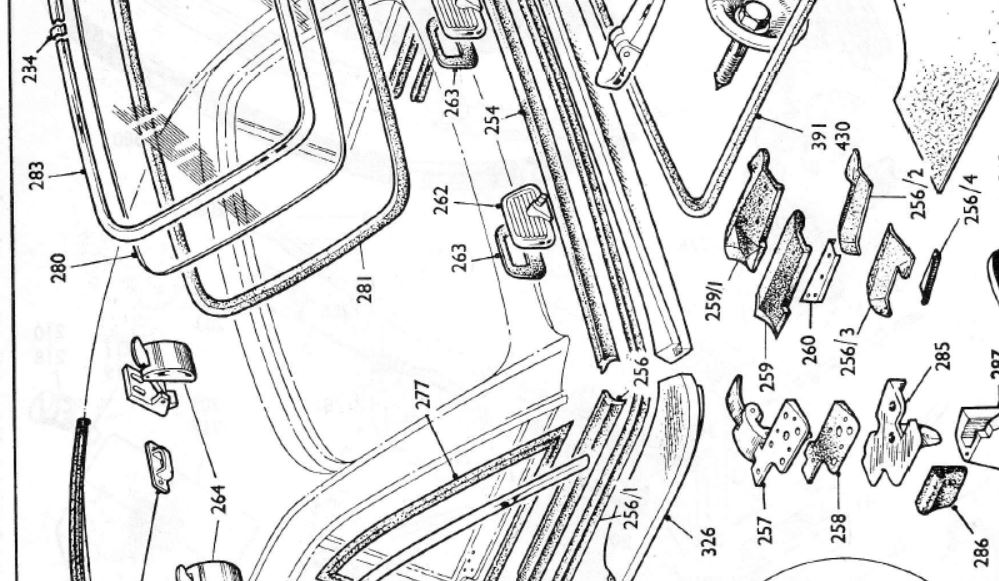

Whoever put the all of the 6 tops I had, now I think about it did things differently. Note 256/4 in the parts blow up, that's a completely different metal shape. The holes are also different on that metal corner piece holder possibly the later ones that may require trimming of the corner pads. As always change is always constant.

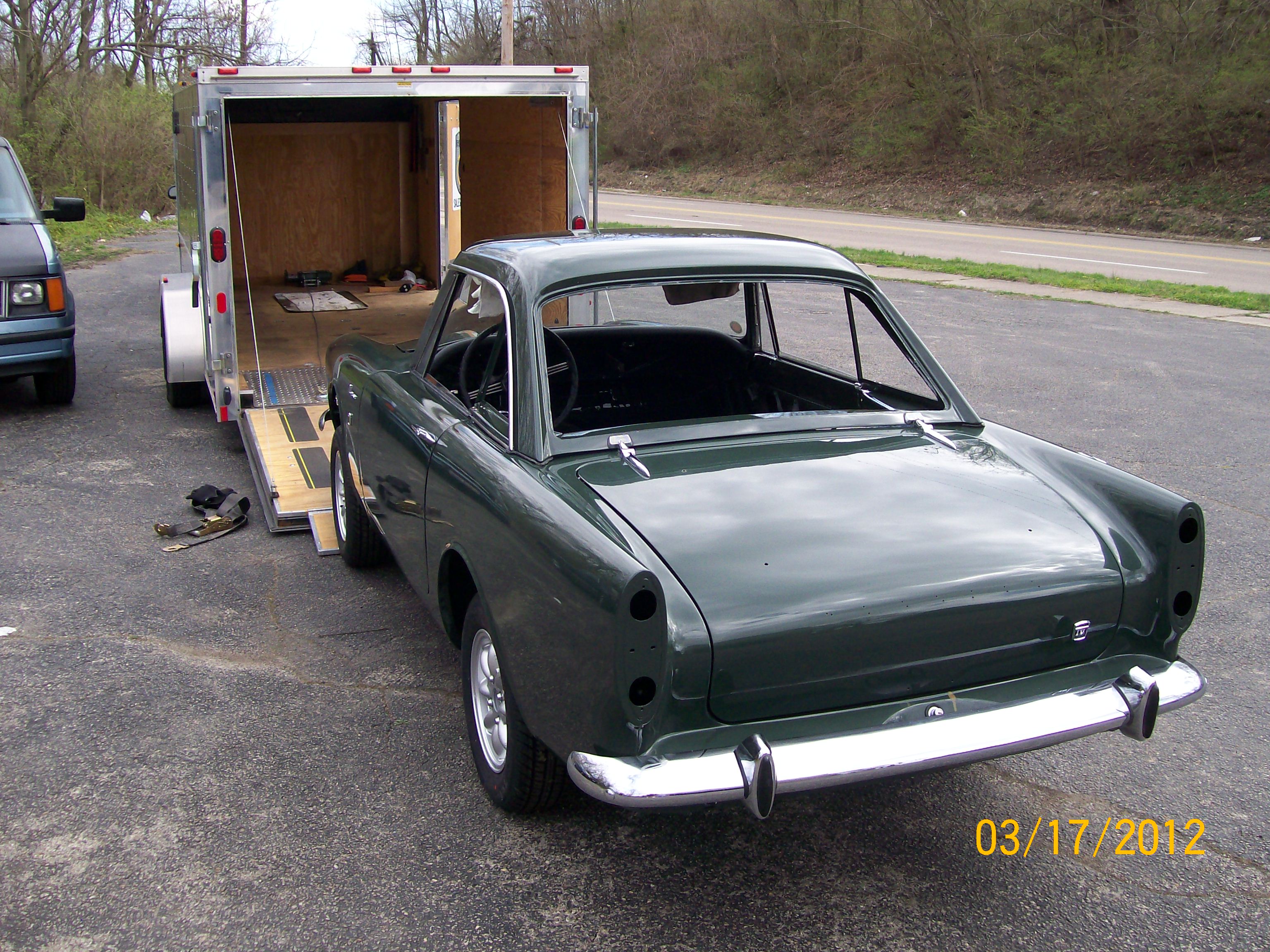

My car still has the footprint of the top carried by the PO as it came from the S.F. Bay area. Never bothered to cut and buff them out as the tonneau did about the same thing then I'd have to respray the car. Got 4 seasons and a 4 season car and no car trailer, maybe you need a hard top, I don't yet.

I'll snap a picture of 256/4

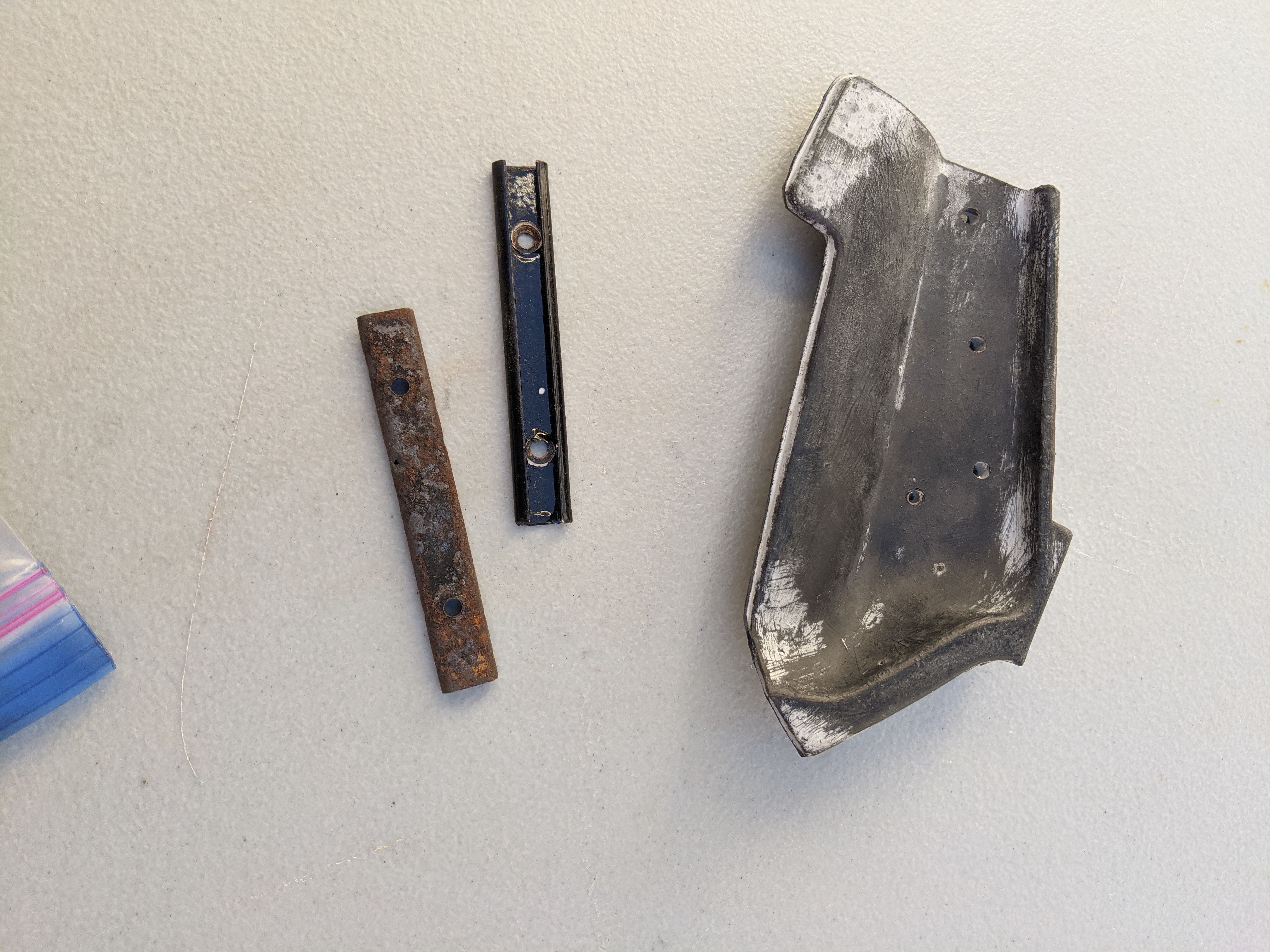

Here's a snap of 256/4
That must be a newer one. Mine have raised letters reading CAT molded in the rubber. How old are the ones I have?
I included the SS corner pad for size reference only.

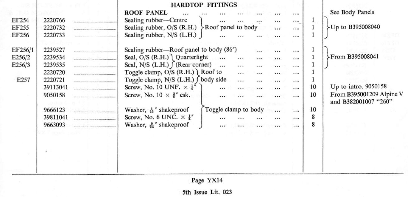

I got one h/t as a basket case but these appear to be the odd ball 265/4 per Dave's picture. It seems the exploded drawing is a mash up for several series cars/tops , maybe...

I cannot see in the previous body diagram what size the 6 small threaded screws that hold the leading edge of the side quarter windows to the B piller of the hardtop. Any one know ?
