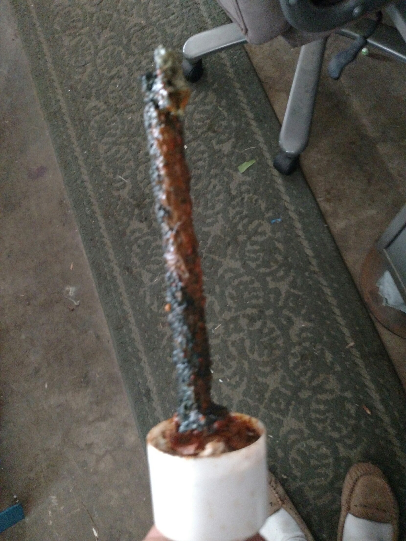

Look at the crap that is attracted to the annode .

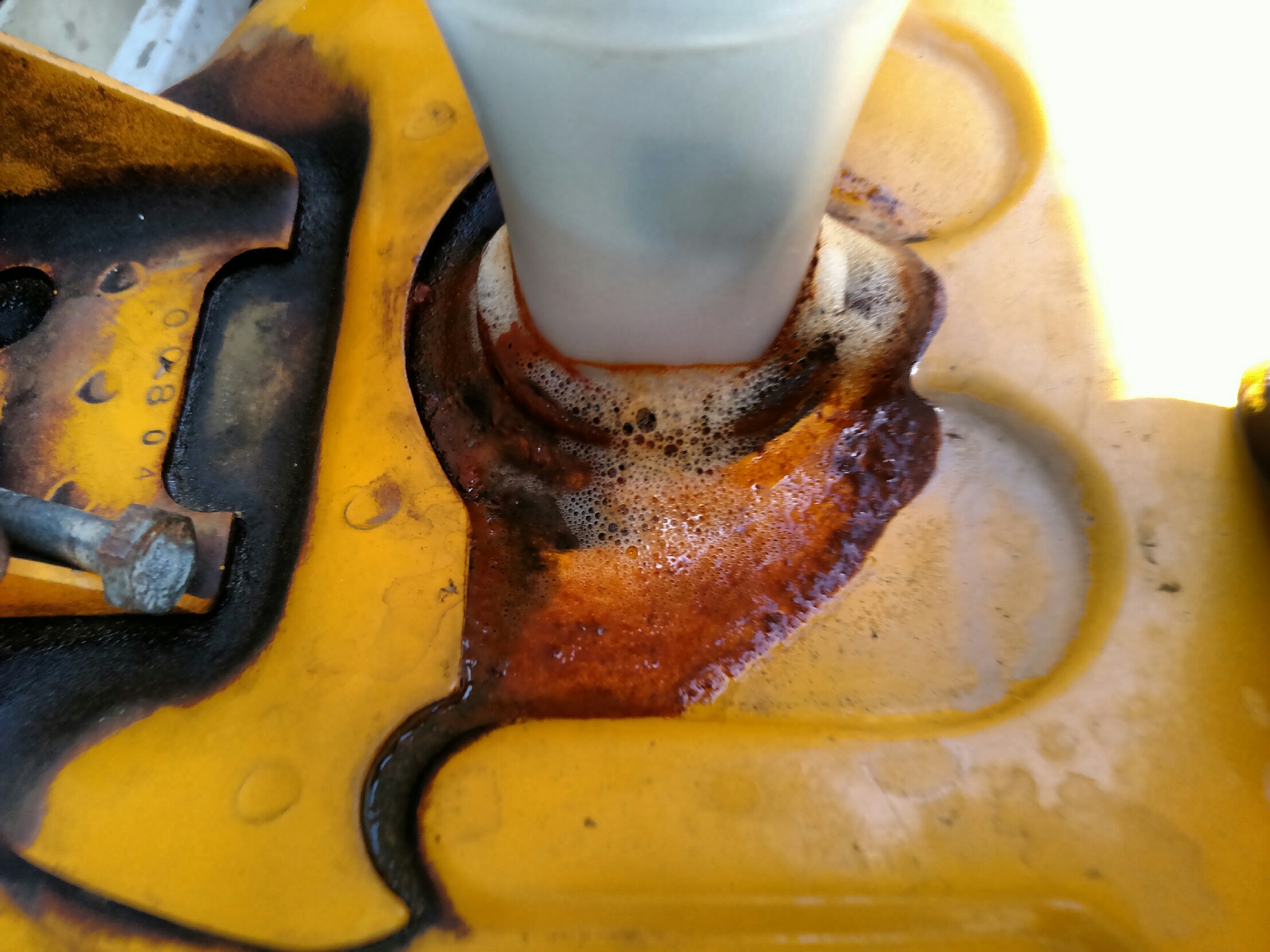

So for the inside of a gas tank, it seems that one would need only to fill the inside with the solution, and suspend the anode inside the tank?
Leaving the powder coated exterior untouched!
How much current?
Slosh around some Bill Hirsch tank liner and done!
10 amp
Exterior paint should be fine. Most every tank is bare steel . I've never bothered with any coating on the inside. There's a pile of online guides from motorcycle tanks tractor parts.
How do you know
It's working, see pic. Pardon the CT90 tank pictured cause it's on the mend.
