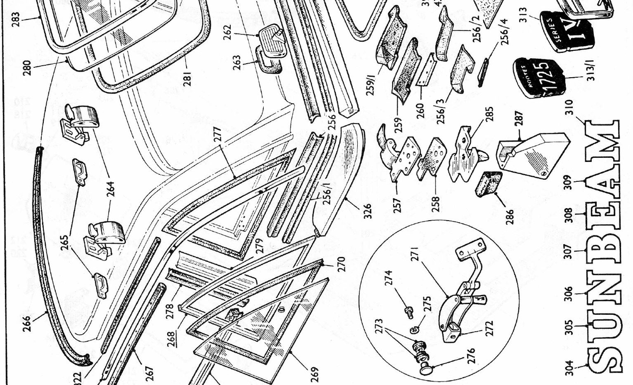

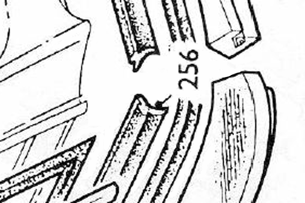

The hardtop to body seal from SS (HT61) has a long and short leg.
Does the long or short leg go towards the outside?
Thanks, Ken
Long Leg on Outside
According to the parts diagram in the Rootes parts book for the Alpine, it appears that the long leg is towards the outside and the short leg is towards the inside. The first photo is a snapshot of part of Plate E - Section YX of that parts book. The second photo is a zoomed-in view showing the cross-section of the seal. I hope this helps.
Thanks for that!

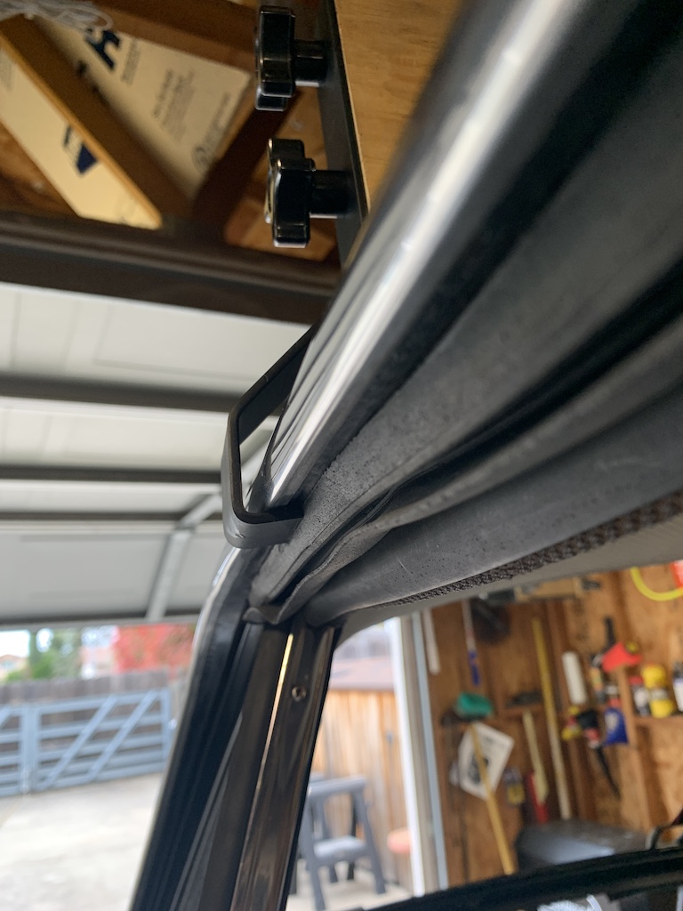

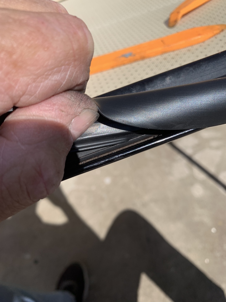

Just an observation on the hardtop to windshield piece (HT50) which fits into the channel and around the front edge of the top, I found it easier to fit the rear side of the channel first, then peel back the edge and jam the front edge into the channel. Plus you can see if rubber is really in the channel as its suppose to be. No glue or soap needed, but does take some patience. I tried doing edge and front of channel first, then rear, but that just wasn't happening. Just in case some frustrated soul searches for this in the future.....

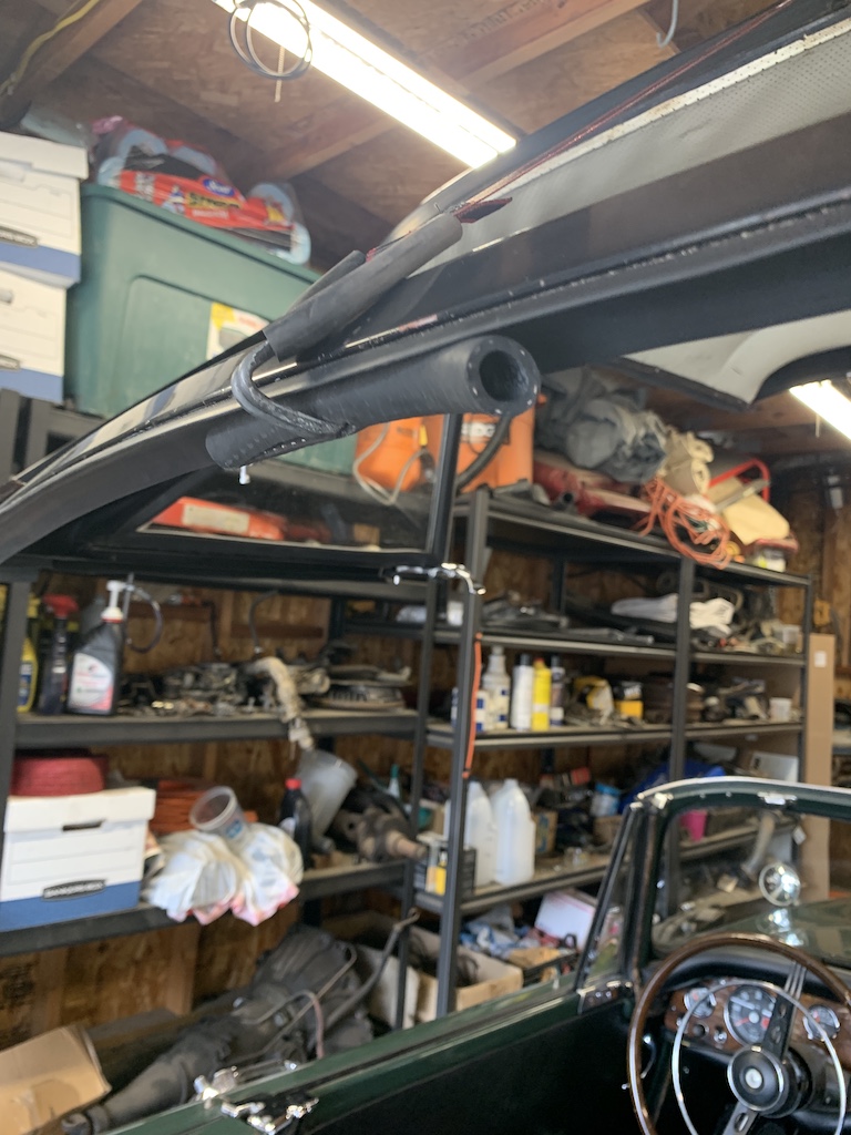

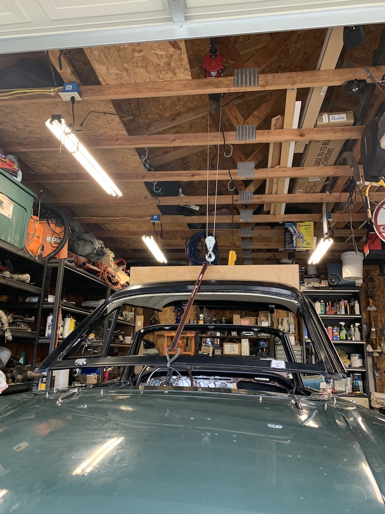

Hardtop Lift System
Spent my quarantine time :rolleyes: building a lift system for the hardtop. Mounted a $80 electric hoist from Harbor Freight in the rafters. Built a roofline hugging felt lined wooden beam with metal brackets on the side to hook beneath the gutters, along with a strap to hook underneath the rear edge to stabilize.

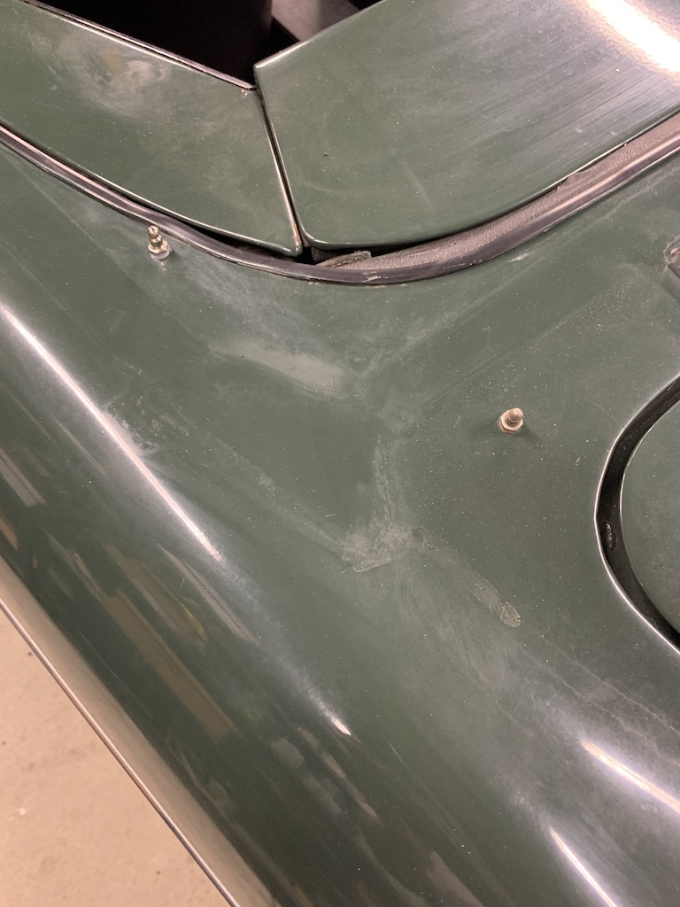

Yes the fat rear pads are an issue, trimming them is required. Whats the paint like on the body there the hardtop sits?

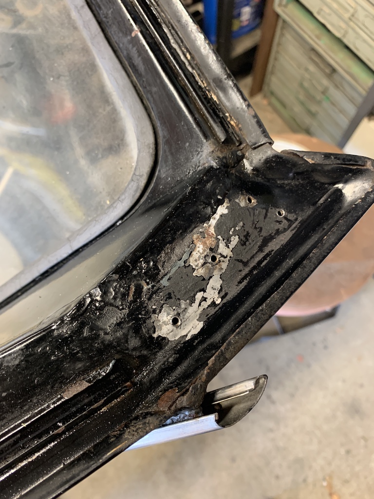

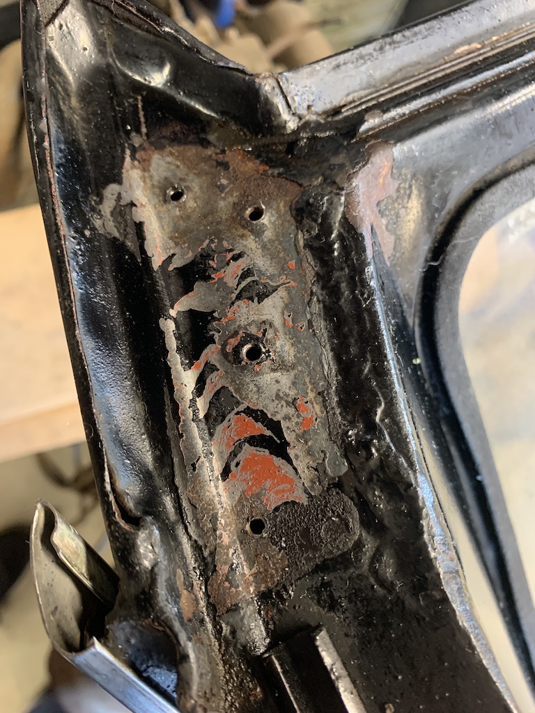

Pad areas looks quite well actually. I haven't buffed the paint out yet. The hardtop metal looked pretty good too, I prepped and POR-15'd a few spots and seams. I guess I'll get my cheese grater out and do some trimming. :(. And those B pillar pads are like hard neoprene instead of rubber.
