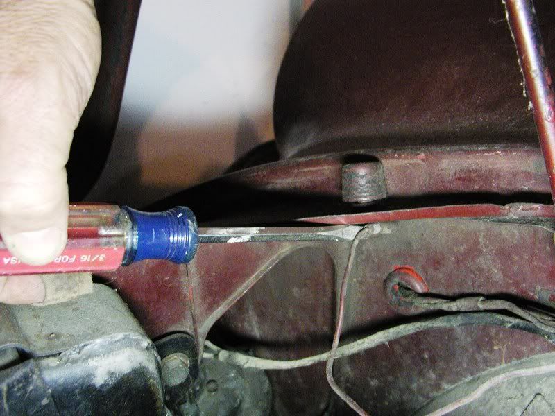

The bodyshop took my headlights out before I had the chance to last year---my problem is that I can find 2 wires in the engine compartment yet there are 3 wires on the headlights. Where do they go ???? Thanks.
in the engine compartment:
connected to the headlights:
There should be 2 blue wires... one with white stripe and one with red stripe... That's the high and low beam... wiring diagram shows third wire going to ground. Mine is grounded right by where the wires go through the fender IIRC .
DITTO
Some of the black grounding wires ended up being screwed to the inner fender. Your existing bullet connector should fit into butterfly ground connection just under the forward bonnet rubber buffer.
