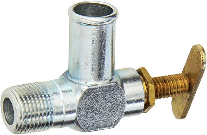

Heater system emergency shutoff
Here's what I just installed to quickly solve any heater system leaks in the future.

Healey?
Cool Tom , that's way more elegant and easy then my emergency kit Home Depot plug. Is it from a big Healy and Moss Motors?

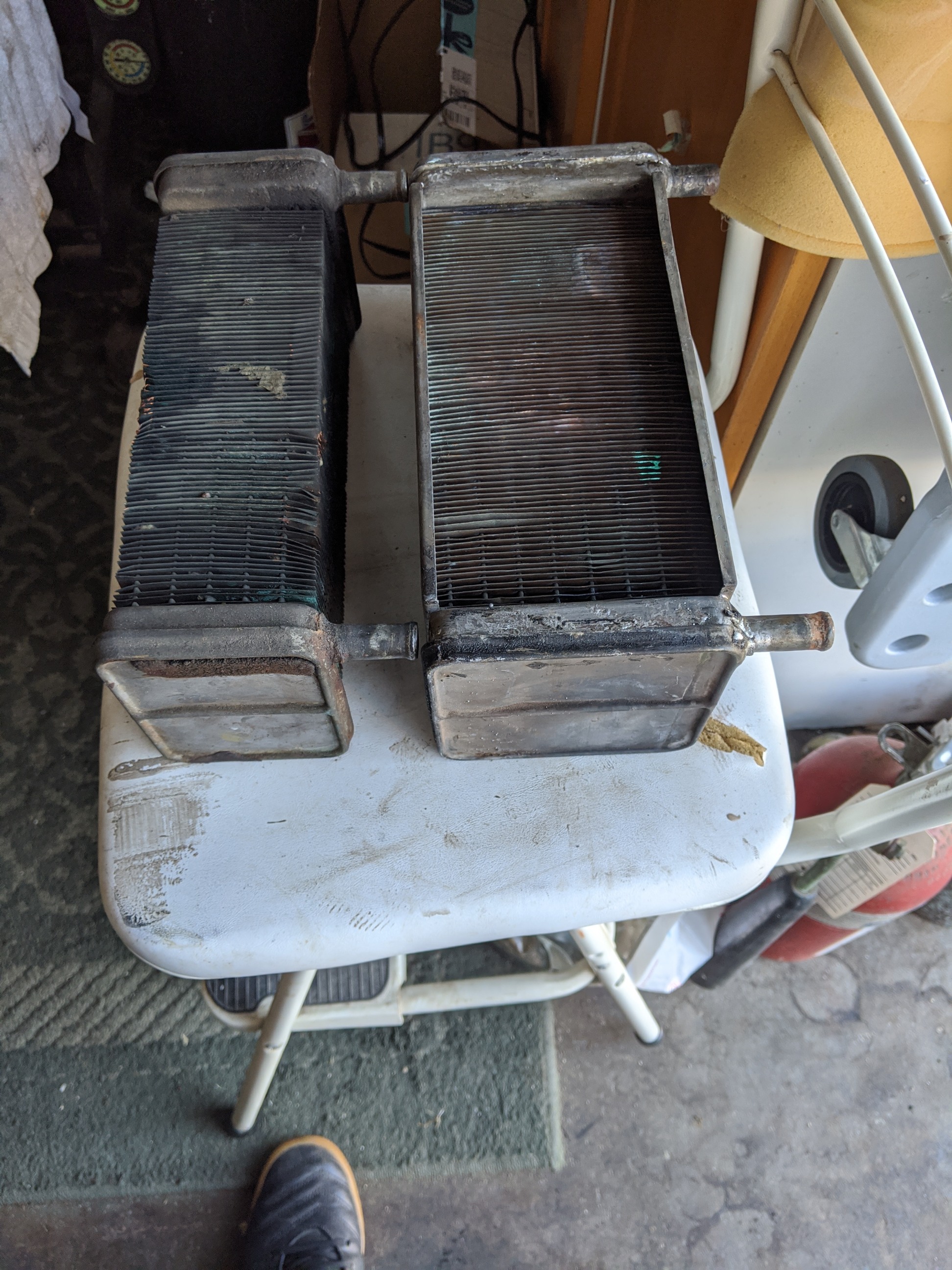

But for those of you considering El cheapo heater core here's a picture of an MG version next to the stock Tiger Alpine one
