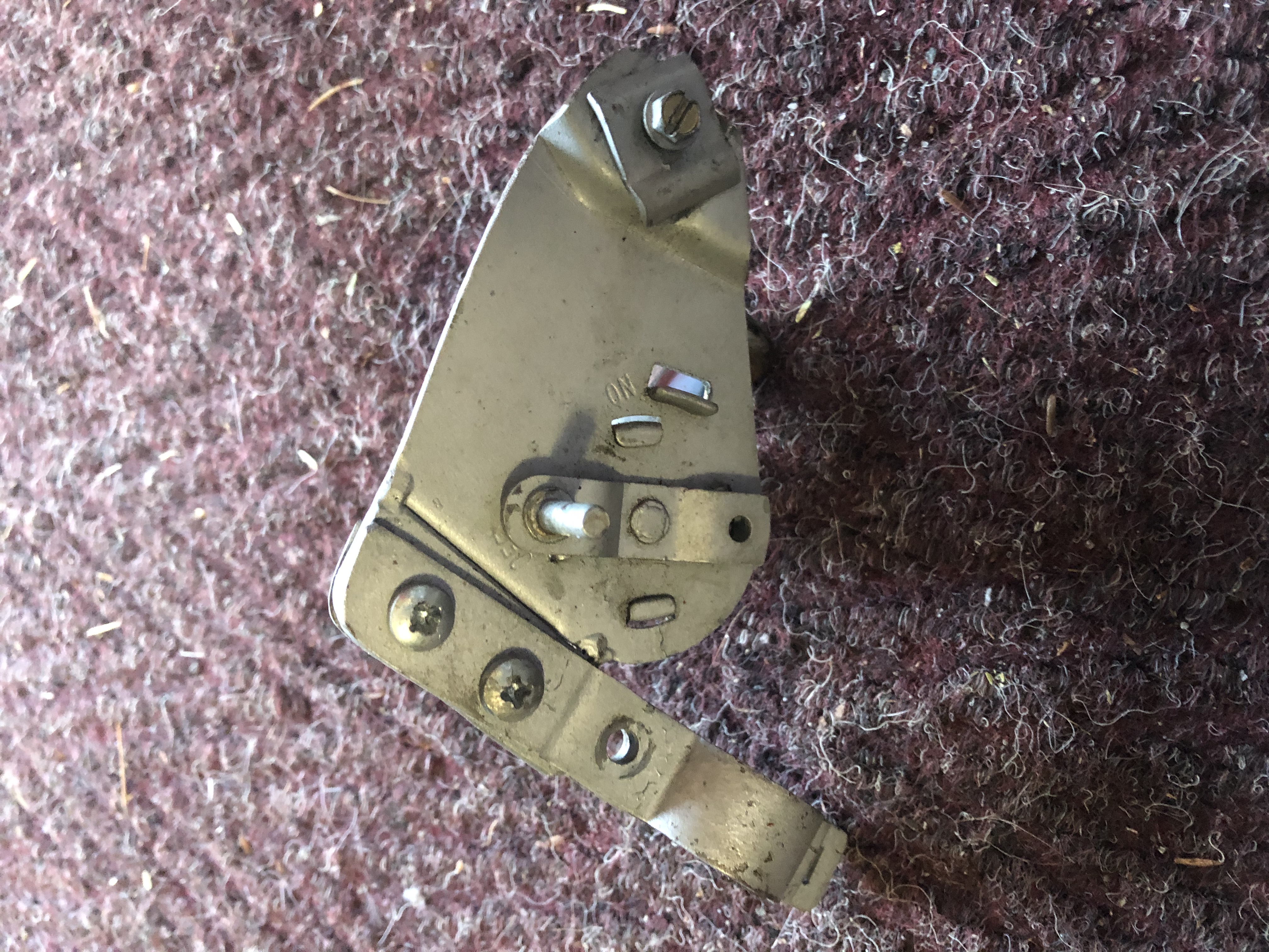

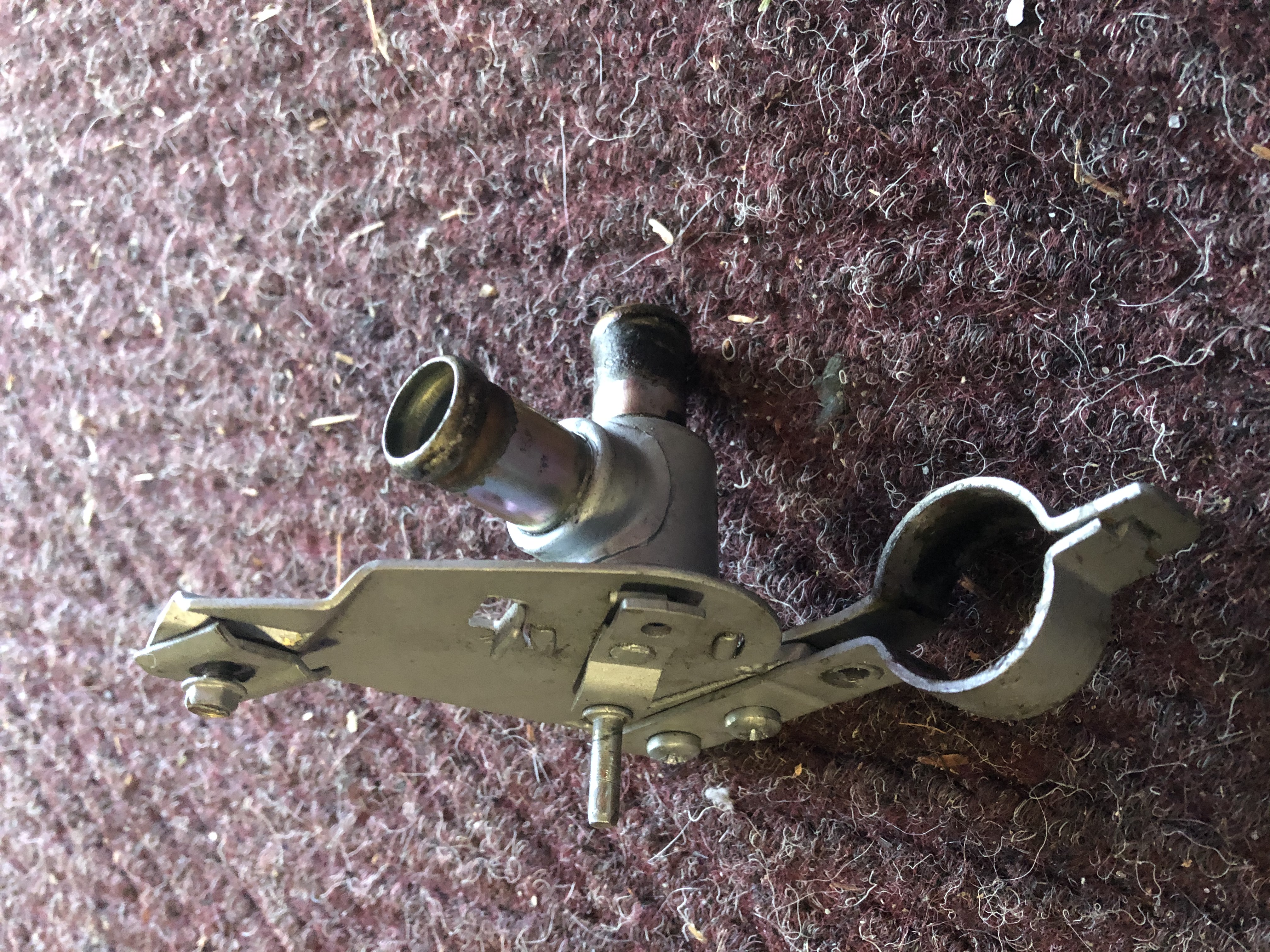

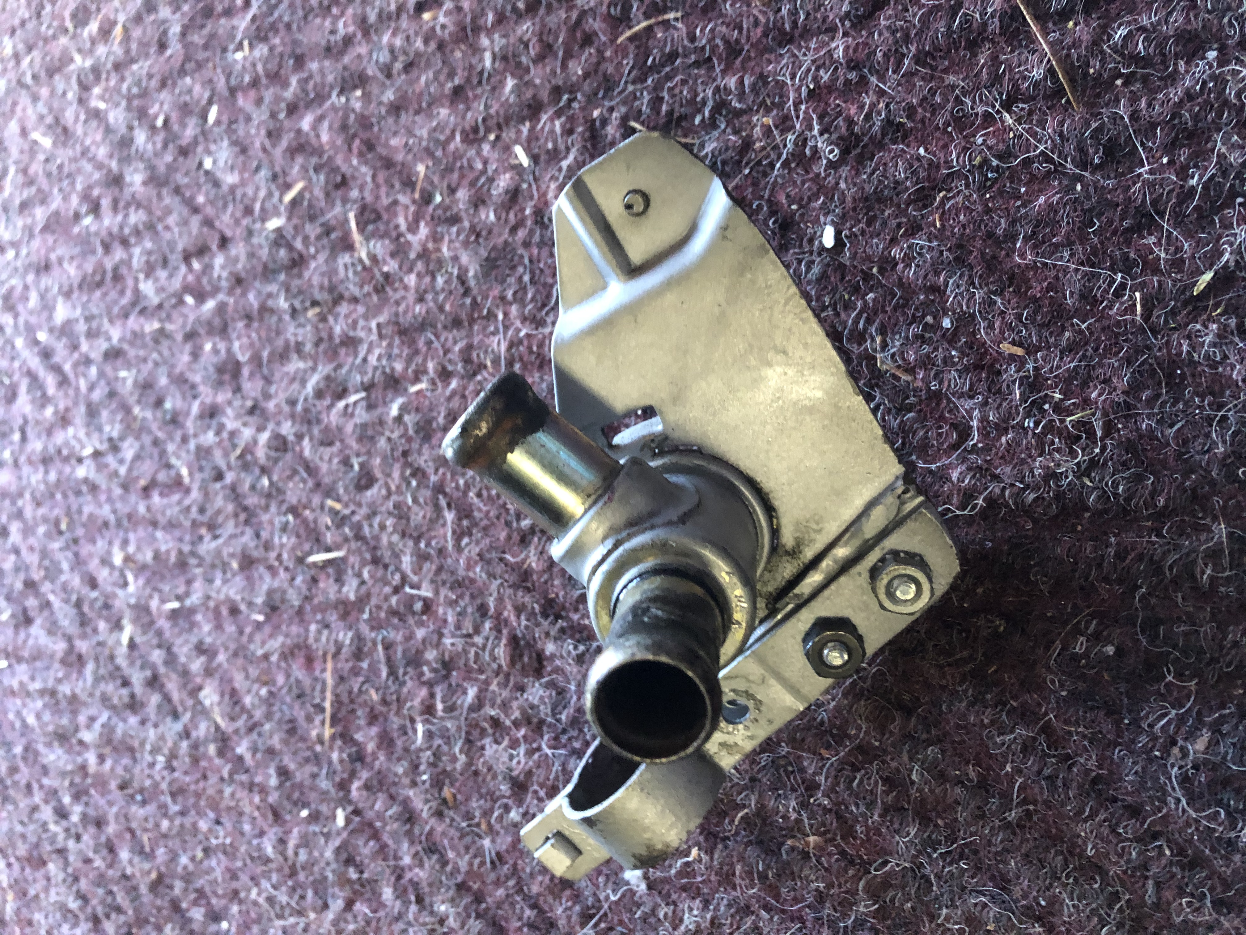

MK1a Heater Valve
I just removed this incorrect heater valve from my MK1a during my radiator, heater core upgrade. It works backwards. Open when dash says off.
Can anyone identify it?

heater valve
The valve looks to be a Honda item from the 80's. This was widely used on Sunbeams due to the lack of original valves and still is being used by many owners.
