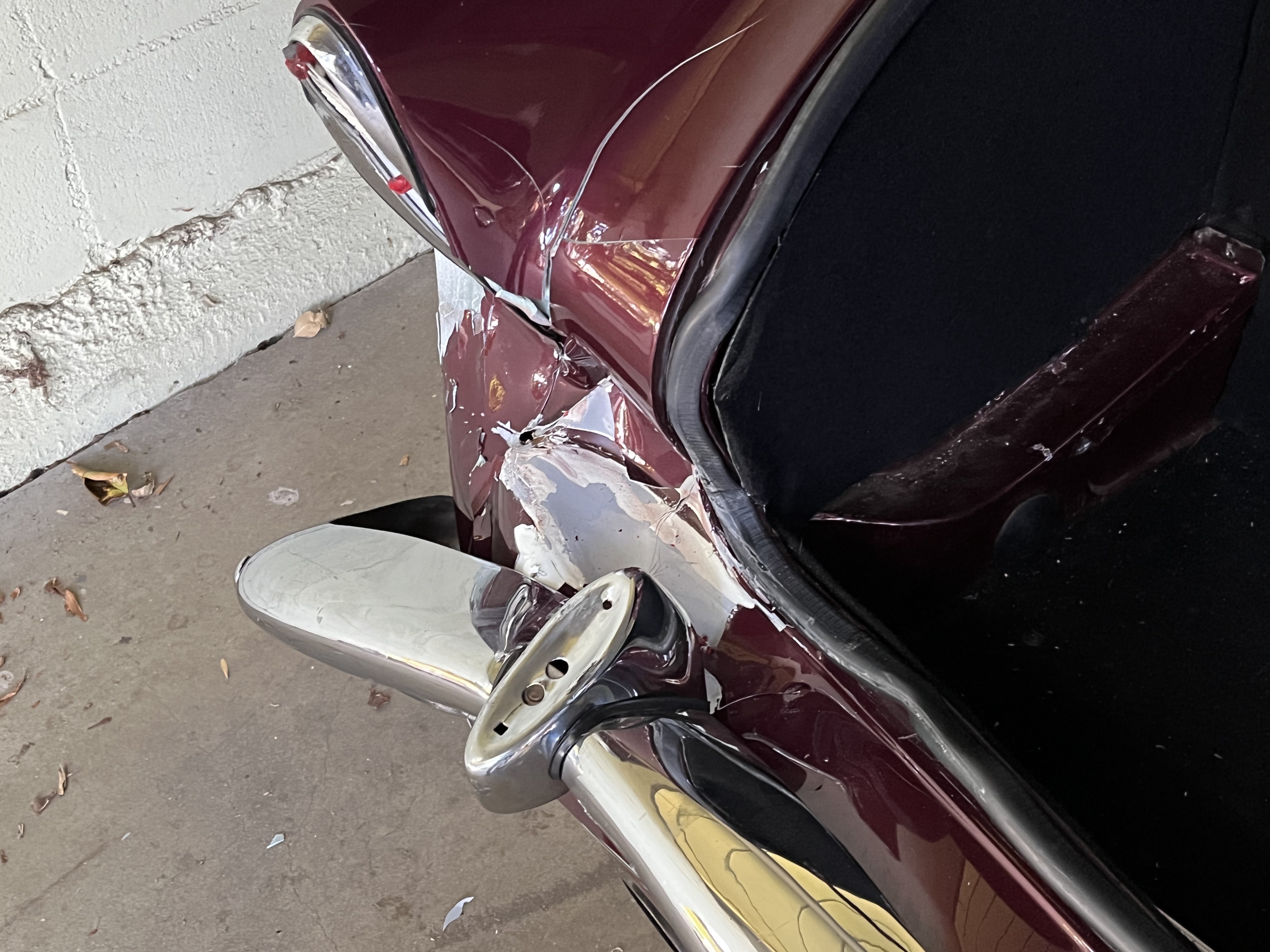

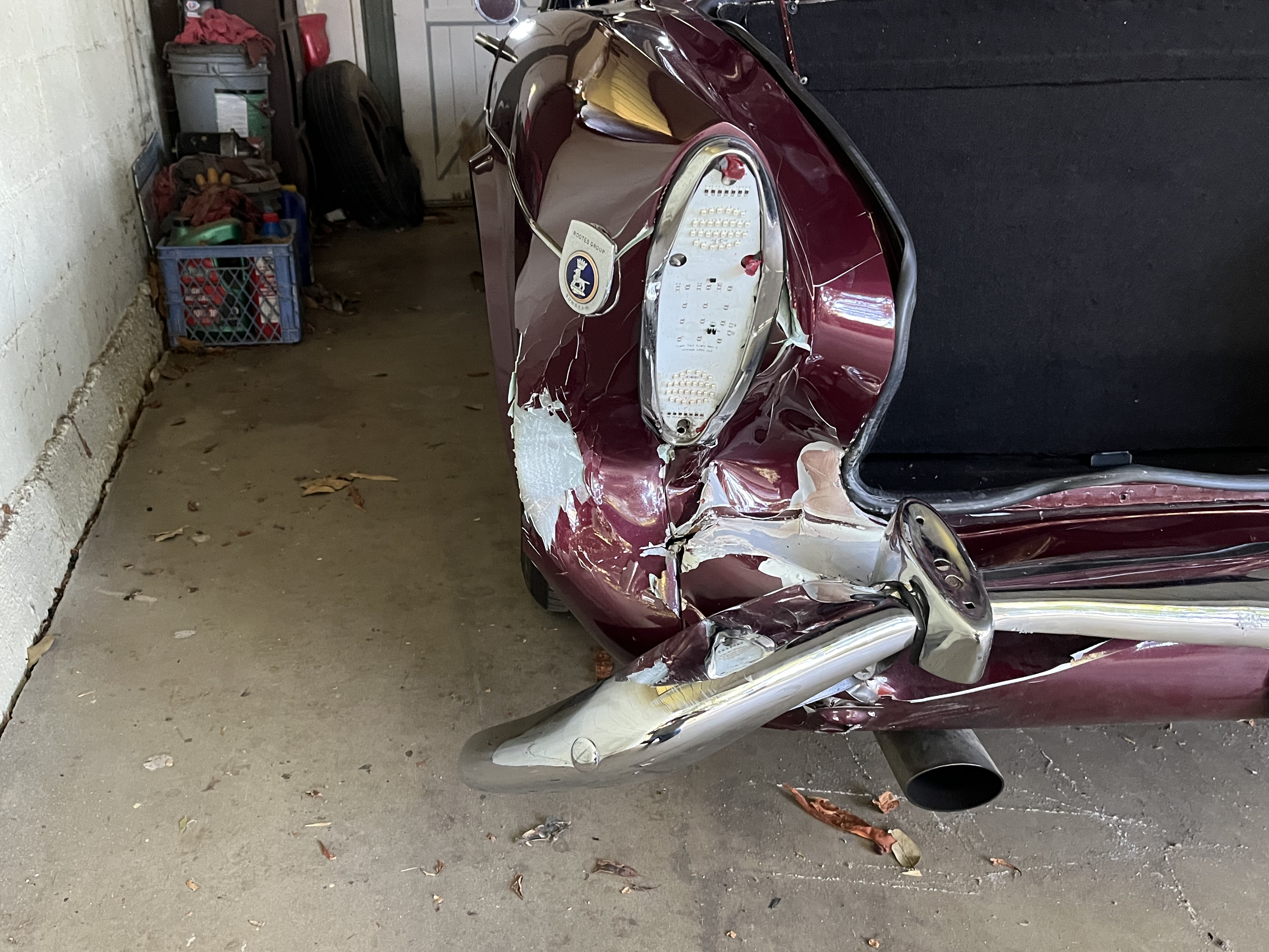

Bad shock, crash damage to left rear, trunk and more. I’ll be looking for help and advice for repair locations. The shock also took out the dash gauges! No fuel, temp or tach functions. Facebook connections have let me know original body builder, metal flares. The bumper, also custom, will be repaired…I hope and plan on making happen.

Likely just knocked the ground out or blew one of the fuses . Don't remember if there is a fuel cell there. But all the wiring could be mashed too.

Do a rigorous look at how far the shock and gone up the body.. Look for dimples and wriplles... Probably needs to go on a table to see how twisted things got

Agree, with checking frame on frame table for 'straight' - most important part to find out now before replacing any panels. FYI, having rear quarter clip replaced should be turn out well. FYI I had to replace rear quarter clip replaced in 2017 which turned out very well (frame was fine, just horrible prev. body work/repair/poor welding/etc. on bpost, wheel lip and tail light housing -easier to replace the entire clip than piece repair in my situation) - cost me around $7k including parts/labor from memory (not including final paint)

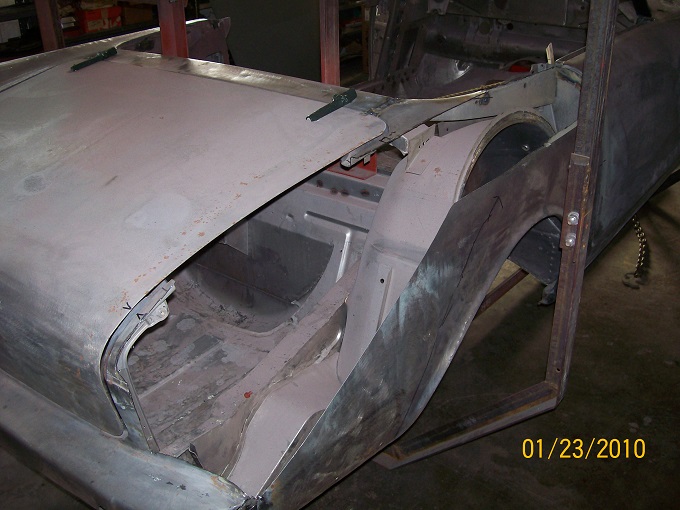

The biggest problem is drilling the spot welds if you remove a rear fender as was done to one of my cars.
The biggest problem is drilling the spot welds if you remove a rear fender as was done to one of my cars.View attachment 16176
well, I usually replace the qtr in its entirety. doing it the way pictured will lead to massive warpage issues. looking at the amount of damage, the car likely will need at least the outer half of the inner wheelarch as well.
I agree that replacing the wing is probably the best thing to do with the crunched tiger fender that started this thread.. In the case of my car there was a reason to replace only the upper portion. All of the body panel section left was rust free and dent free so there was no reason to replace it. The person that did the work on my car has been doing restoration work of Tigers and Alpines for several decades so there wasn't any warpage. This work was done at Tiger Auto in Dayton. The car in this photo was bought in the bay area and had the right front frame rail so twisted that a shop in the San Francisco area redrilled the front cross member to bolt it in without straightening the rail. Doug resolved those problems when he restored the body. Interior is a Martha creation. As I mentioned, drilling any factory spot welds takes time.
