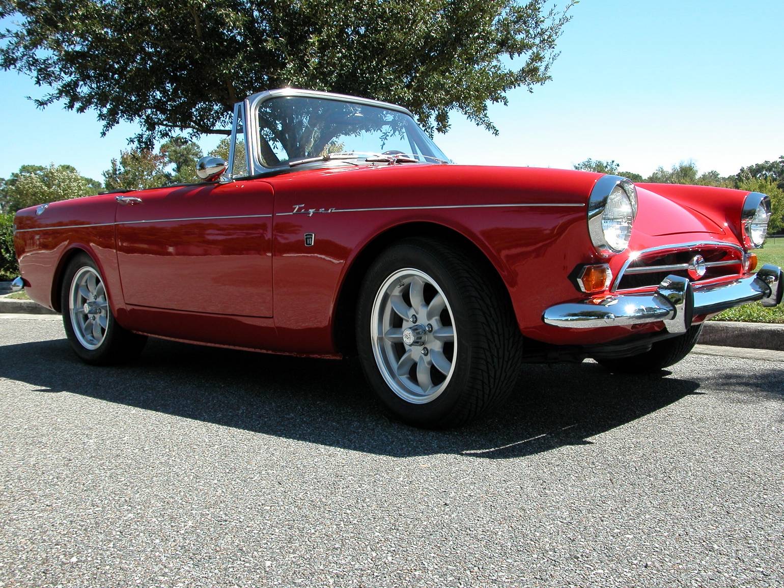

Hello Everyone...glad to be back as a member of CAT. I just purchased a 1966 Mk IA and looking for a great mechanic in San Diego. Preferably in North County but anywhere will do. Thanks for your help.
Sure is shiny and only a bit personalized. Smitty & John are south of Ya down on K street. I met a couple more In the SD area but can't recall locations or names at the moment.
There's some guys in Escondido plus a very trustworthy guy in Fallbrook, but he's a fabricator first. Looks great what could be needing attention ? I'm in the Fallbrook area a lot .
Smitty is Mr. Sunbeam to San Diego but that makes him awfully busy. On K street around 30th.
It's been sitting for a few years. Brakes. Oil change. Speedo, Oil gauges don't work. Rear running lights not working. Hopefully all minor.
