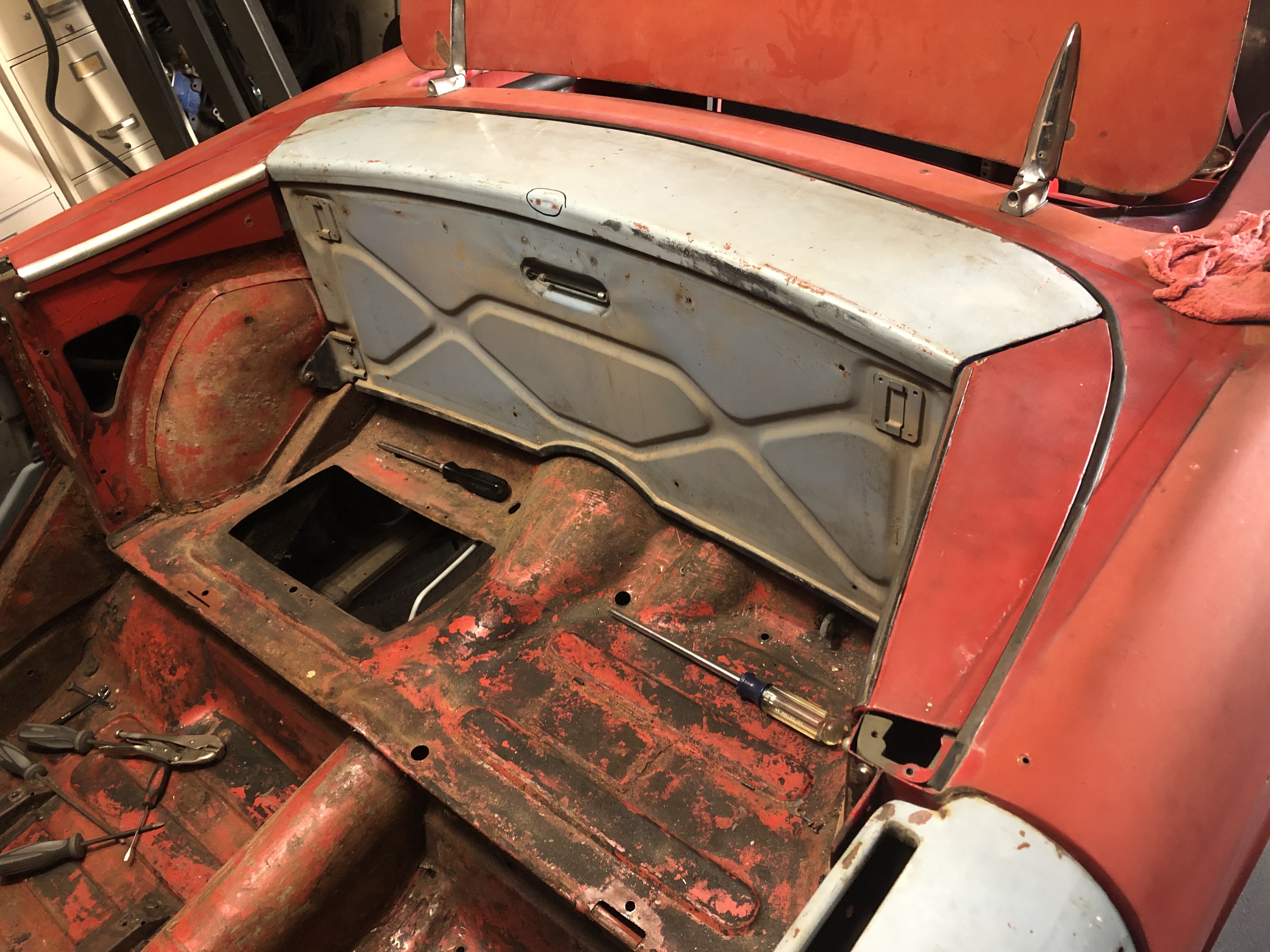

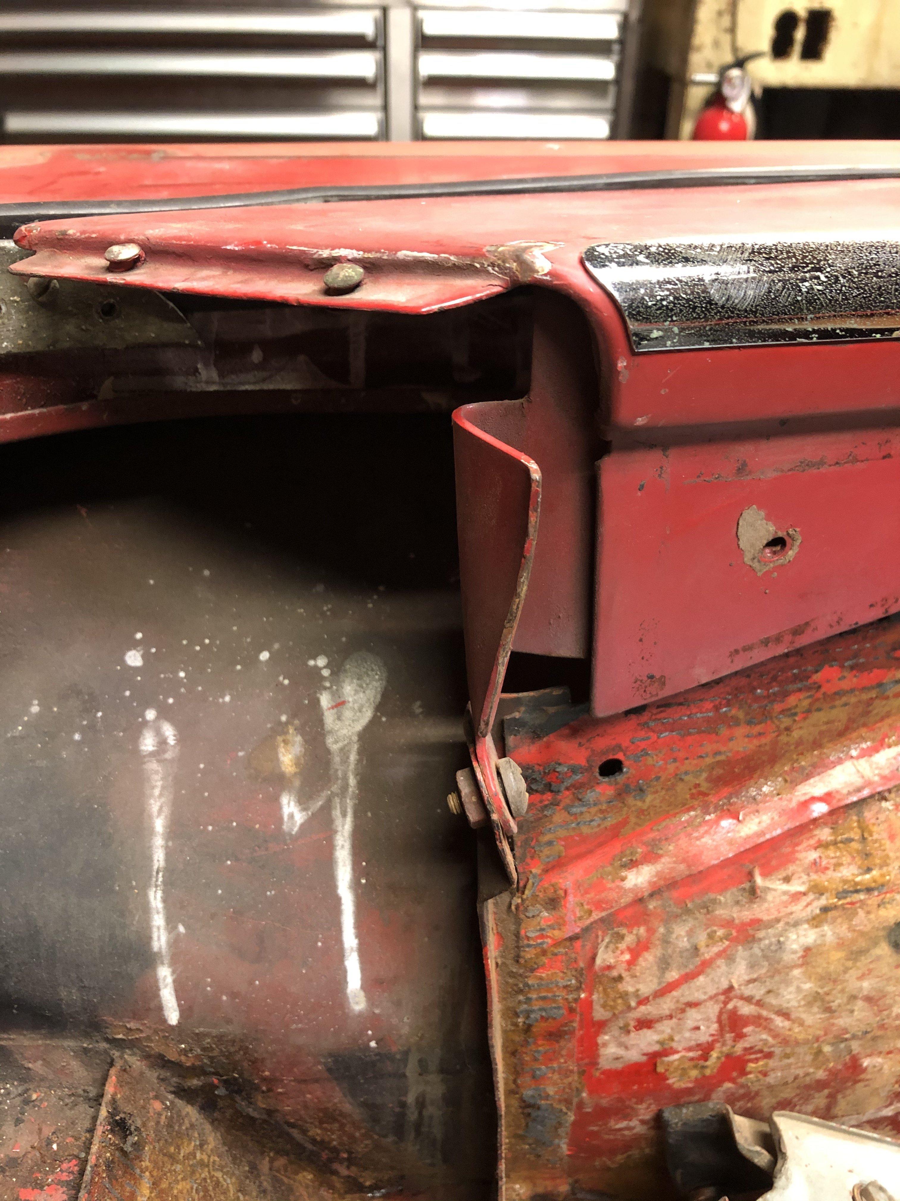

I've attached a couple of photos showing the side panels. Does anything look terribly out of whack here or par for the course?

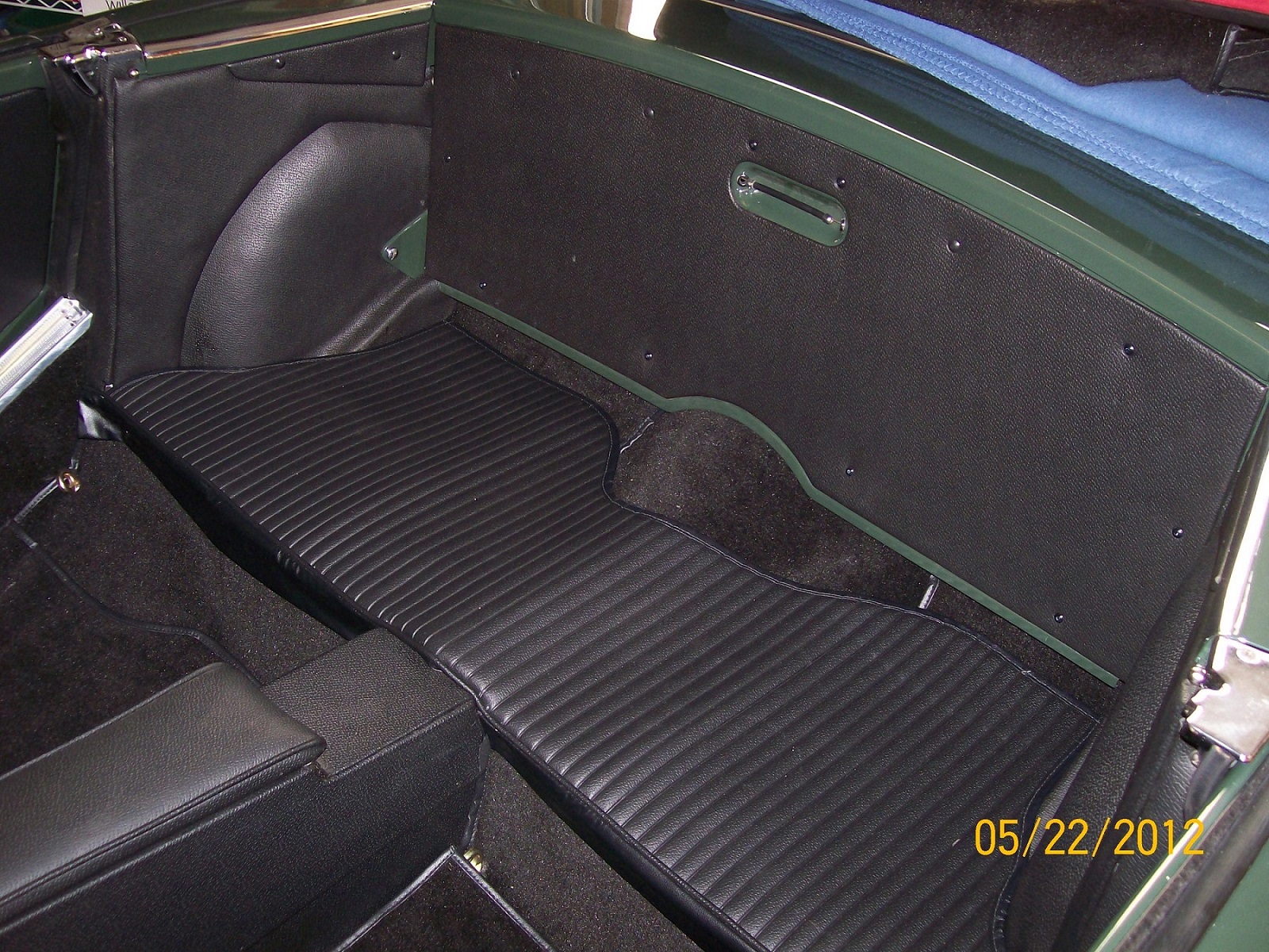

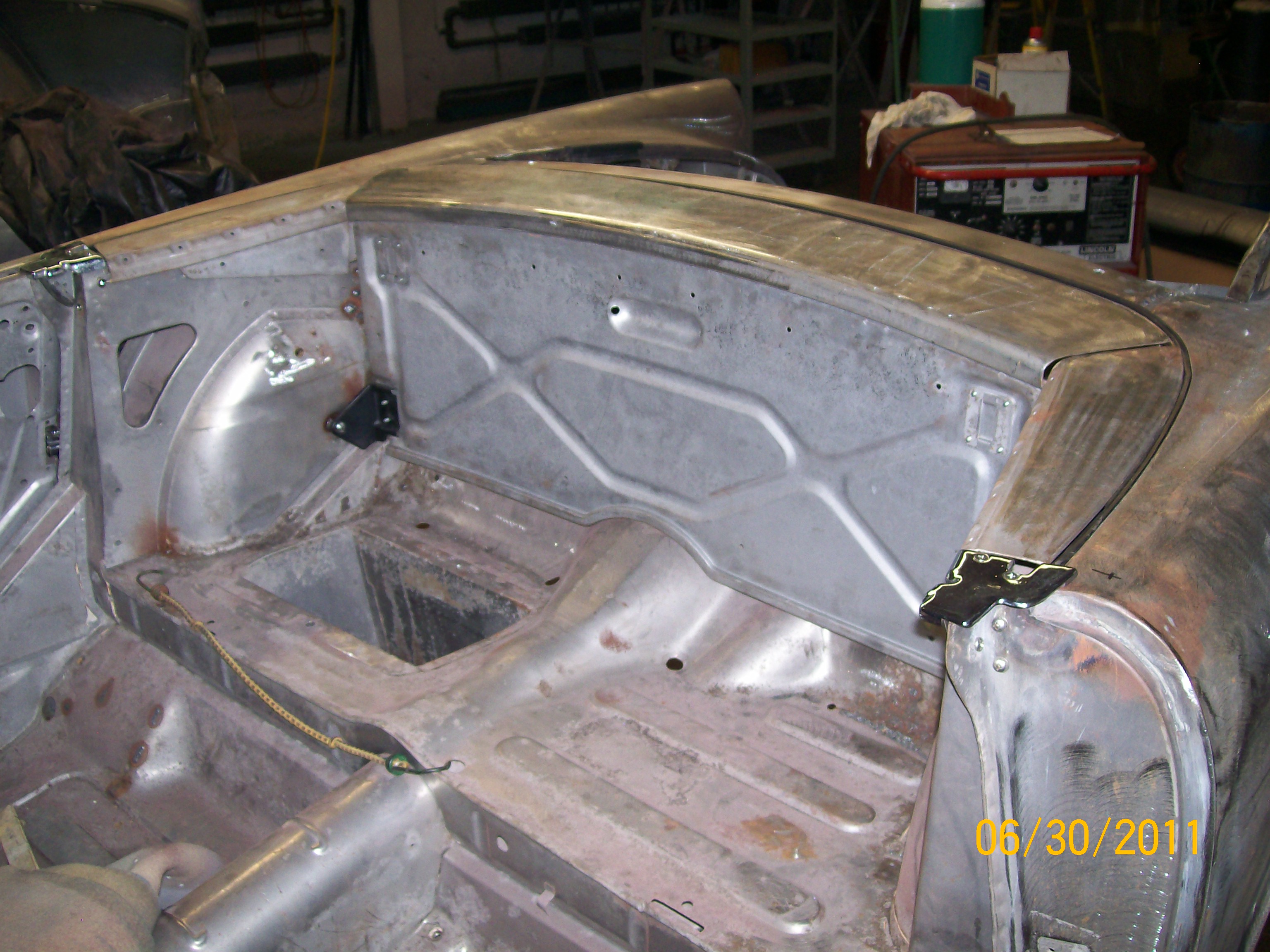

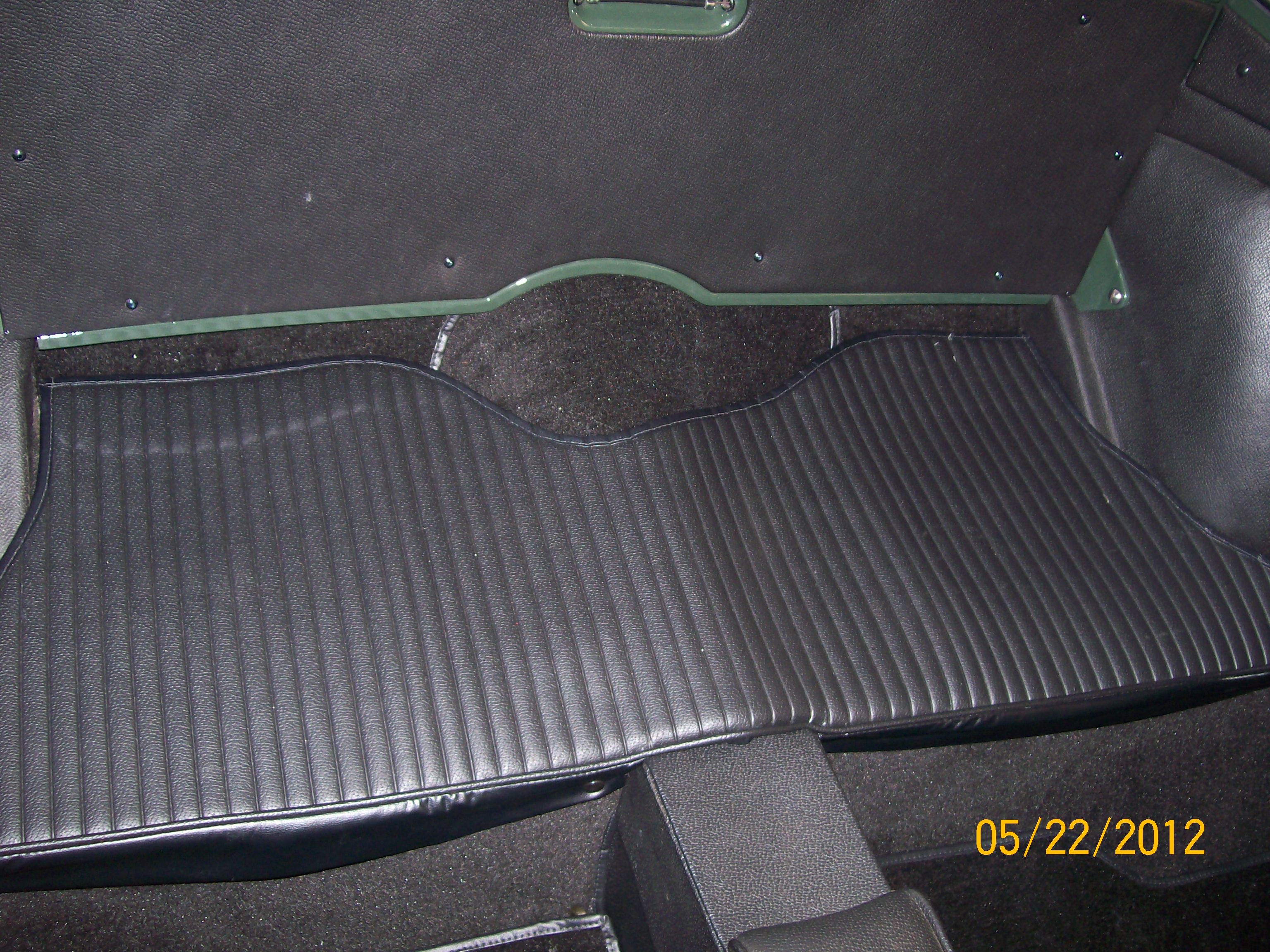

Before and after of one of my cars. Most of the bends to the large door occur to the sheet metal between the bracing.

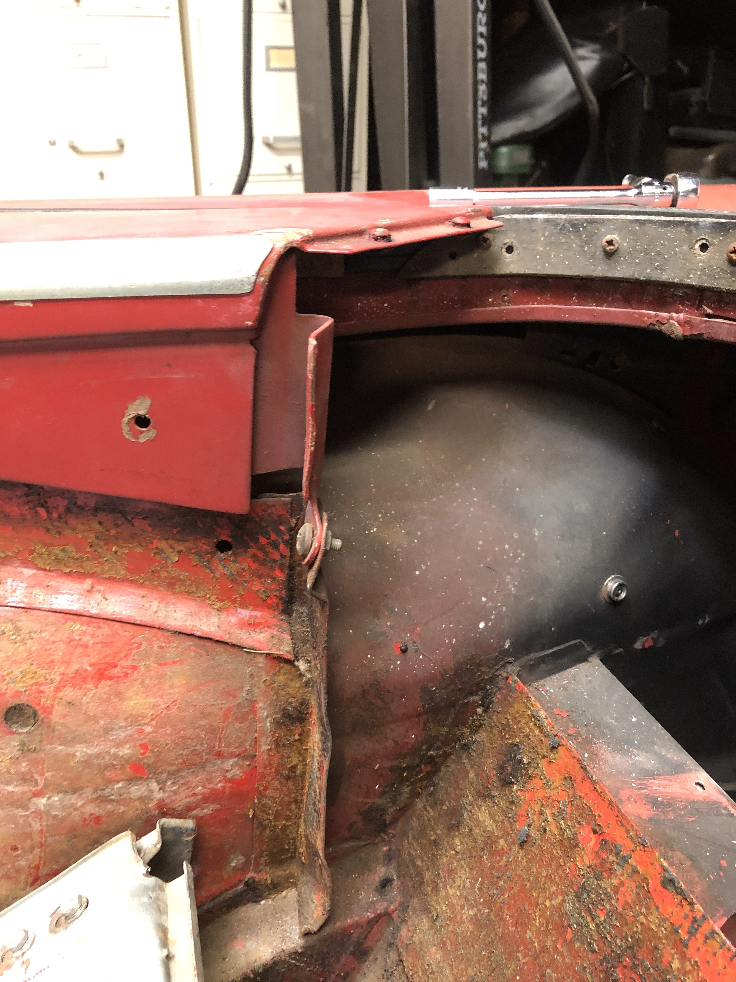

Here's a picture of the brackets.

Mission accomplished. It took quite a few of my weekend hours. The pivot brackets were bent so I adjusted to center the main panel. The edges of the side panels were way out of position but little by little brought back.
