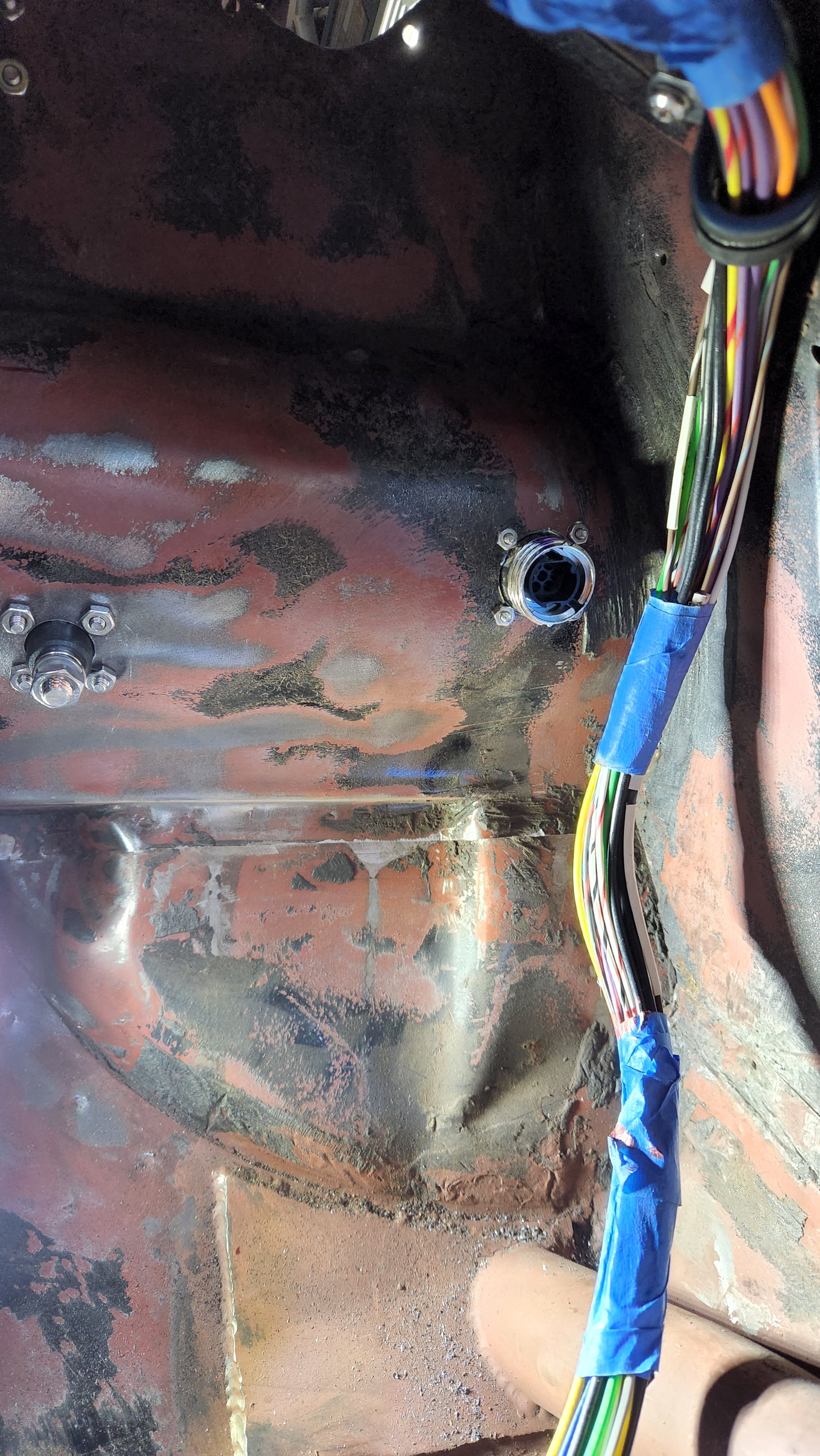

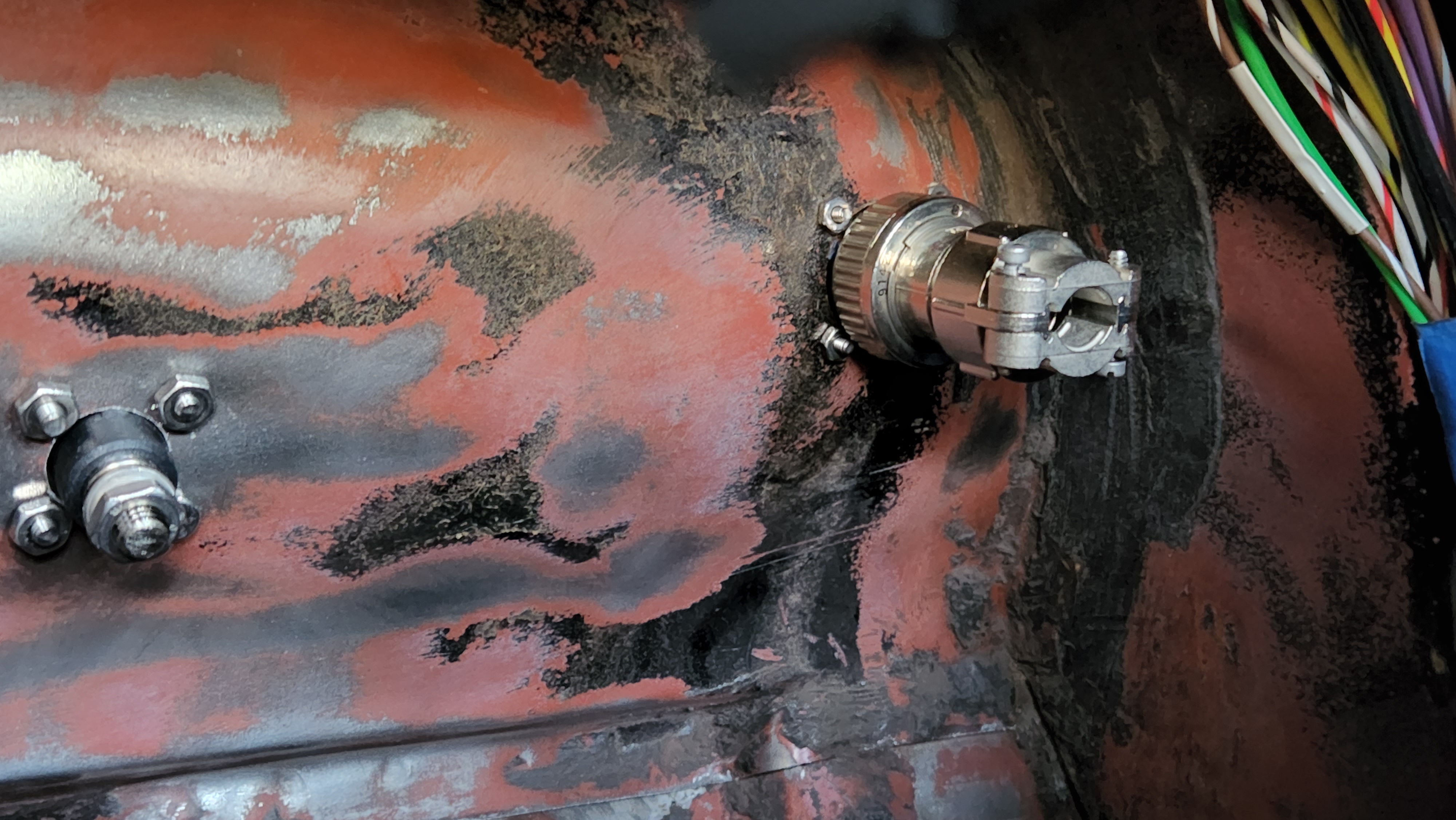

Got ambitious on the Tiger connectors. I needed a separate connector for the MSD coil wires as it's not a great idea to bundle with the rest of the harness wires and connectors.

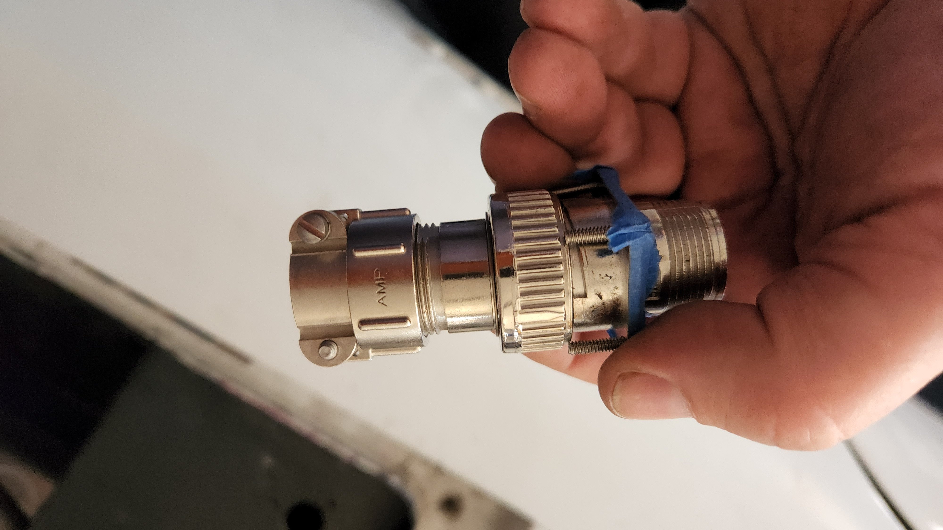

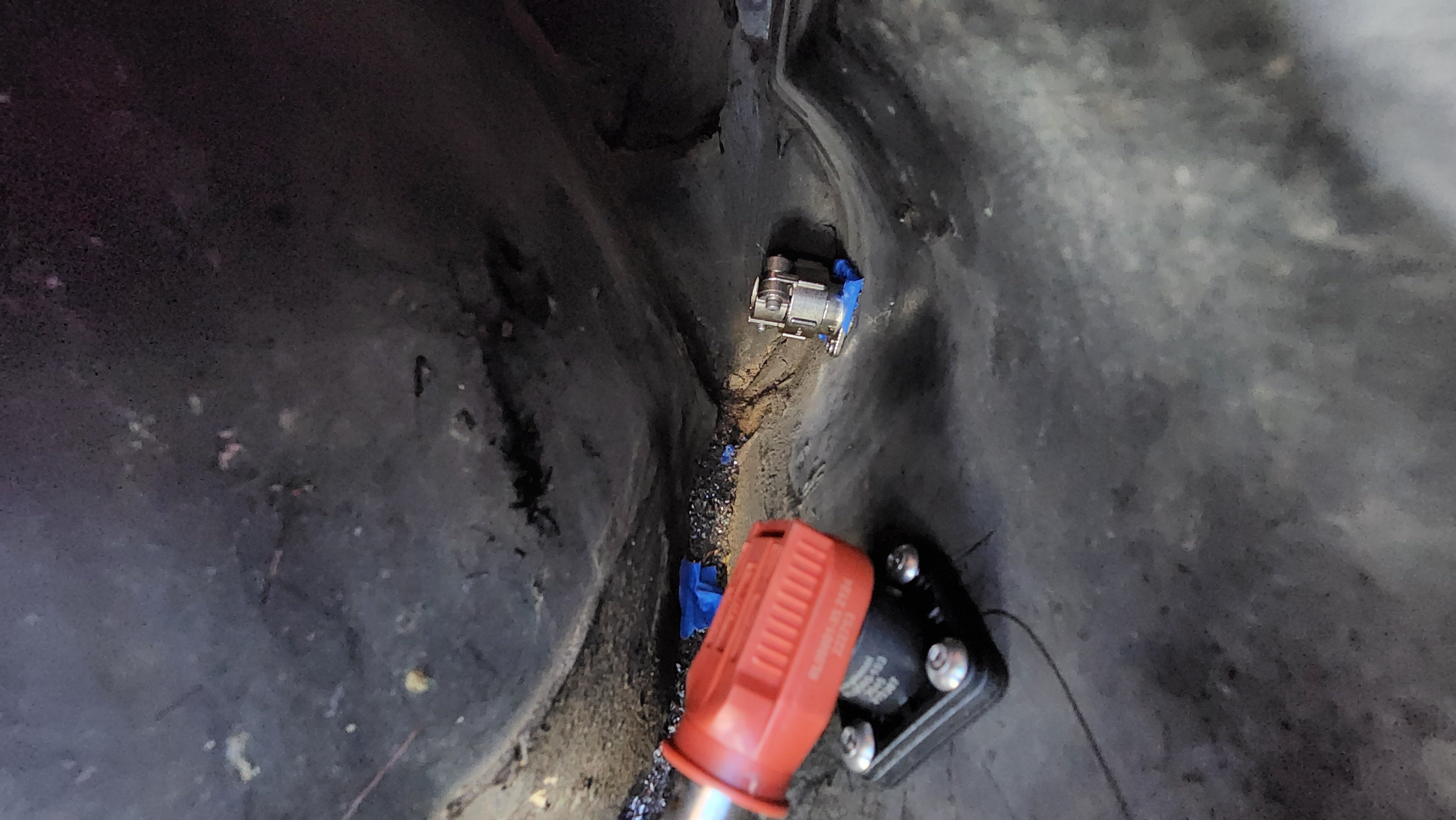

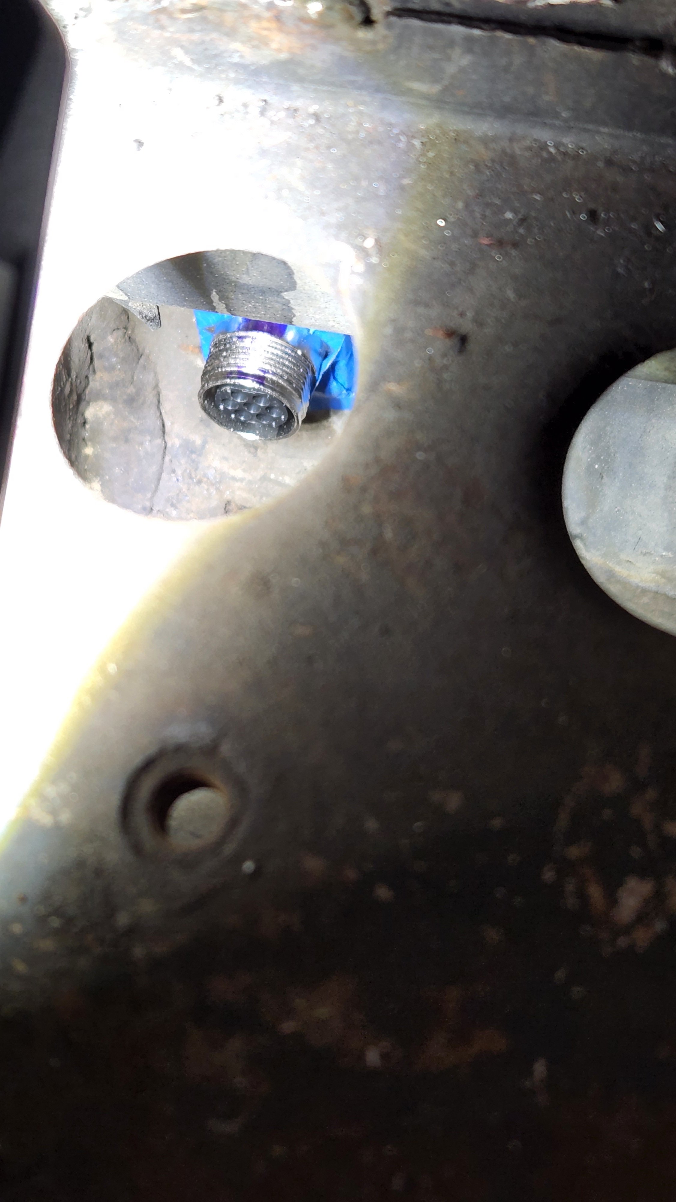

I was just going to use a grommet in one of the existing holes... but no, I found a AMP cpc that fits perfectly. Down side is, like everything in the Tiger, it's difficult to get to it.

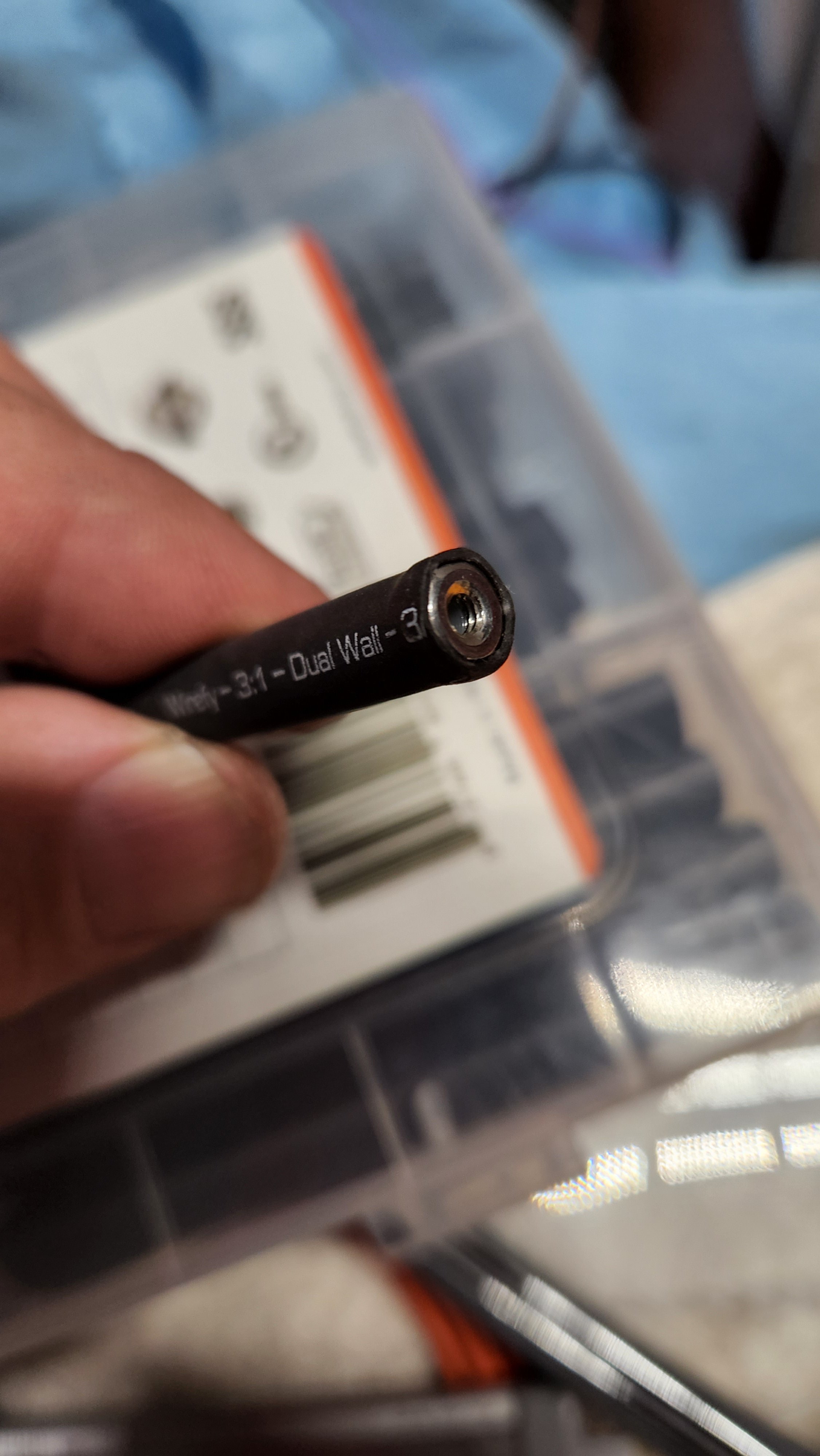

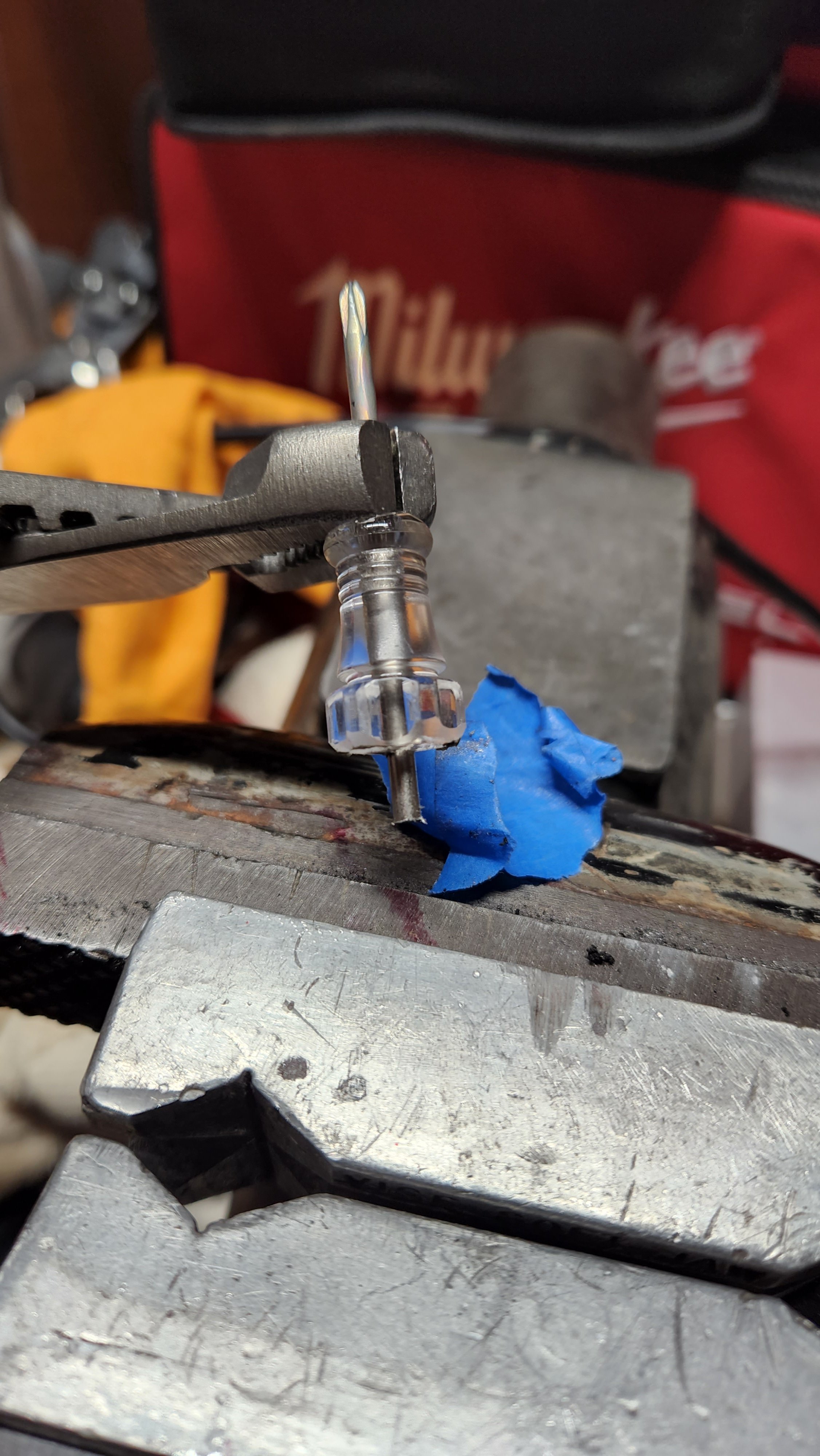

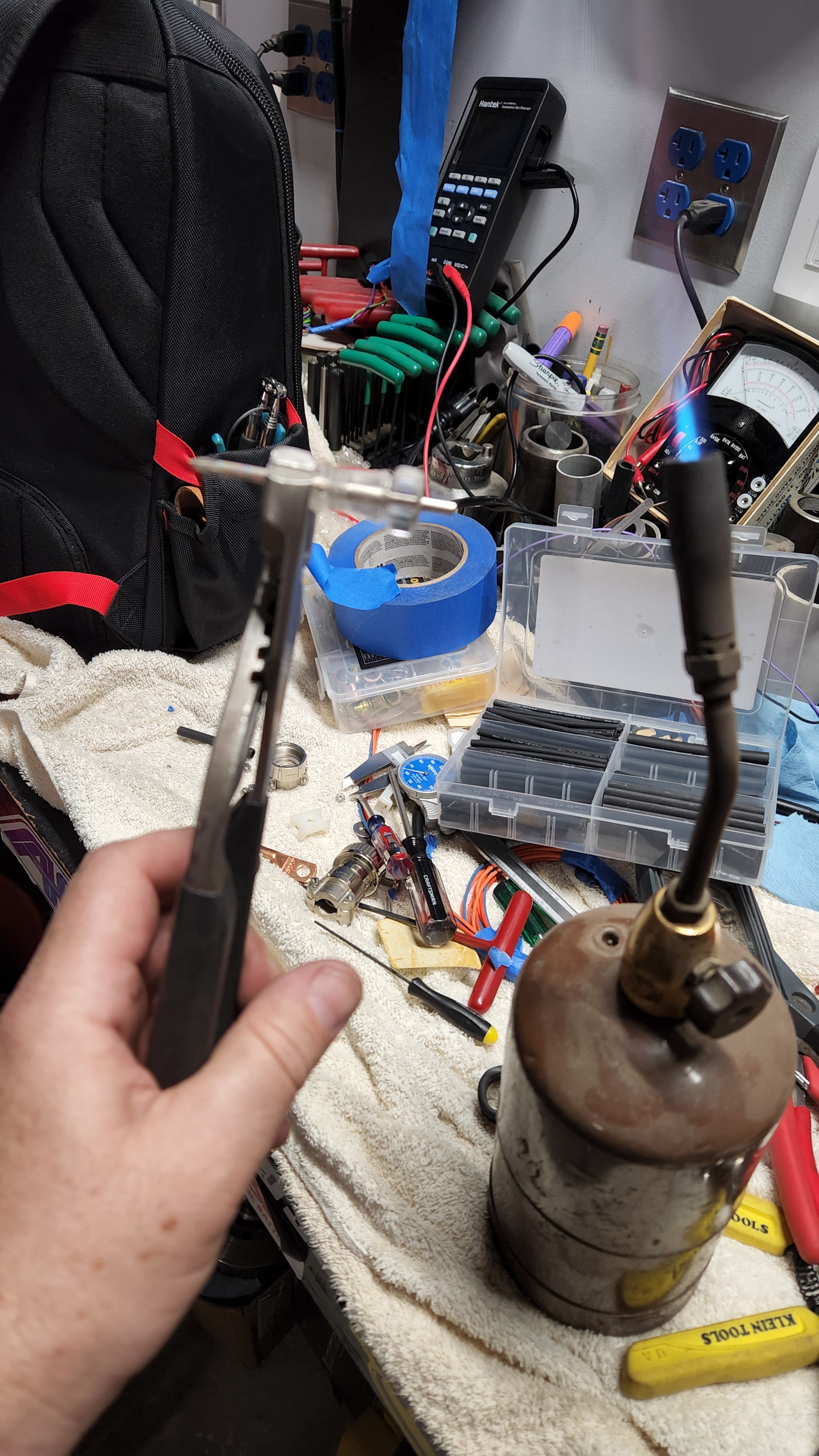

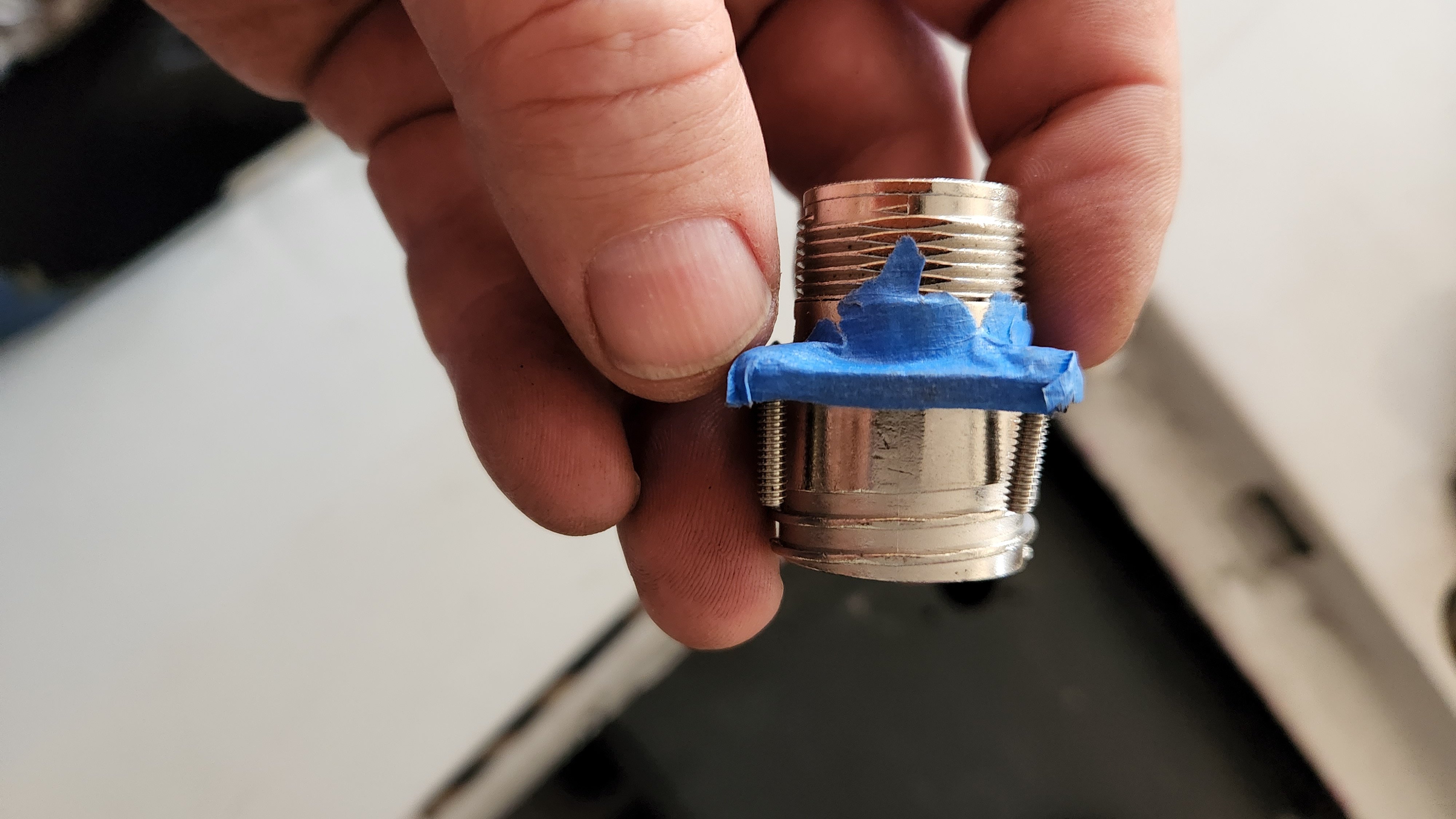

Had to make some tools and Jerry rig a piece of heat shrink tubing to get the tiny 4-40 nuts installed.
