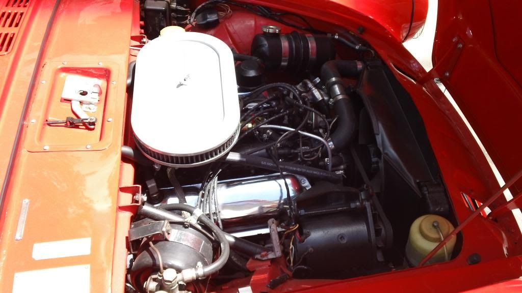

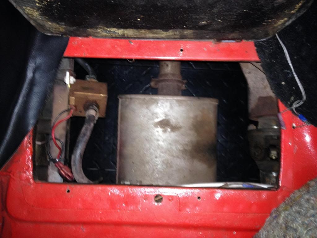

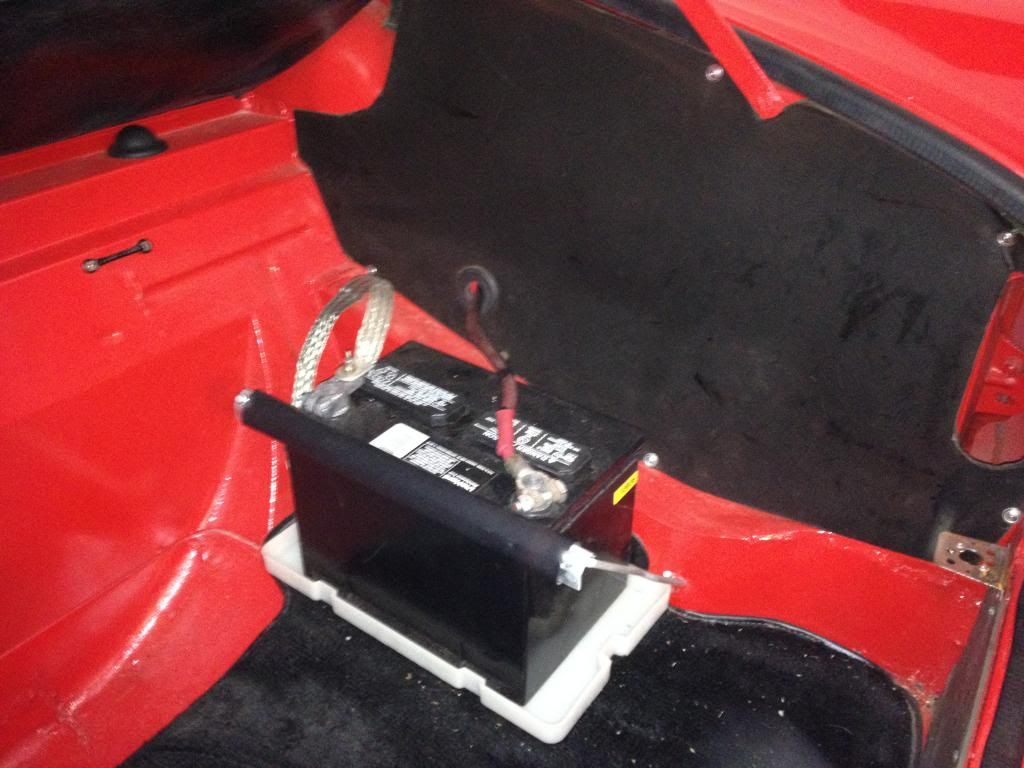

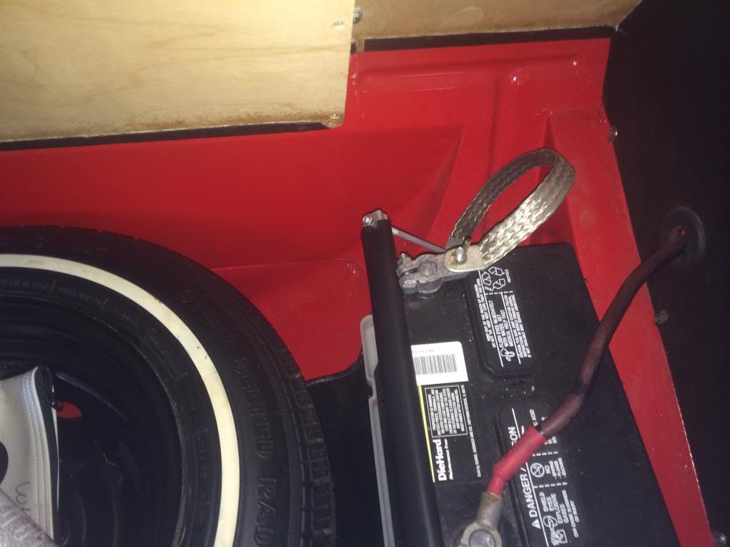

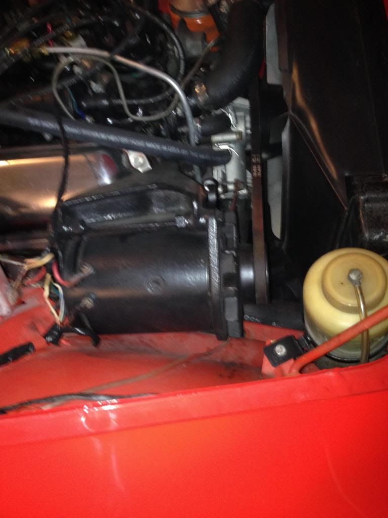

This is my first post and I have been looking for Sunbeam Tiger. While Algers can be great cars, I am looking for a tiger that is as close to being original or like original as possible i.e. if the car came with a 260 would still want a 260 etc. I have been in touch with a collector who happens to be selling his and he has been nice enough to send me some pics of certain areas of the car. Keep in mind that I have just enough knowledge to be dangerous and would like some of the Tiger brain trust to look at some pics and tell me if there would be any reason to pass on this car. I believe the seller is truthful and has been more than helpful. Unfortunately, the car is out of state and it would be difficult to actually go see the car. The vin is listed on rootes1 site which is good. The fuel pump has been swapped out but is located in the cubby behind the passenger seat. Because it has been modified I get concerned. May not be anything to worry about but that's why I'm asking you guys. The other area of concern is the boot. I see no vent tube or hole for the fuel pump. Again this may be because the original fuel pump has been changed out. What do you think. Here are the links to the pics. By the way it is a 1965 MK1.

That is not the original style fuel pump but under that lid is the correct location for the pump for all Mk1 and Mk1a tigers. Going back to stock is not a difficult task. Hardest thing will be finding or making the metal bracket that the pump was mounted to.
The vent hole was probably bondoed over during the repaint.

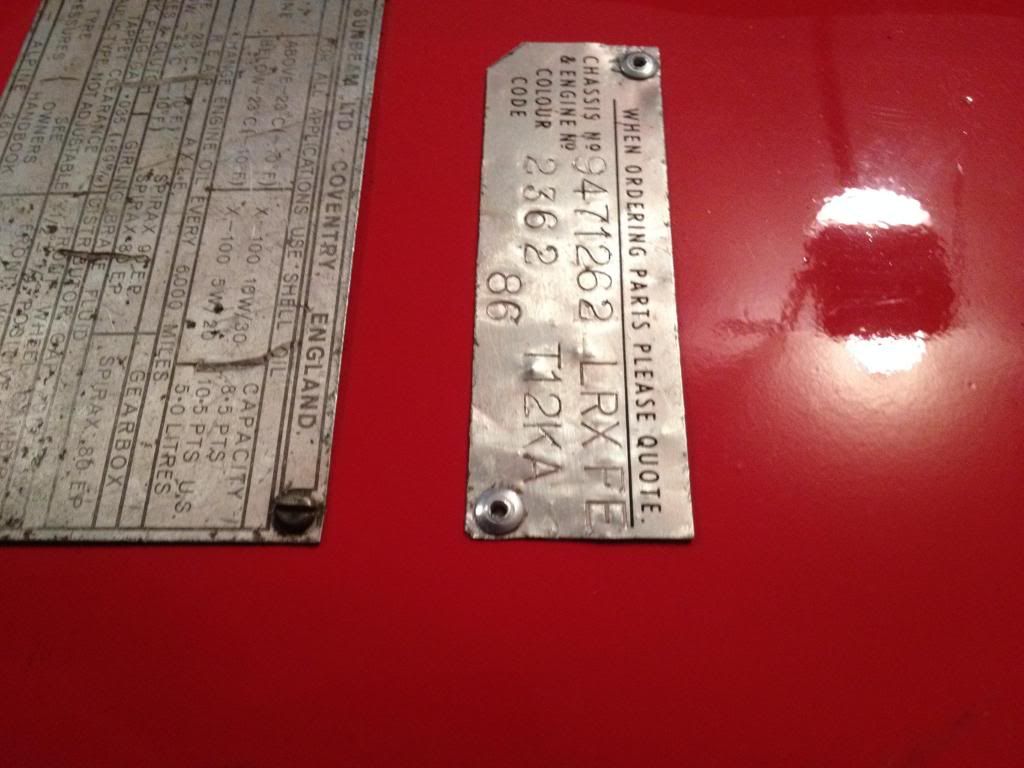

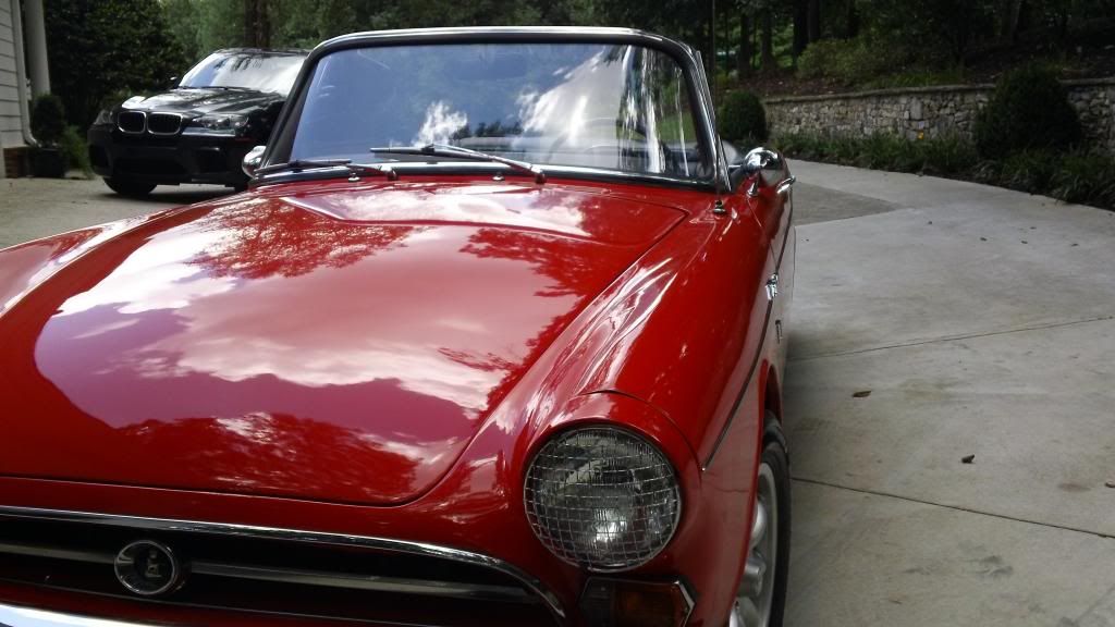

Thanks Guys! The vin B9471262lrxfe and JAL 560838. The car appears to be in pretty good shape. The person I may buy it from has had the car about 5 years and purchased it already restored. The owner has been very forthcoming sending me paperwork on some of things that he has done. I asked about the use of filler and also asked if he would take a magnet and check some of the areas that are prone to rust. Owning two triumphs (tr250 and a TR4A) I also understand that body work is probably the biggest wallet sink hole there can be on these cars. He is asking 58500 for it but I may try to dicker a little if I decide to go for it. there are a couple of areas that look like the bonnet or boot may have been misaligned and chipped the paint. Does not appear to be filler involved. Panels to me look reasonably straight. Here are some more pics. let me know if a go or no go. I would eventually like to try to get itTAC'd as I live right next door in Arizona if I decide to purchase it. Are the JAL plates riveted or screwed in? this one is screwed in.

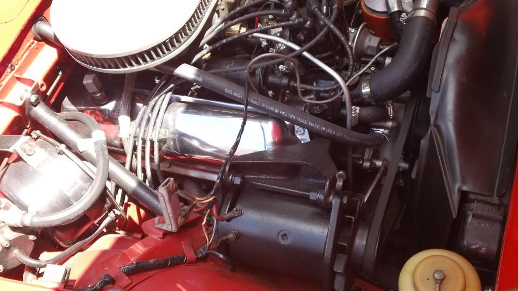

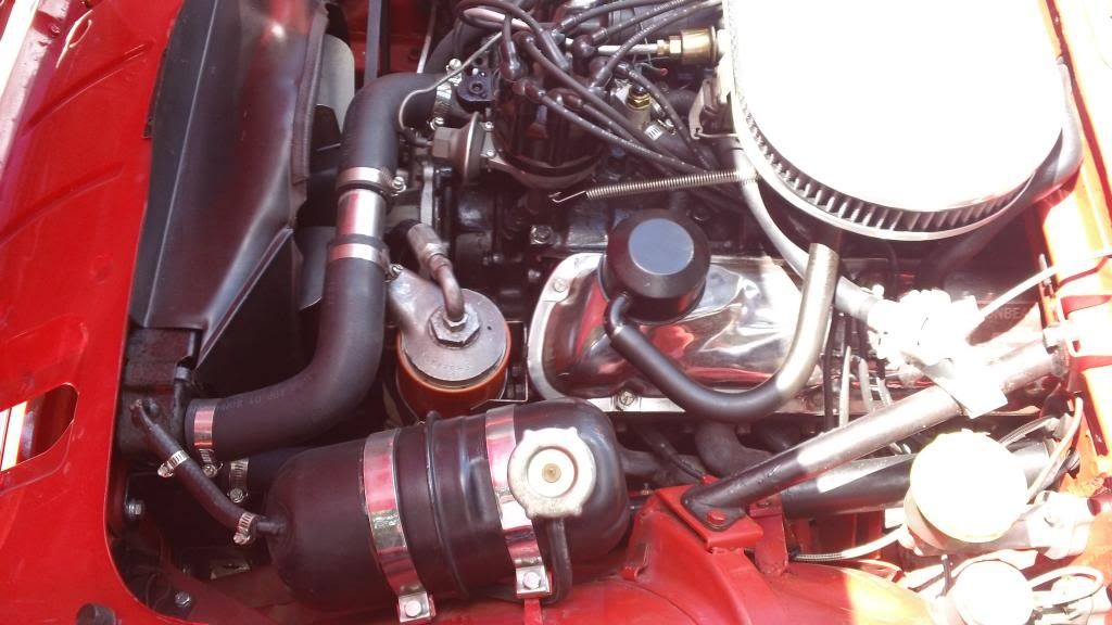

DANGER!!!!! Engine compartment pic. The fender brace towers are not correct! Need a much better pic of both of them. Huge red flag. Sorry....$50K saved.

The Jal plate is held on with screws, they would place the keys under the plate for shipping to dealers. It looks as if the vin plate was removed for painting which raises questions.....
With that little dinky fuel pump you won't have to worry about going to fast !!!
here are a couple of pics of the fender braces.

Is it just my poor eyesight or is that fuel pump bolted onto the leaf spring?
I'm with Duke on this one. Red flag area in the engine compartment. Possible severe damage history, nose replacement with Alpine metal, but, those are not Tiger inner fender braces (hats). :confused:
i'd think at least heavy accident repair.. look at the front left (drivers side) fit of the bonnet..
The headlight rim on the drivers side is on at a very off angle.. wonder if damaged clips or mounting location?
The lack of holes in the boot (trunk) also rings bells.. the car is being offered at a high price... for that it would wan tto be real.. and not need sorting in terms of panel work. just my .02
