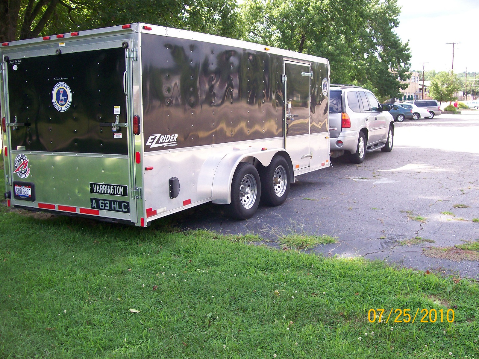

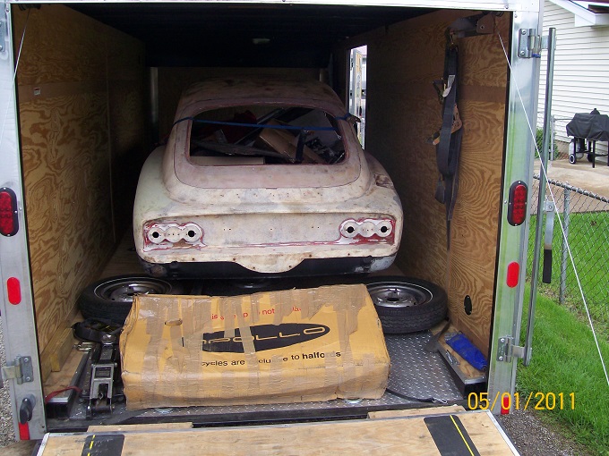

My closed trailer is 16 ' inside length and 7' between the walls. I have a winch mounted to the floor near the nose with wiring going under the floor and along the tongue. I have a connector on the wiring harness that is actually the connector unit used on battery operated fork lifts and it connects to the same type of connector which is fastened to the my hitch under the SUV. These connectors are stocked at NAPA stores. The wiring for this connector runs thru the frame rails to the main fuse box in the engine compartment and has a 50 amp fuse. I use the winch to load the Beams in the trailer and use the cable and one wheel strap to tie down the front and have rings welded to the plate under the rear springs on all 7 Beams to fasten the rear straps to the D rings in the floor. The only Beam that takes up most of the trailer space is my 69 GT fastback. The other six Beams being regular Alpines take up less space but we walk up the side and set the parking brake and put the trans in first gear. My other trailer is a full deck 16' with 7' between the fenders. The fenders allow me to open the doors with no problems. I have a wench mounted to the floor for loading non running cars. Here's a photo of my closed trailer and my open trailer. I also have a winch on the flat bed and had to use the winch to load the Harrington when I picked it up at Doug's a couple weeks ago because it doesn't have an engine / trans yet.

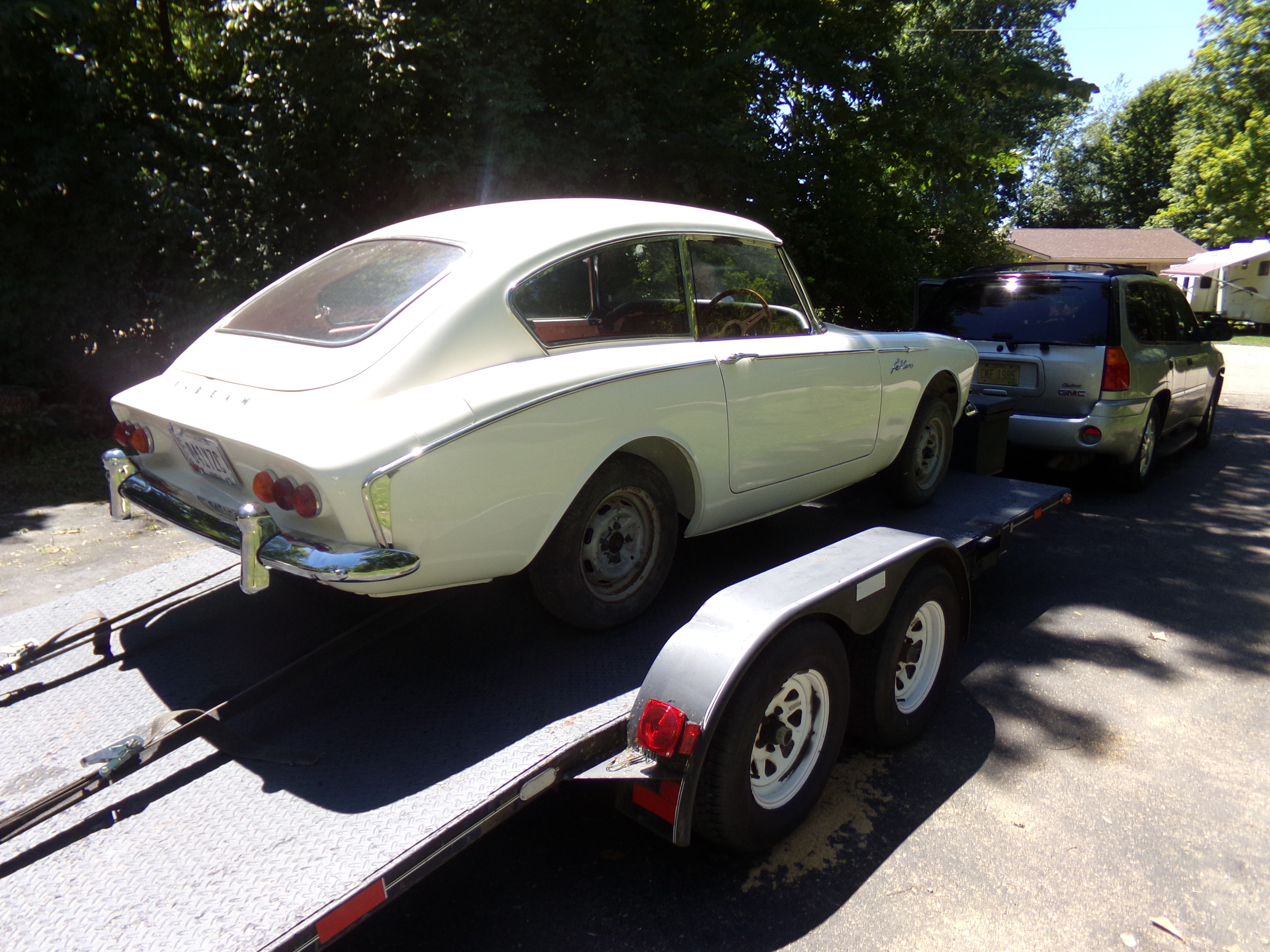

A photo of the white Harrington when I arrived home after picking it up at Bill's house in Reno. Plenty of space.
