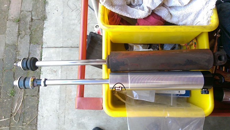

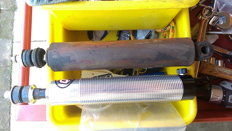

I ordered some QA1 Rear shocks for the 9" swap (axle is in the car!). They make a very close sized coil over that has very close to the same dimensions as the Koni's that I removed from the stock rear.
Koni travel as measured from center of eyelet to top of the bottom mounting rubber (the bottom of the car side).
Koni's
Extended - 19.75"
Compressed - 12.5"
QA1 DS701 (Single Adjustable) DD701 (Double Adjustable)
Extended - 19.5"
Compressed - 13"
These particular shocks are threaded body coil over style with rod end or bushing style ends. They do require SS100SD top, that replaces the rod end on the top and makes the shock have the same attaching method as the stock shock. Bottom for my application will be a 1/2" mount bolt.
They do seem to have shocks that match the same size, smooth body and with the correct attaching ends but you will have to call or poke around the QA1 site to see them (hint Mustang Cobra rears).
Here are new and old...
