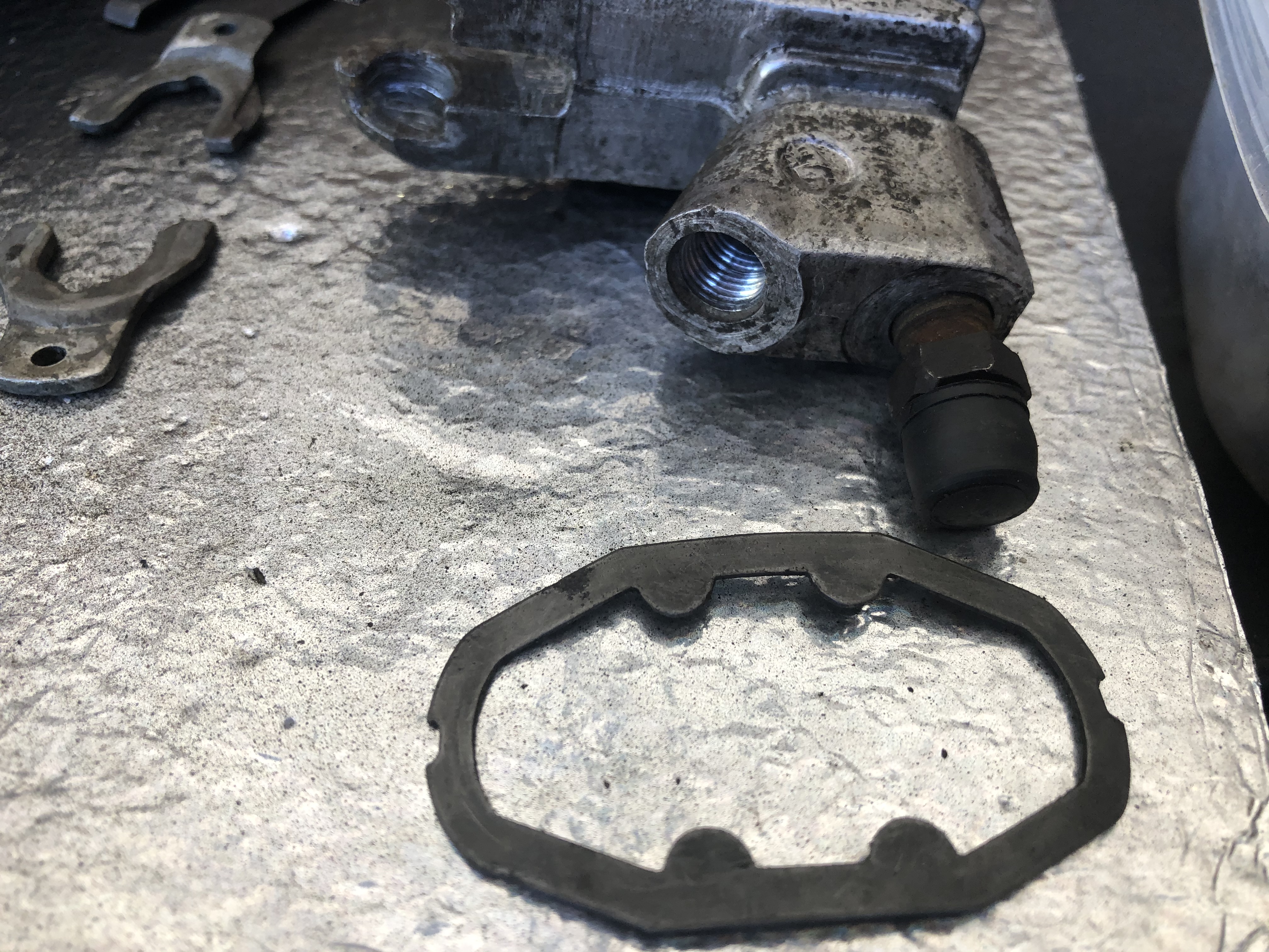

Your best bet it to contact someone with lots of Alpine parts. These were used on all series 3 and 4 cars as well as they very last of the series 5 cars after the factory ditched the self adjusting wheel cylinders.View attachment 15628anyone have a spare one of this rear brake cylinder clip. It needs to be exactly like this original one pm me thanks
I had a hell of a time finding the clips! If the brake back plate is modified to remove the bit that the rear wheel cylinder rubber boots fits over, then the series 1/2 Alpine clips will work... Which are the same as TR4-6 and Big Healey... You can then use the rear wheel cylinder rubber boot from either of those applications.I had some on an Alpine that had a automatic transmission rear end that I gave away I told the guy he could have it if he mailed me the clips and the brake drums still waiting...
