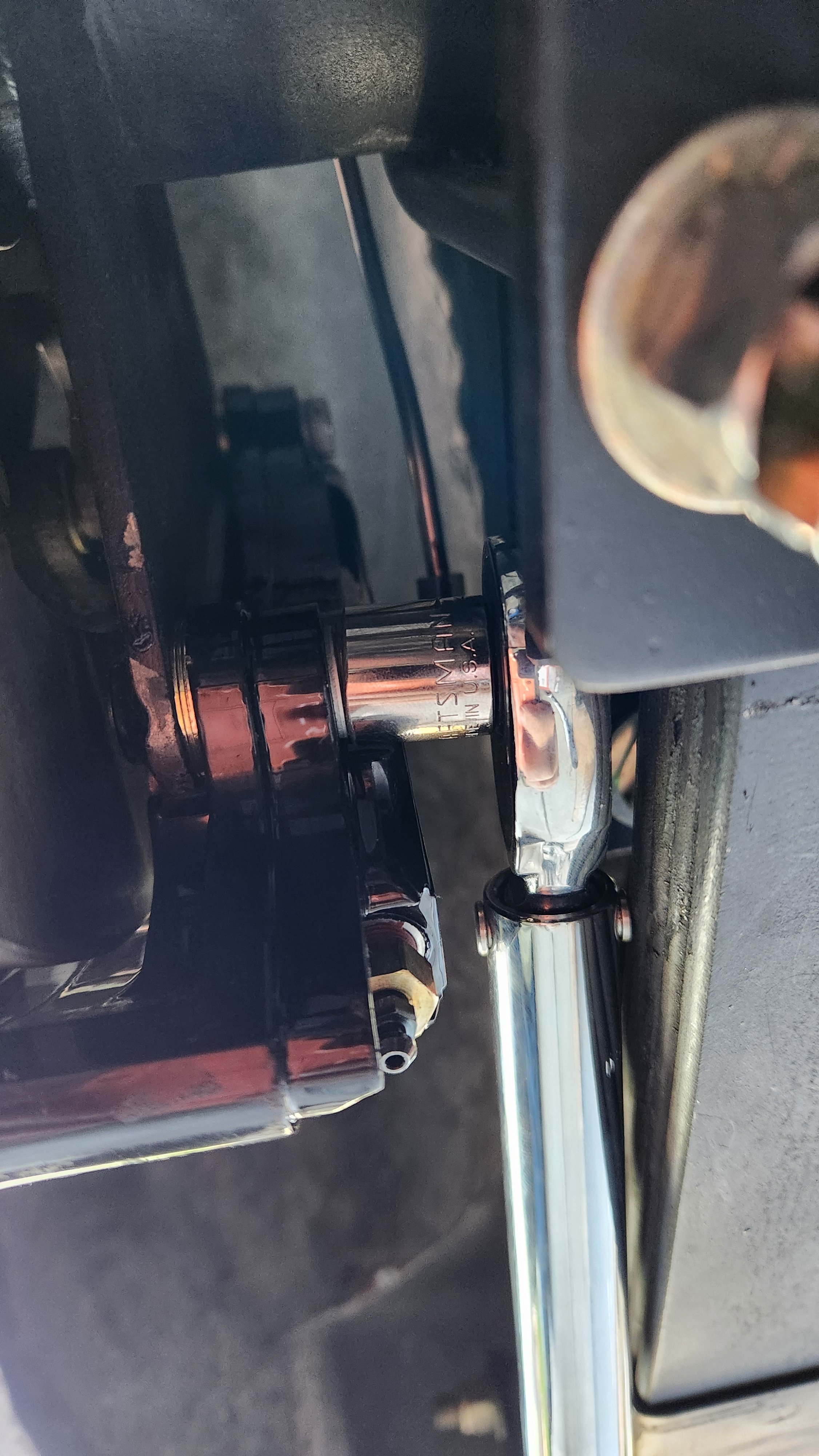

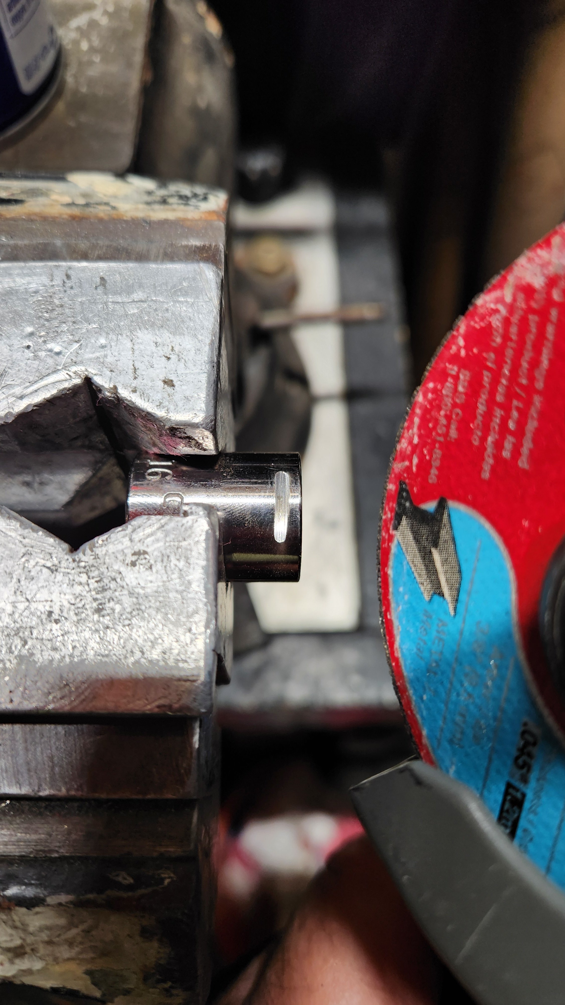

Added and removed shims between the caliper to get is centered up, then had to deal with chopping a socket to get the torque wrench on the bolt. All good until the safety wire job. Not my best but will keep the bolts from falling out.
Just not a lot of room on the passenger side with the Panhard bracket. Got it done in any case. Hope the driver side goes easy, but you know how things go on the Tiger

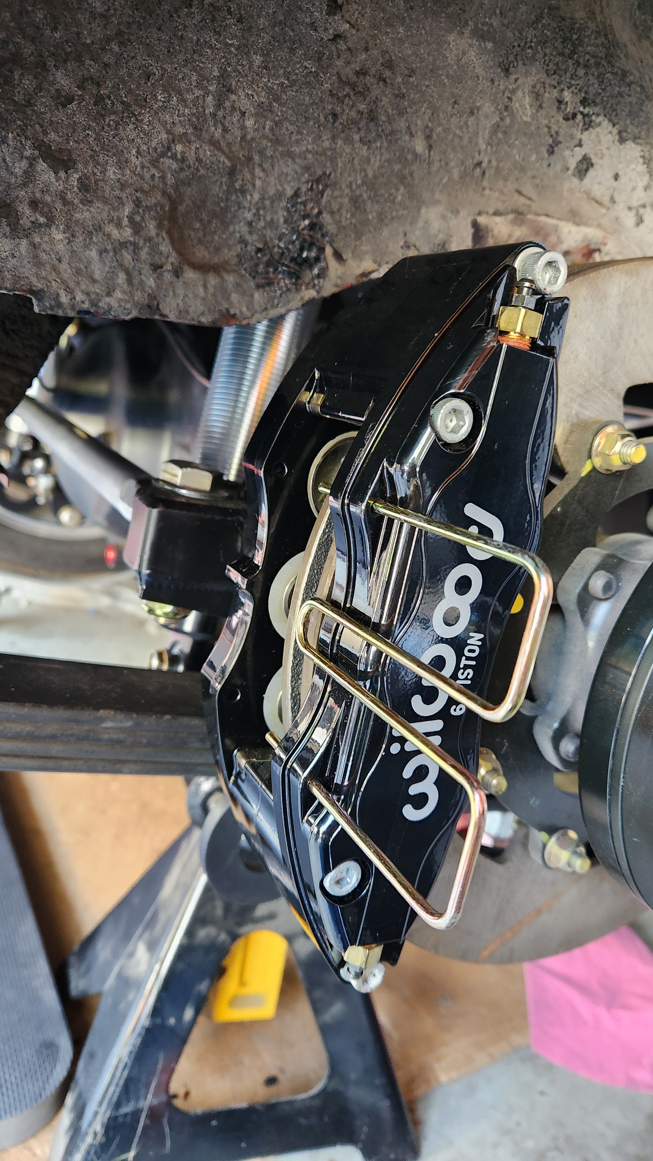

One thing I really like is this style of Wilwood caliper needs no tools, cotter pins, or odd circle clips to get pads in and out.

Nice and easy clip to get to pads!

Custom made 'shorty' socket to be able to squeeze the torque wrench in on the lower bolt which is close to the leaf spring
Just short enough to get the bolt head in the socket and yet fit the tight space, original size vs. shorty
