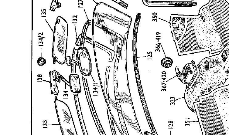

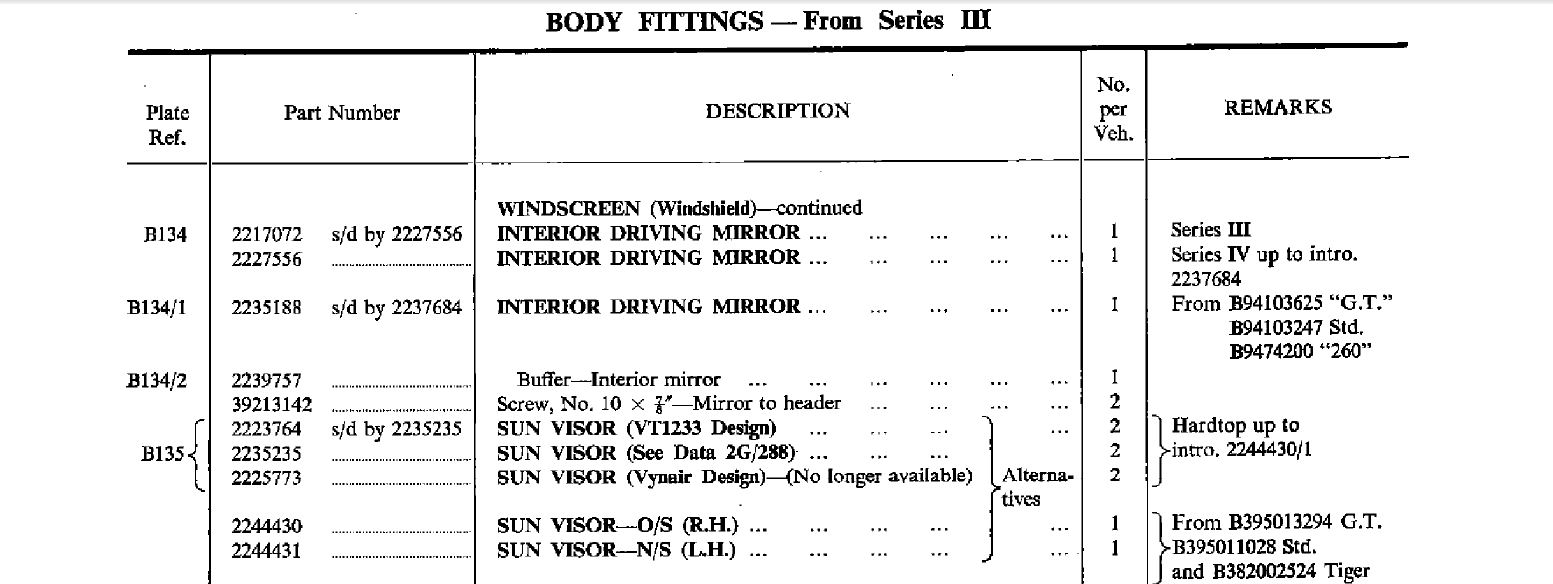

From the Rootes Alpine Parts List, it would appear that Tigers made the switch from the small rear view mirror to the large rear view mirror starting with B9474200. In other words, the switch was made before the start of the Mk IA Tigers. One of the JPGs is a shot of part of Plate B - Section YX, where we can read the small mirror is labeled 134 and the large mirror is labeled 134/1. The other JPG shows these two mirrors (and part numbers) in the parts list.
