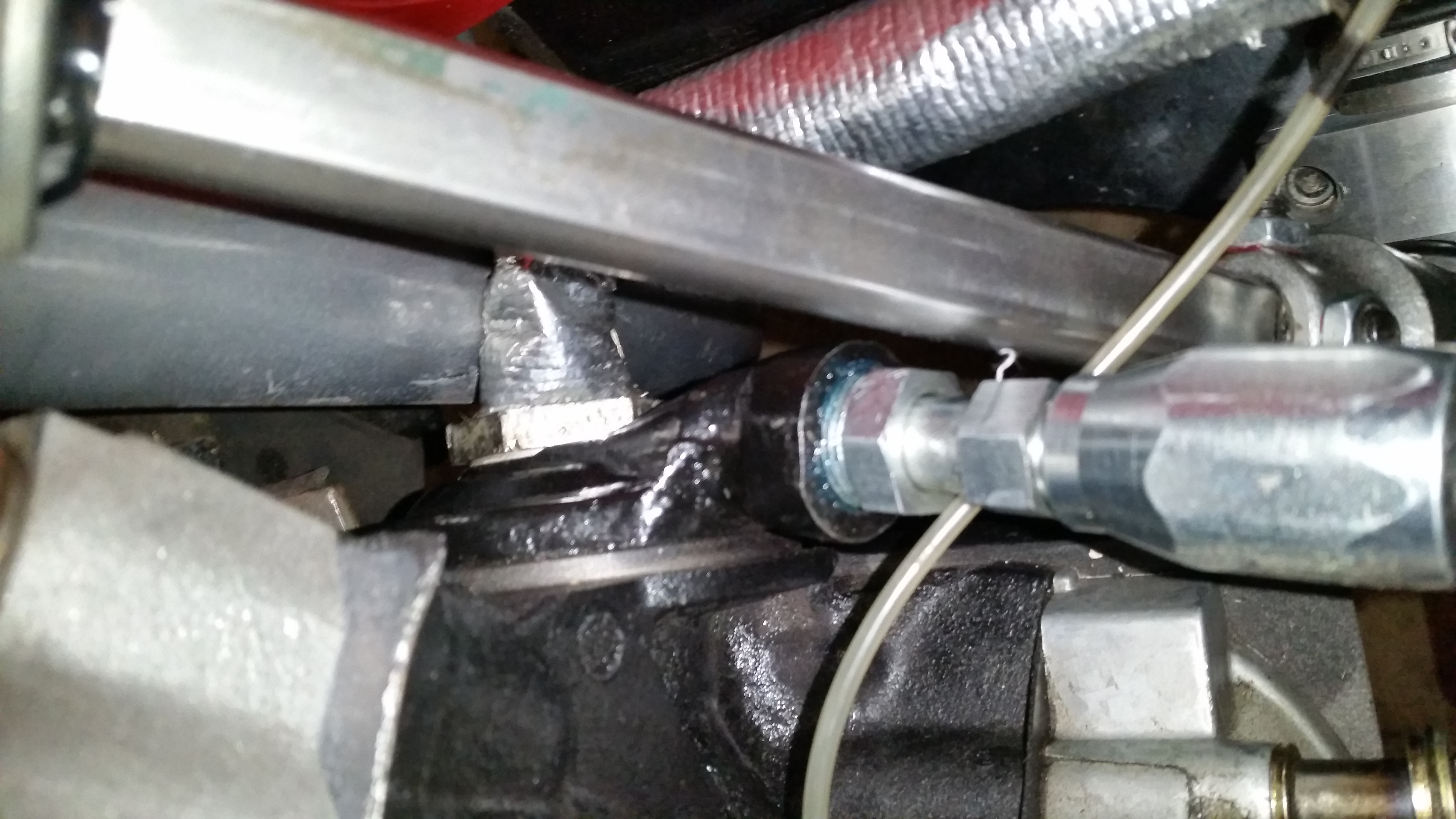

In haste while taking apart my car I failed to mark oil hoses that go to my remote filter adapter as IN and OUT. The car is back together but I'm second guessing whether I have the oil hoses going to the proper ports. Can anyone tell me which of these hoses coming off my block should go to the filter adapters IN PORT and or which should go to the OUT PORT. Messing this up could possibly damage the engine, not sure on that but taking no chances. Not trusting myself after many long days piecing it back together. Thanks!!!

Here is a screen shot of Plate D from Section AF of the Rootes Parts Supplement for the Tiger. I assume you have a Mk I or Mk IA and not a Mk II. This should answer your question about connecting the oil lines.
Good luck!

Thanks, you may have saved a fairly new engine from failure..Not really sure how messed up things would have become but I had them switched around. Keep in mind I have a Transdapt adapter that put the oil filter in the wheel well and unclutters the engine bay. It has an in and out port but the so a little different but the diagram shows me the way..
If you want to be sure you have it right before you fire it up, you can always do the drill motor through the distributor drive trick. 1/4" socket on a long extension taped all together and spin it counter clockwise.

As I remember it, I put my drill motor in reverse making it counter clockwise rotation. I suggest it so you could verify that you have you oil hose connections correct. You could find out which direction your oil filter flows and spin your oil pump with the filter off to make sure the oil flow direction is correct. If this is the first time firing up this engine, I would highly recommend using this or similar method to fill the oil galleys and give the bearings a head start and avoid a dry start as much as possible.

Keeping it Barnyard simple: The center goes to the center of the filter and the side goes to the side. Don't over thunk it like engineers do. Amen.
