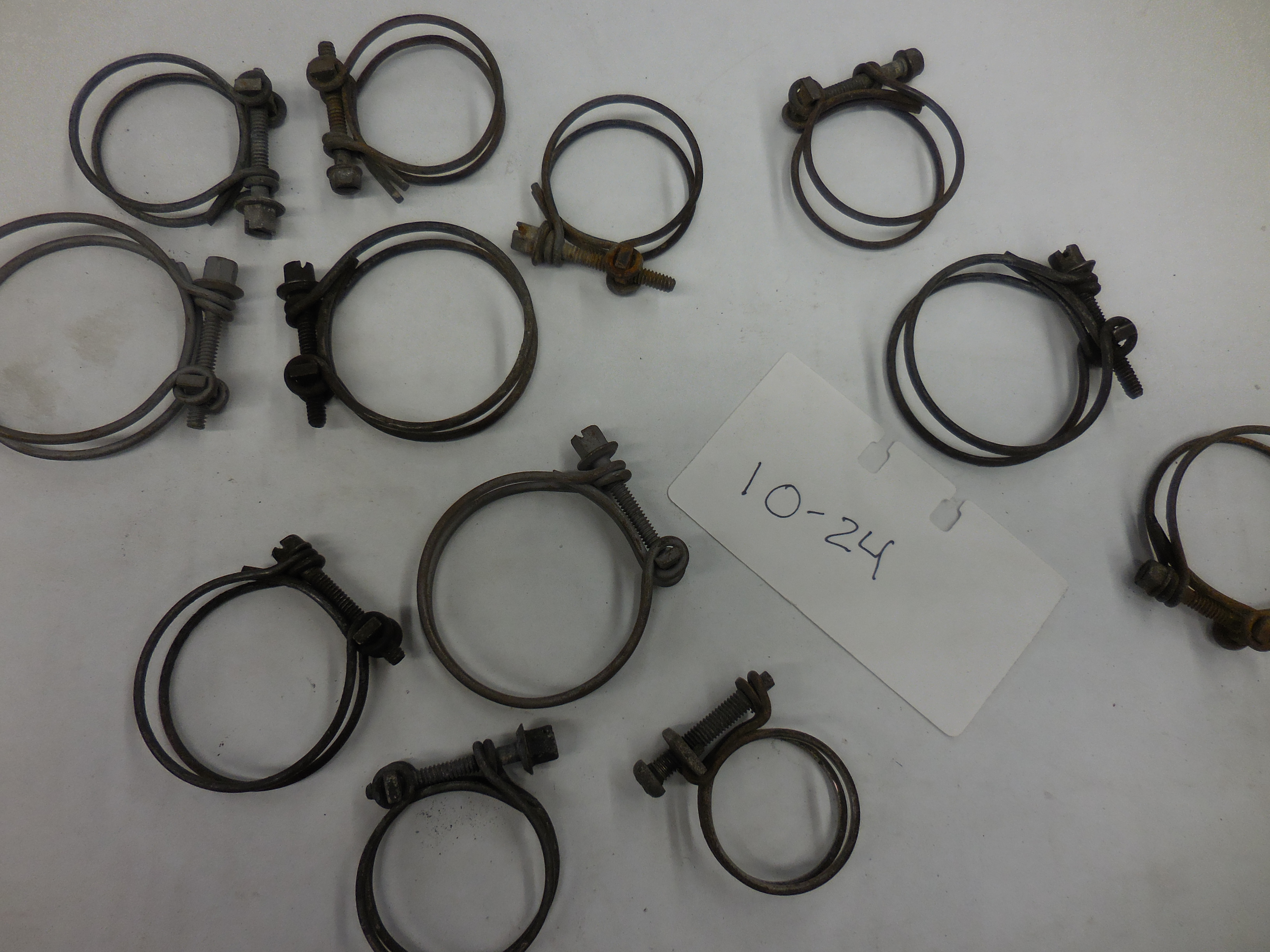

Screw Driver and Hose Clamp from some Rootes car(?). I do not think they came off a Tiger. Would appreciate some clarification.
Thanks Steven Alcala
Steve, I don't think the screwdriver is correct for a Tiger. See my piece on tool kits.
Rootes parts catalogues had the same PN for the screwdriver in catalogues for both cars. PN P.79758. There is no specified outside vendor PN specified one either list. Without specific proof, it appears that Rootes Group purchasing obtained lots of wood handle screwdrivers to assemble tool kits for their vehicles. I have a couple of them one I am looking at now is a Colonel by the Sheffield Company in England. Size would be to fit into the plastic tool roll supplied with each car.
Regarding wire clamps, Rootes used them on most if not all of their cars, once again looking in the Alpine Parts Manual shows mostly wire clamps except for the Series I and II Alpine shows a small worm clamp under the expansion box. I am sure there are many opinions and data on this most cars when repaired had their clamps replaced with the 'newer' worm type. Other people should weigh in on this for accurate restoration purposes.

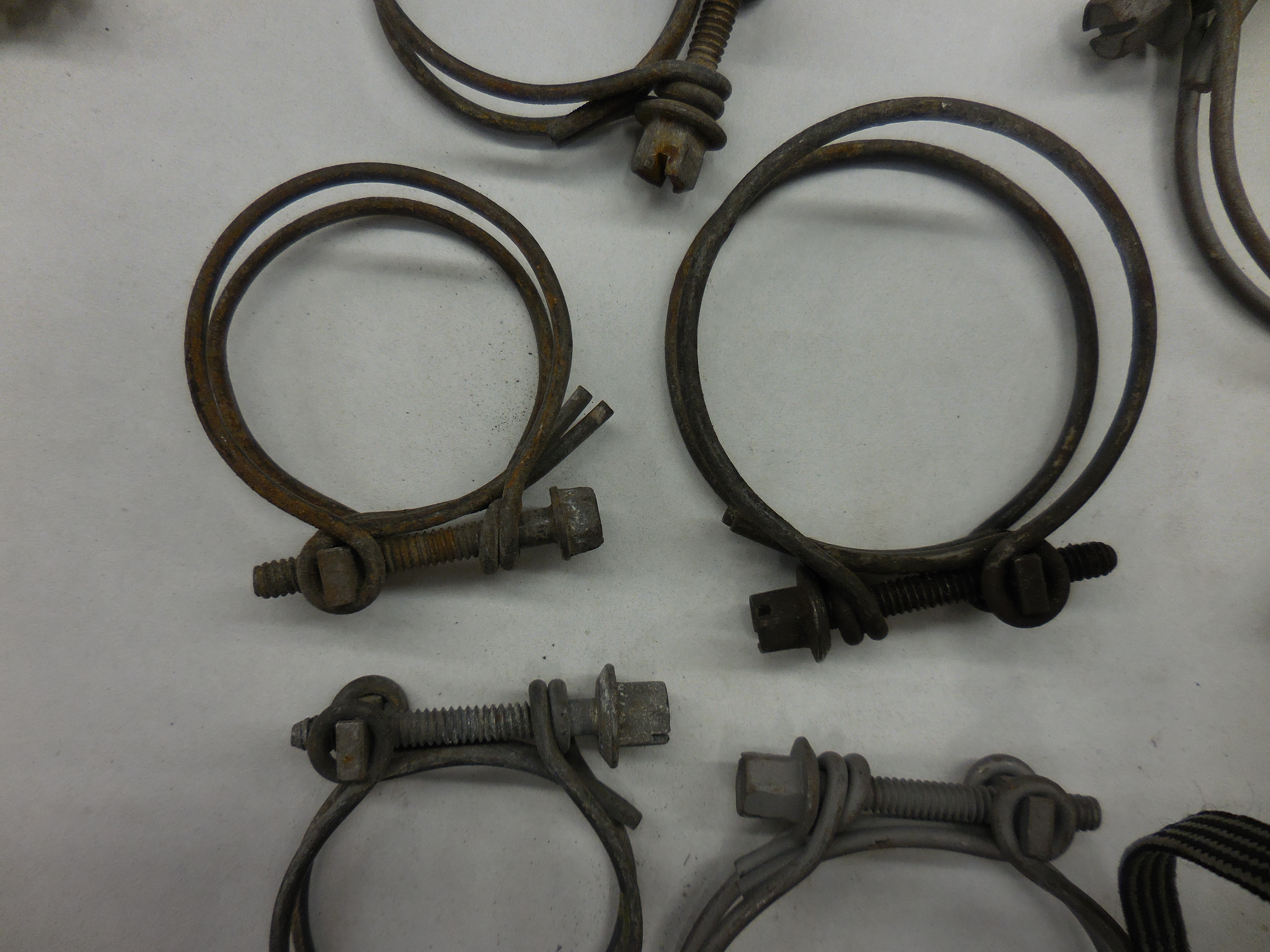

As far as the double wire hose clamps go, the fastener should be a round head, slotted machine screw. Not a hex head. All of it cad plated. This is what’s on many restored cars duplicating what was originally used.

Having a hex head wire clamp would have been REALLY helpful when I put the fuel tank crossover pipe back in. I used my mechanic father-in-law's old 2 1/2 foot long screwdriver which I thought was pretty useless, until I needed it to tighten those original slotted round head clamps.
